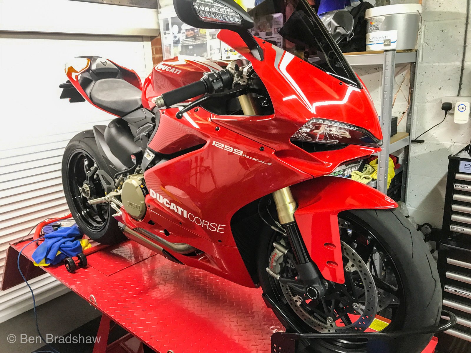

  10. 4D049E35-A22D-4137-B035-01E0A727960E.jpeg I have one and it’s great for everything other than removing the front wheel but that’s more because I’ve changed the front wheel chock on mine.

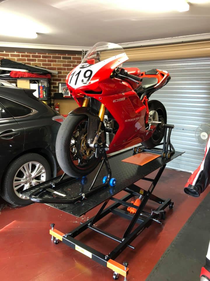

  13. I have gone for the platform. I have not only my 1098S and "on the way" 748R, but a mate in the same suburb has helped me out in bike matters over the years with gear he has so he can put his KTM's up on it from time to time. I also don't intend (medium term) for the 748R to be the last added bike, so I think this will be the most convenient option in my particular situation.:upyeah:

  16. Very clever. Yes, 660mm is wide enough for my front and rear stands on the 1098S, and the platform is 2.2m L minus the front wheel chock which is comfortably long enough.
