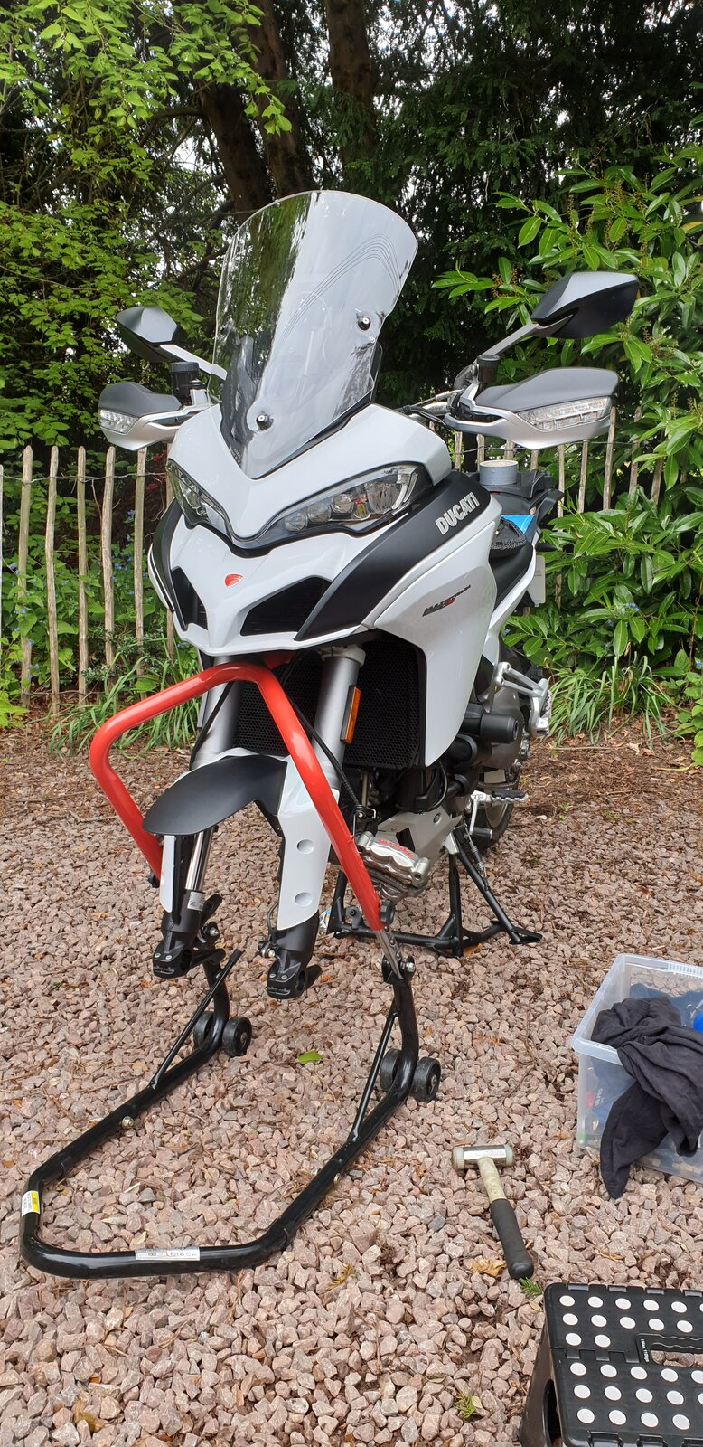

  9. So I went to Ducati dealer to check out their front paddock stand and it worked perfectly on lifting the front wheel while the bike was on the centre stand. Then they told me it was £190!!! Does anyone have a tried and tested, reasonably priced alternative front paddock stand that will lift the front wheel of a 1260 S/PP off the ground when the bike is on the centre stand (without marking the front brake calliper mounts)? I can see loads on amazon / flea bay that look like they should do the job but I don’t want to buy one and find it doesn’t fit the bike, lifts it too high (so risks the bike falling over when the centre stand comes off the ground!) or risks marking the front calliper mounts.

  12. I have one of these, works OK with my 1260 and is adjustable so you can have the bike on it and the centre stand with both wheels off the ground (just). You also will need the 27mm pin as the provided pins are too small for the 1260.
    Not absolute top quality I'll grant you, but adequate. Wouldn't clamber onto the bike with it on this. Have used with my MV and the 1260MTS, less precarious than a jack under the bash plate which is what I used on my previous bikes.
    You do need to unscrew the plastic plate that covers the bottom of the headstock.
  13. Thanks really useful. I’m looking at paddock stands that lift the front brake calliper bracket initially but might switch to your option. BTW I never managed to get mine on the centre stand on our gravel front. Mind you I’m a 5’8” wimp.
