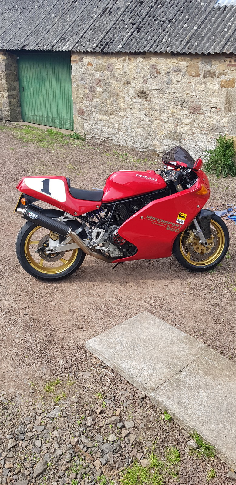

  6. A lot of parts are made now by other companys, such as panels and single seat. I have a full aftermarket set of panels from Ricambi Weiss and although not carbon are noticeably thinner and lighter than standard. I have OZ wheels roughly 4kg lighter than standard and instant difference in handling, and a full Sil Motor system which is also much lighter than standard, particularly the headers. I have never chased weight savings myself just gone for the upgrades I lusted after. It definately feels lighter than a standard machine. Oh, and I would imagine that the carbon tank would make a big difference, they occasionally come up for sale. 20180526_104018.jpg
