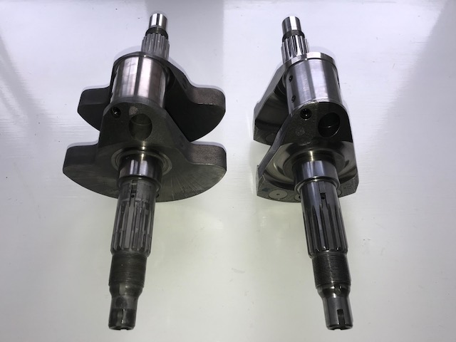

  5. here a picture for you of a 1198 crank versus a 1098R (1198cc) crank.
    1198 has steel rods the 1098r has ti rods. throw in the heavier pistons on the 1198 and you see the size of the webs they have put on the 1198 crank to balance it ( or as near as dam it for the factory)
    With ti rods and lighter pistons the 1098r crank is able to be nearly a kilo lighter!! plus because its a better material they position heavier metal right where it needs to go opposite the rod pistons.

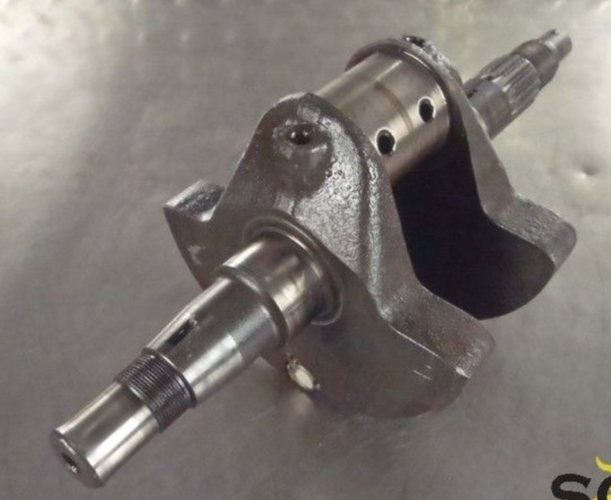

  6. A 900ss crank, i assume this is your project? look at the size of that!!!!
