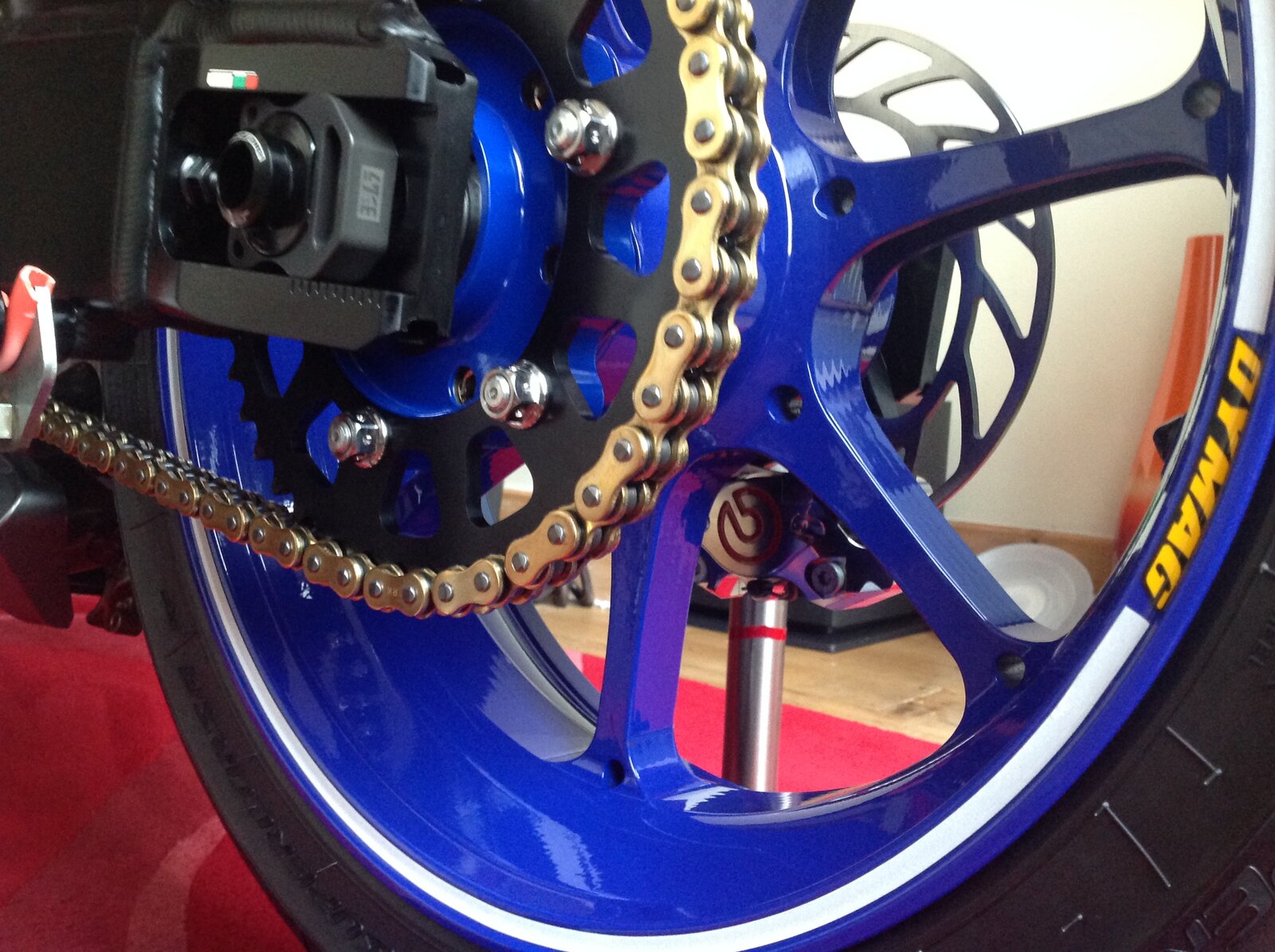

  19. I would highly recommend the Oz Gass wheels, slightly lighter than the older style Oz wheels.... Or Dymags :upyeah:
    64F028E3-420A-45A1-ADE2-1FBEB1CF4F2F.jpeg 45868E77-E6A9-4E54-A1A6-5FD9EBE03BCD.jpeg B5B8D892-46CE-40EC-87B8-277A48C2DDB7.jpeg 89E07C3F-2980-4872-94C2-954E75E3905B.jpeg 3CE37E5C-C42E-48E8-946F-937188377D9B.jpeg F3971DA6-C023-49A4-A6B3-FE3952E8E37B.jpeg
