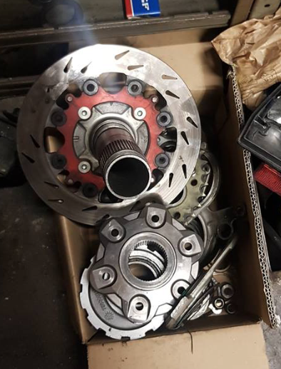

  4. what about a fully floating rear disc....alloy carrier...cross drilled ..

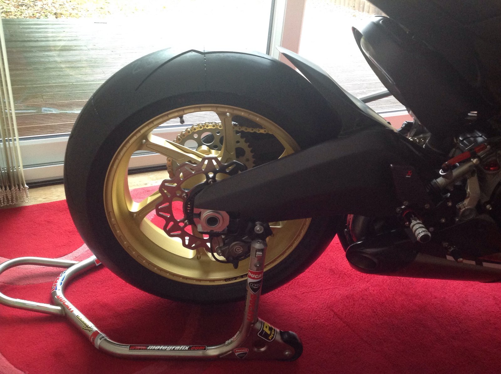

  11. Just look out for any bearing fitment issues. I ran some Dymags UP7X Forged alloy wheels on my blade and found a spinning bearing on the front wheel on one side. As in the bearing OD was machined out of tolerance so basically the bearing wasn't seating tightly. And they were out of warranty! Was a cheap fix but disappointed of not much technical help. I've since purchased the new OZ Gass wheels for the 959 and Have to say the quality is far superior. You haven't much choice with rear disc other than Galfer or EBC lightweight rotors.... I purchased the EBC and even though it's well cutout and vented they have upped the thickness from 4.5mm OE size too a hefty 5.5mm pretty sure the Galfer is the same...but both are still lighter than the OE disc. Not sure on the looks either! im going to get my OE disc Machined early next year.
