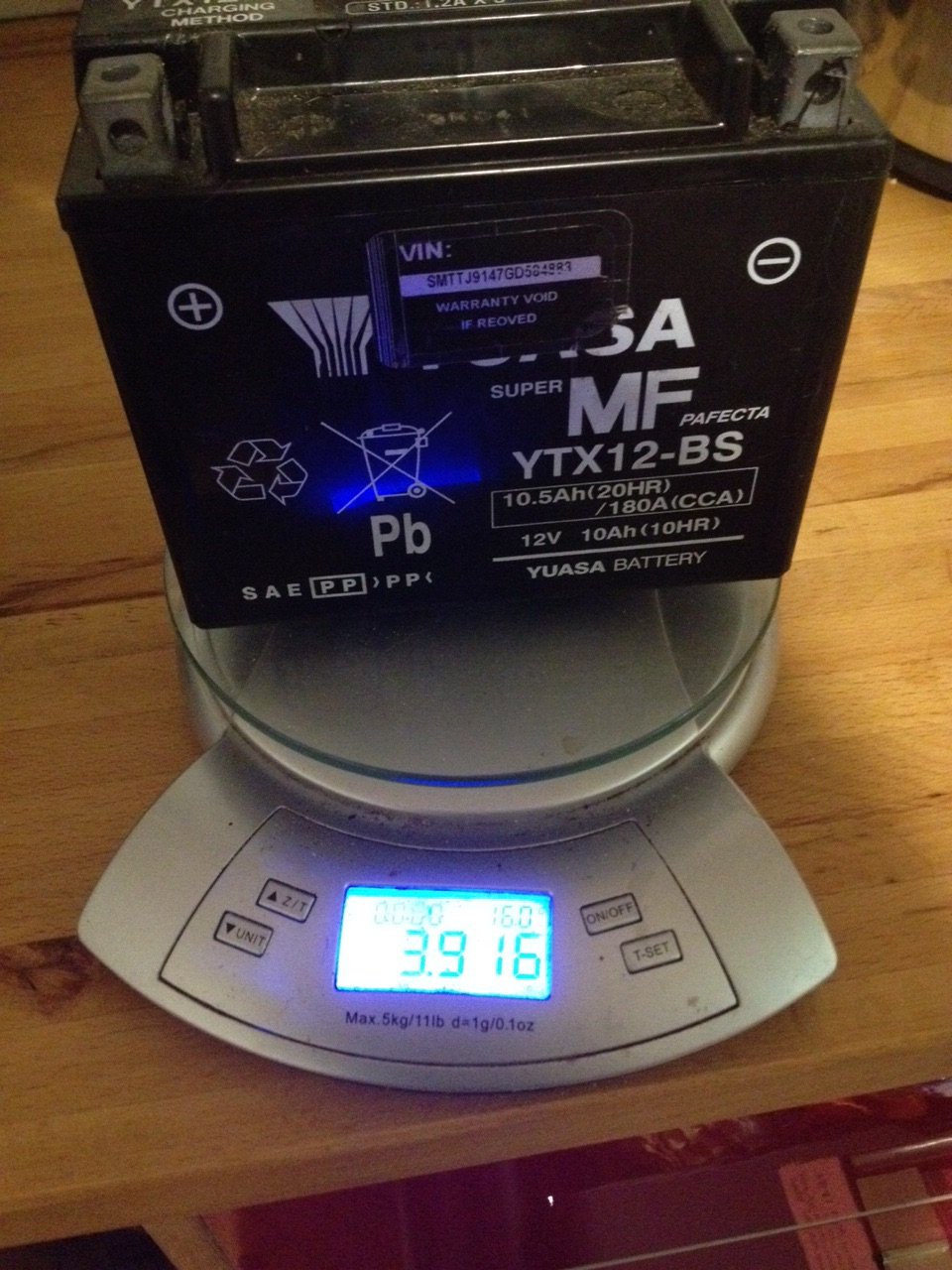

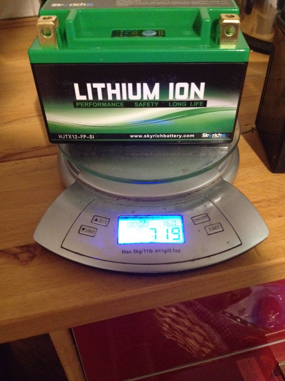

Very light......the same battery can be used in my 749R so will get one for that too. My problem with lead acid batteries over winter is I don't trust an optimate not to start a fire and I am useless at remembering to keep them charged.whereas with Lithium, you just disconnect it, and that's it. It will hold charge for a couple of years. Photos of both on the scales to follow. The reading is grams.
