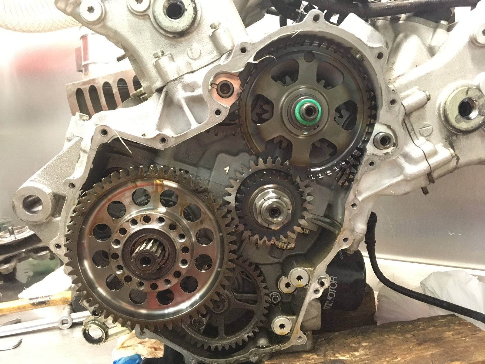

  1. just imported this bike from USA. Engine did not crank, here what I found. Fortunately no damage to other engine components.
  2. was quite common on them
  3. Ah... Wondered what I was looking at for a moment then...
    ... So - what caused this?
  4. I made small research, I believe ducati made too small gap in between gears. That causes overheating and cracking. Ducati have changed part number, so believe part it self also.
