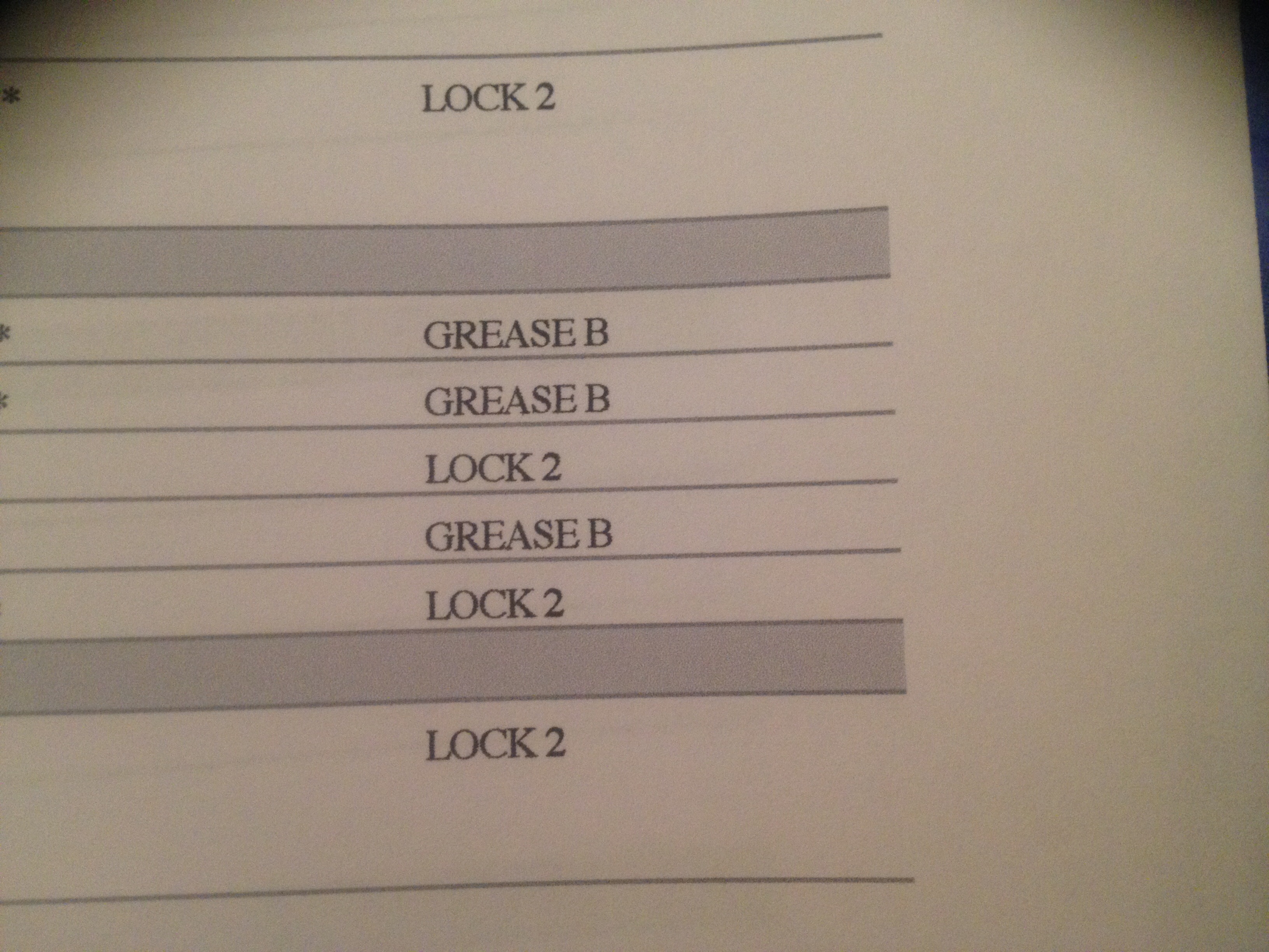

    I'm starting to put back together my 796
    On the torque wrench data sheet it's showing various grease and lock codes.. Eg Lock 1 and Grease 2..
    Can someone please tell me how to determine what these codes relate too, eg which type of grease to use etc..
    Many thanks

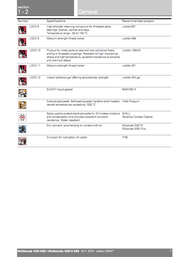

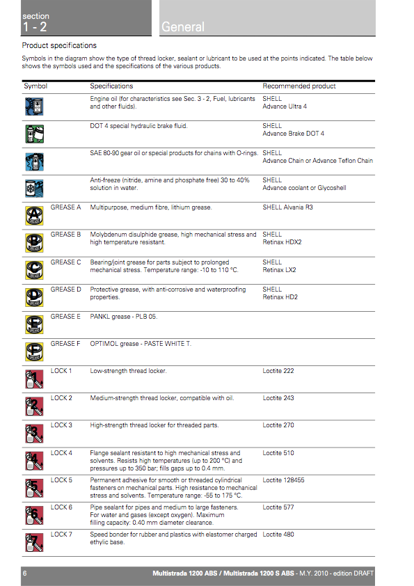

  2. From the MTS1200 manual ...
  3. Derick
    Thanks so much for that..
