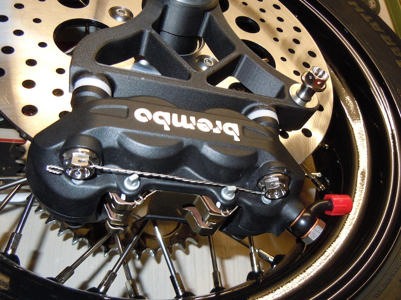

  5. 20's or 22's gauge stainless steel locking wire is more than up to the job for bikes. In aviation there is a recommended "twists-per-inch", but I have long forgotten what it is, I just do it so it looks right.
    The wire locking below "looks right" ! ;)
    Although I have 6" wire-locking pliers, I seldom use them. I prefer to use my duck-bill pliers & twist by hand.
