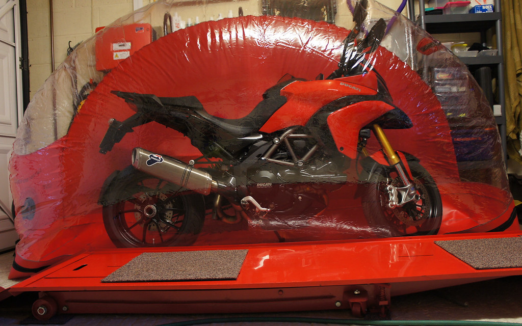

  2. Stopping moisture getting into the engine is something most people don't do. But a vac-bag would of been far simpler imho. Stops the rodents & insects & means you can basically ignore the moisture issue. I believe @Pete1950 recommended this on another thread. Although there is another make which slips my mind.
    Found another one, but the one I am thinking about is red with clear large windows. Found it
    I'd recommend sticking a large tray of rice in this sort of system to soak up residual water.

  3. I probably would have gone for this option if I had known the bike was going to be in storage for this long. Too late to do it now, hence my asking for any precautionary measures when the time comes to collect it.
  4. Yes. I met the owner and proprietor of Vac-Bag once in Greenwich Market, and was so impressed that I bought his products. I have an immaculate very low mileage Sport Classic 1000 Paul Smart LE stored in a Vac-Bag. There is a pack of moisture absorbent granules in there. Both wheels are up off the ground courtesy of ABBA, and the battery is kept elsewhere. Even if a valve happens to be open I am confident the engine will be OK, and the whole bike will remain immaculate indefinitely.
