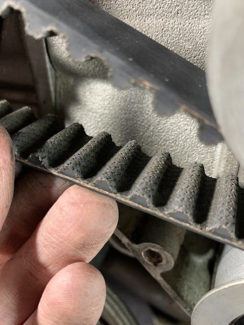

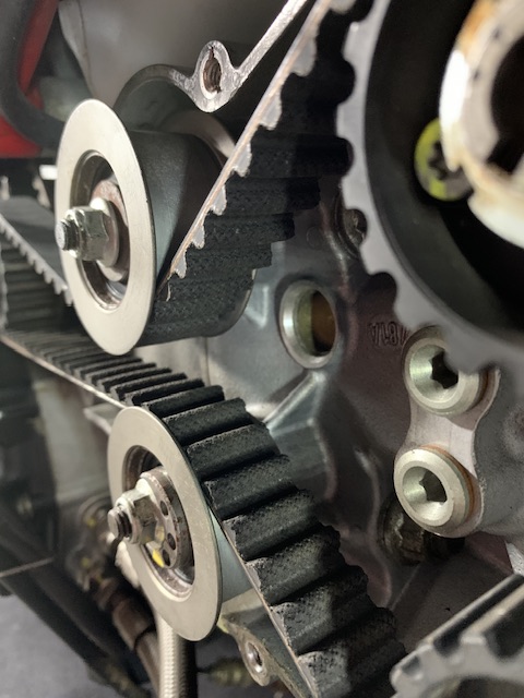

    No mate, 2 years, 5 years I believe on newer models like the 821 motor monsters and supersport.
    here’s what my belts looked like after 2.5 years, they were a little dry and just a hint of starting to crack but probably safe ish… haha who knows, I’d try and stick to 2 years
  5. will do ,how many miles in those 2 years to get them looking like that?

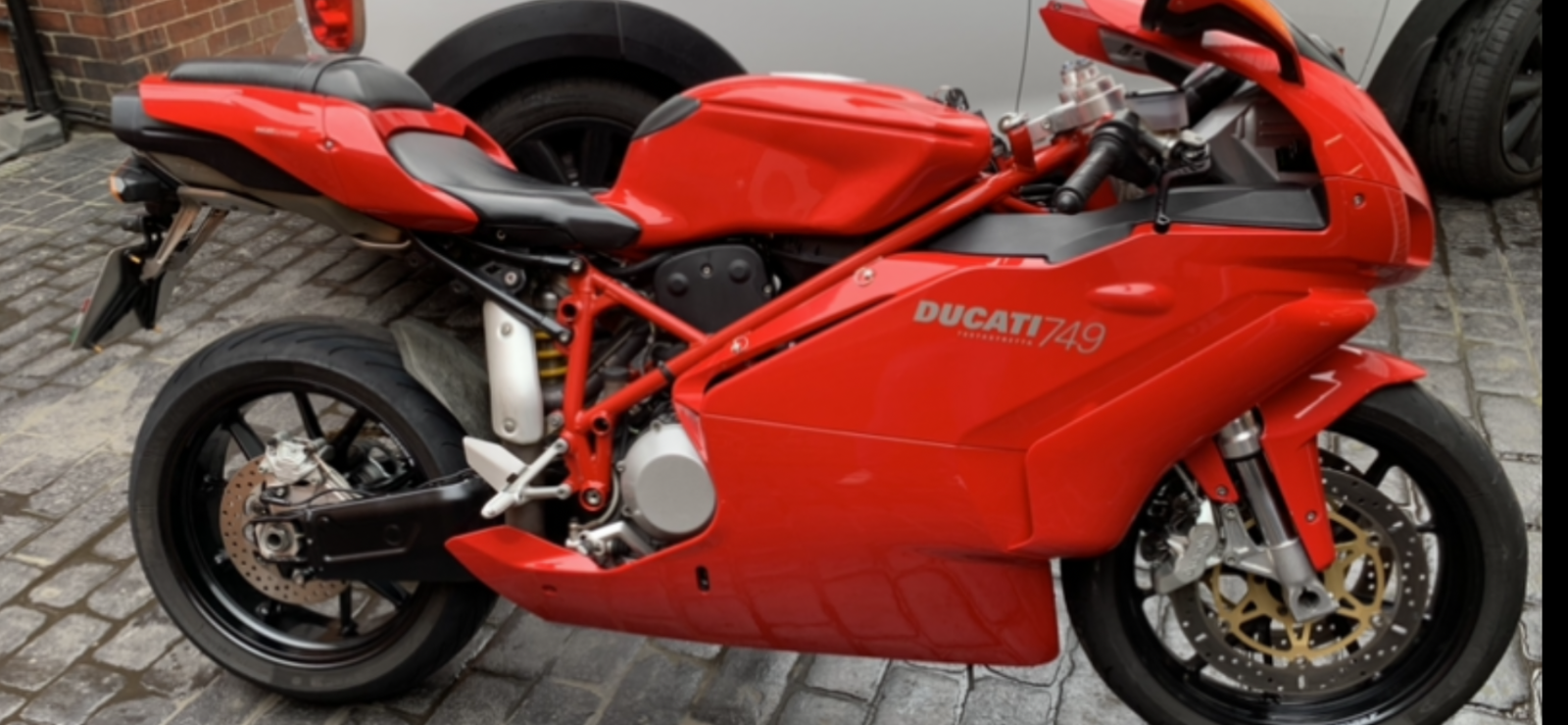

  8. Hi it was between the 848 and the 749 and the 749 won this time but feel I will try the 848 one day
    Landed this last Wednesday

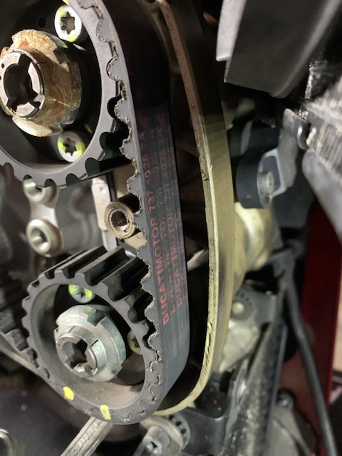

  9. If the belts have been done check that they used Ducati belts not some aftermarket rubbish to save a few quid. The belts were upgraded by Ducati at least once from memory in the early days of the 1098 being released
  10. What do you call "after market rubbish" just out of interest
  11. anything not Ducati I guess, I'm only passing on what a few independent specialists have suggested in way of using Ducati belts only
  12. So most common thought is now that the aftermarket ones from Exact https://www.ducati.tech/shop/Exact-Fit-Premium-Timing-Belts-c155214774/
    Are the preferred option, better quality and better results over life. I understand the OEM Ducati belts are no longer made by the original factory and are NOT the same spec or quality that they used to be. Unfortunately if that's what you're used to recommending as a Ducati tech, you're unlikely to tell people about the Exact ones.... I have Ducati ones on my 996. But was slightly annoyed I didn't get the chance to specify in the end now know what I do.
