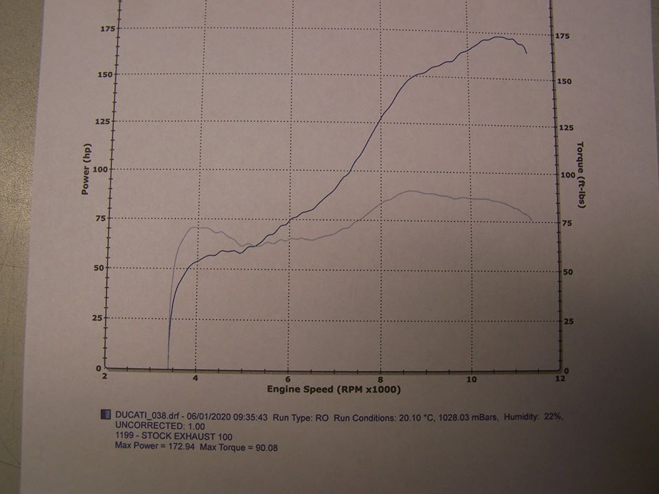

  9. You may well need it re-mapped to sort out the hunting at small throttle openings. I had mine sorted at BSD Performance and it came out with this power curve. This is a standard engine and exhaust fitted but with the emissions kit removed and turned off.
    I am in the process of fitting Ohlins FGRT forks and TTX GP shock to sort out the standard Marzocchi's and Sachs shock. That will then be it.......for the time being.
