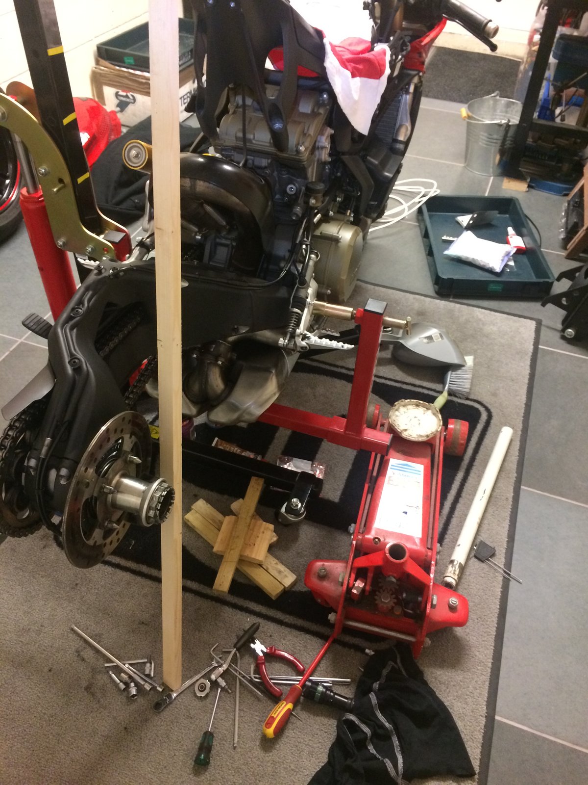

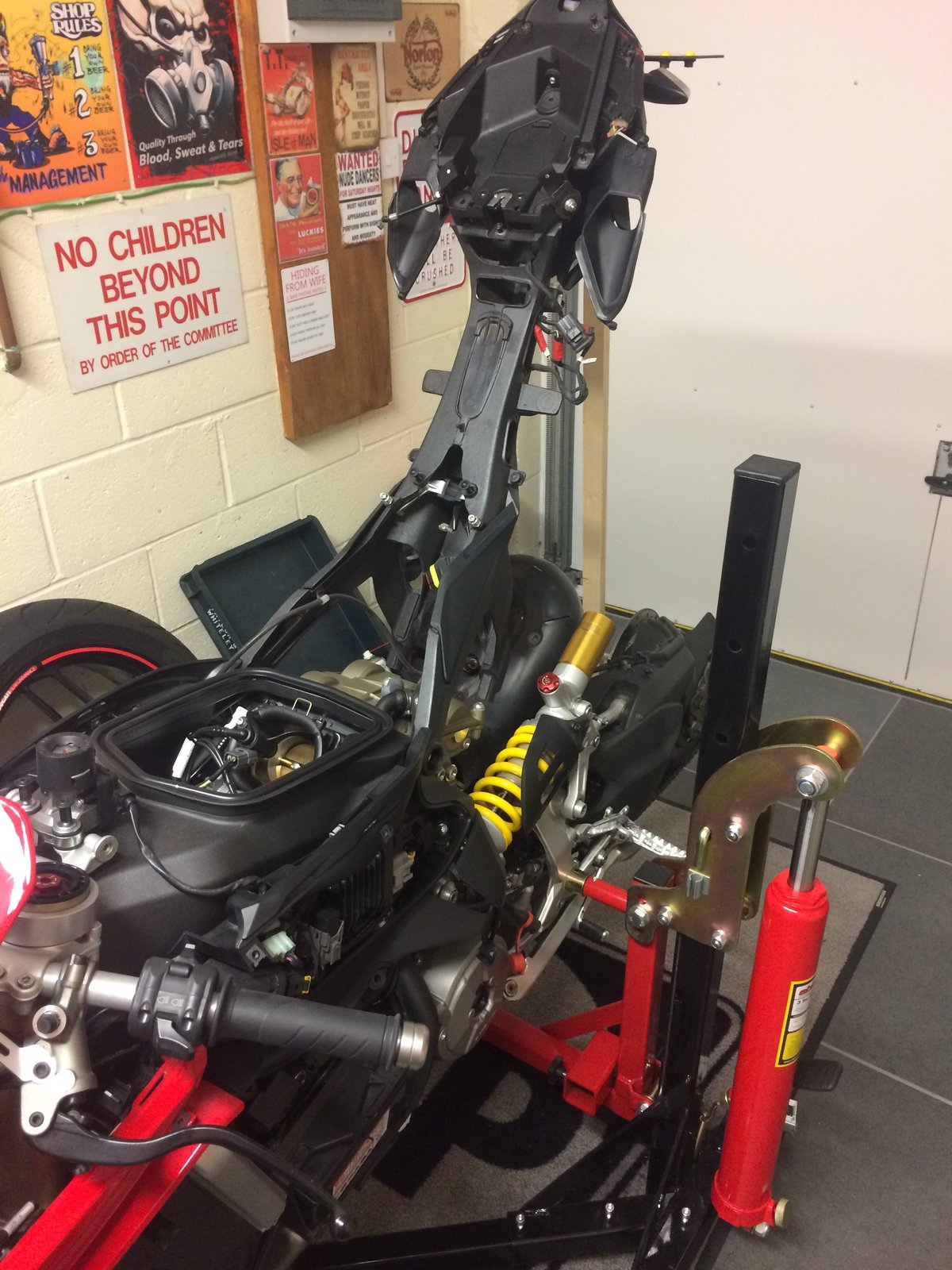

  4. If you can't get the 3 allen bolts out that connect the silencer to the Y piece then this is the type of job to expect to get the silencer off.
  5. not keen on that. Think I will leave it to rattle

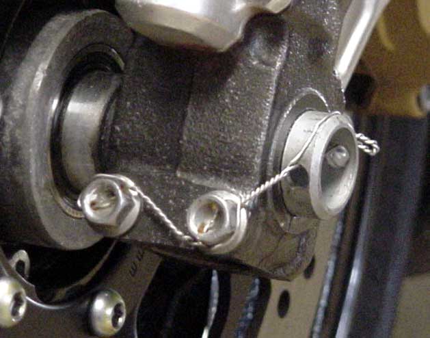

  10. Remove cans, Lock wire offending items, bolts cans back on
  11. How do I lock wire the bolts?
  12. How do I lock wire the bolts?
  13. Lock wire is a good idea, I should have done that myself. @PCRR see picture below as an example of lockwire.
  14. if I take off cans will do threadlock and lockwire.
