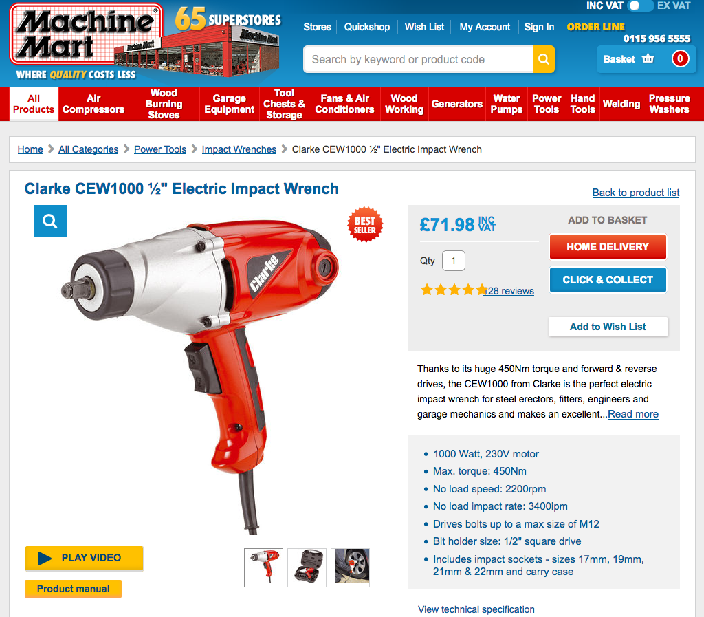

  7. Buy a Clarke CEW1000 electric impact gun and a 55mm bi-hex socket and you will never need the dealer to rob you for removing the wheel.

  12. Sort of pricing strategy that says “we don’t want the work”. Same sort of strategy being adopted by tyre fitters who aren’t asked to supply the tyre you want fitted so charge £50 to fit it. Nothing new there. I agree with Ricky, buy your own tools, Lidl were doing a mains power impact gun for £30 not so long ago. Andy
  13. ^^^^^^one of them^^^^^^^
    Also great for front sprocket and clutch centre nut and other stuff I've not come across yet.
  14. Clarke rattle gun as above. Works great getting the wheel nut off the MV and that's done up to 220Nm. Got mine when they were running a special for something like £50. Combined with a SpeedyMoto stainless polygonal socket, alloy ones probably not great for impact use, removal is a breeze. Previously was almost impossible as a one man job unless you put the bike in gear which isn't recommended (possible to damage case hardened gears apparently).
