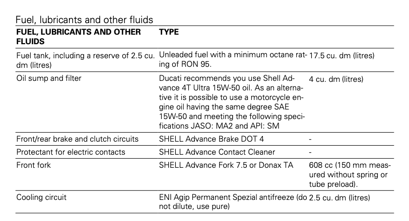

  5. It is written in the owner's manual for each bike. So for M1200R is it 2.5 liters.
    Same for my M1200S but strangely light always comes on earlier than 2.5l left. When light comes on I go fill it up and I always end up getting around 12 liters into the tank until it is full.

  6. Determining "real world" reserve remaining is exactly the reason for the thread.
    You guys @VINNIE @sinank , are empirically confirming that the reserve is about twice the capacity stated by Ducati.
    12 litres is about what I suspected if I remember based on total price to top-up.
    I can't remember ever adding the price equivalent to 15 litres (in a 17.5 l tank) as soon as the fuel light comes on.
    I will be focusing on number of litres for a fill-up this upcoming season. Thanks guys.
