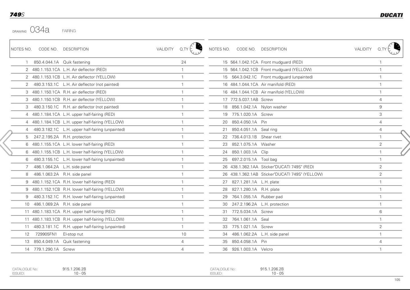

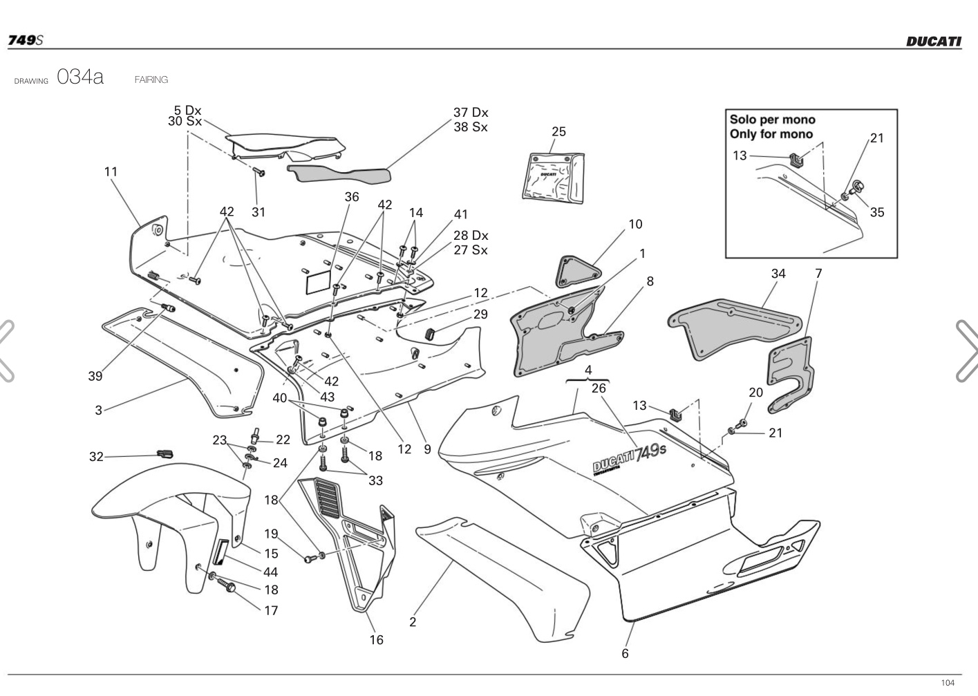

  1. How are the 2 halves of the fairing held together, clip and bolt or well nut and bolt. I have tried searching the inter web but haven’t as yet found an answer.
  2. Early bikes have wellnuts, later bikes and R's have Allen head Dzus.
    Edit: or do you mean both individual (plastic) side fairings which are made from two pieces?
  3. Wellnut and bolt.
    Copper grease is your friend.
  4. @RickyX will be along soon if above doesn't help, guessing you have looked on parts lists already?
  5. 749R is socket head Dzus.
  6. The two halves are held together with a single Allen head bolt (I think the 749R uses 2 bolts)
    #6 chrisw, Aug 13, 2021
  7. 749R is two socket head Dzus.
  8. I couldn’t find one Chris I did a search which yielded nothing, there are 2 lugs and holes that join the 2 halves under the engine. I bought the bike a while back and it was a little bit un assembled so has been a little bit of a jigsaw. I thought it may well have been well nuts but I got given a couple of bags with all sorts in.
  9. It is the 2 halves each side of the bike, I’m finally putting it back together after it being off the road for a considerable time.
  10. Thanks, there are 2 holes and lugs, but it certainly isn’t a R not matter how much I would like it to be.
  11. Make sure you grease them up on reinstallation. You do not want a seized wellnut, a right PIA to get undone. If they will take the dzus then that would be a nice upgrade. The 749 obviously differs from the 999 as mine has a single bolt holding them together.
  12. Thankyou Chris and ChrisW.
    I have experience of well nuts having owned a couple a couple of faired Ducati, I was hoping these weren’t well nuts and may upgrade if possible to Dzus. :upyeah:
