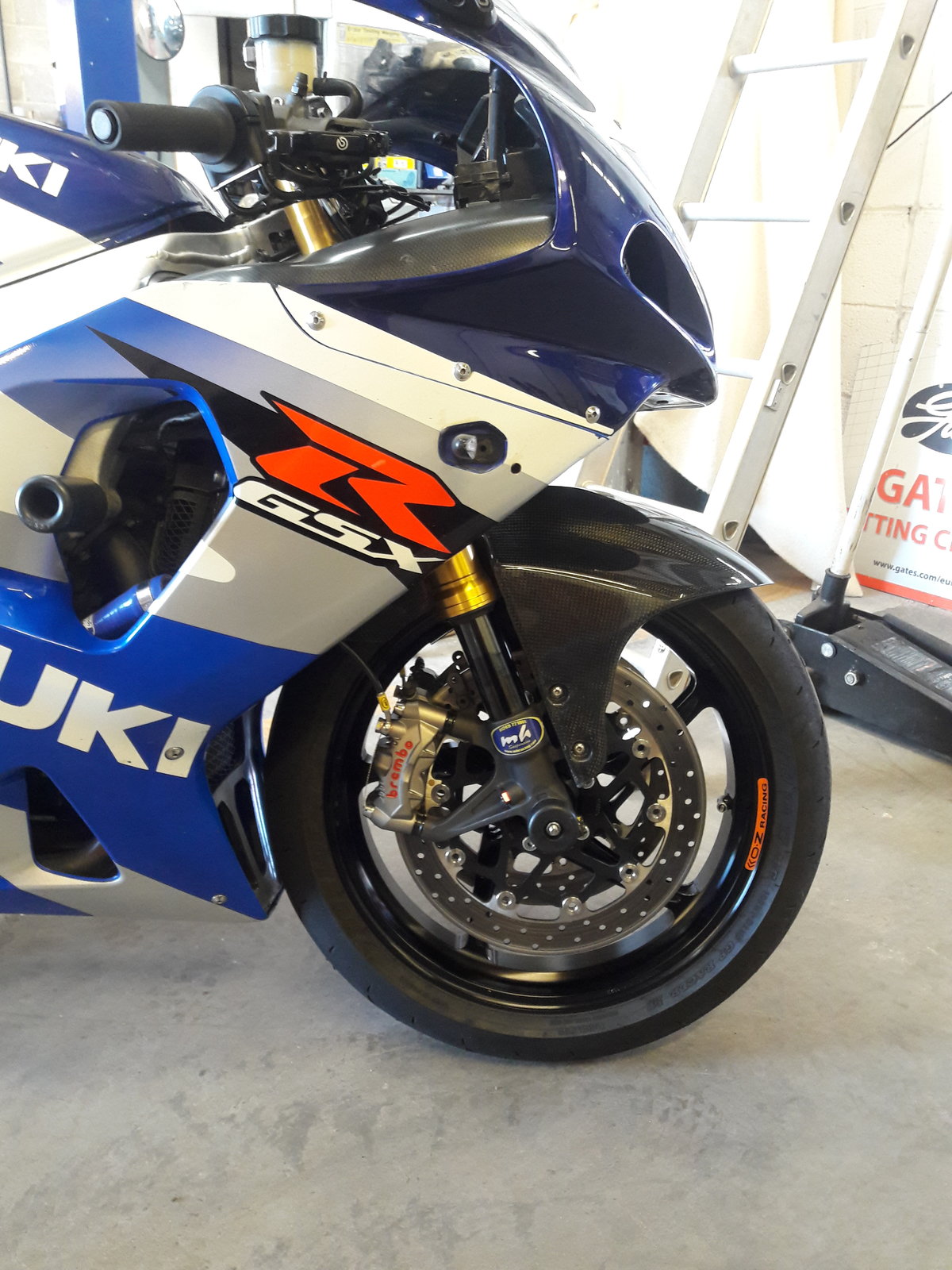

  7. I've just put gp4 rs calipers on my gsxr with z04 pads and rcs mater cylinder the brakes are fantastic now.
  8. Yeah must admit those gp4's look sweet.
