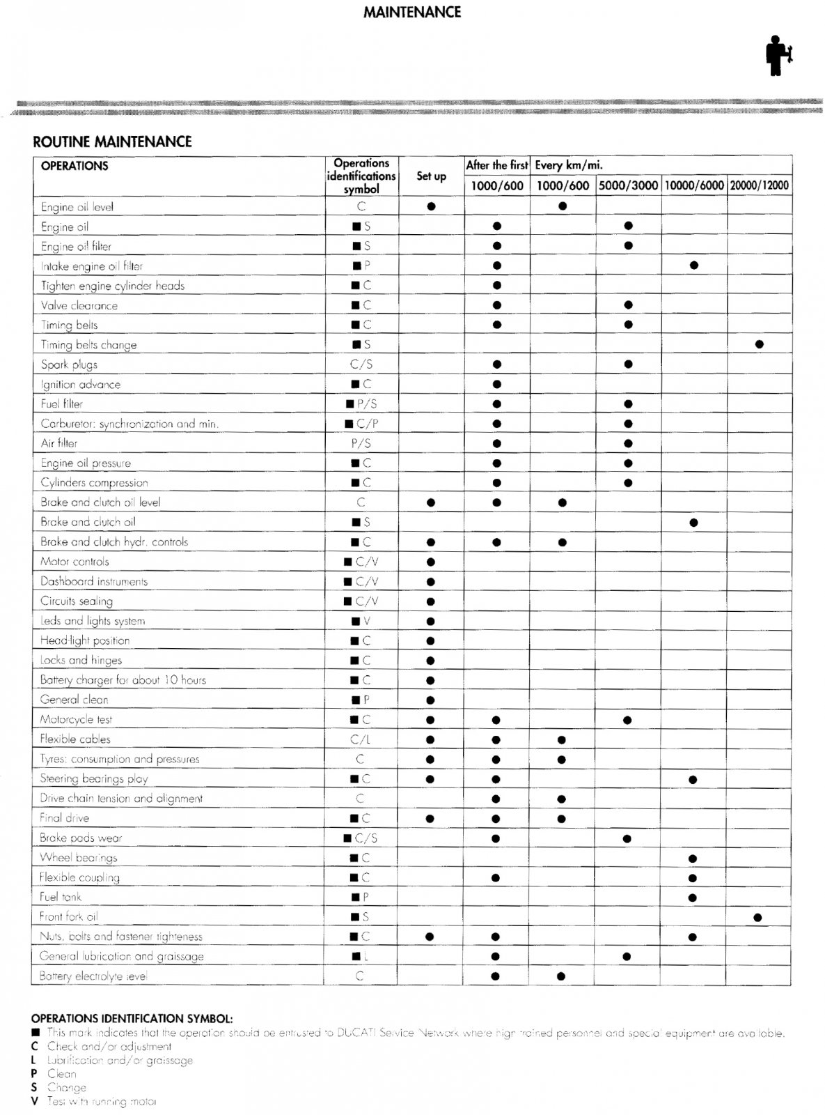

  3. The service interval for the belts on your bike is 12,000 miles or 2 years, whatever comes first. You don't say how long the since the belts were changed but if more than a couple of years ago I'd change the belts, if less than 2 years it should be OK for another year. I previously owned a 907ie, the handbook only specified 12,000 miles with no mention of time: I bought the bike at 20 years old with 27,000 miles on it, the previous owners had only had the belts changed twice! It had survived belt changes at 12,000 miles but about 8 or 9 years apart.
    The engine for your bike is the same as the 91-97 900SS, parts list for which are readily available online. If you can't find a copy message me and I'll send you one.
    at only 11,000 miles the cam belt tensioner rollers should still be good unless the bike has been stored in a damp environment. With the belts off check to see that the roll freely. If they do leave well alone. In theory the bearings on the movable tensioner can be replaced although I've never managed get them off the tensioner arm. Those on the fixed roller are integral with the roller assembly. So replacing the bearings gets quite expensive at £50 a pop for the fixed rollers.
    I've attached copy of the service schedule for your bike.
    900SS:Monster maintenance  schedule.jpg

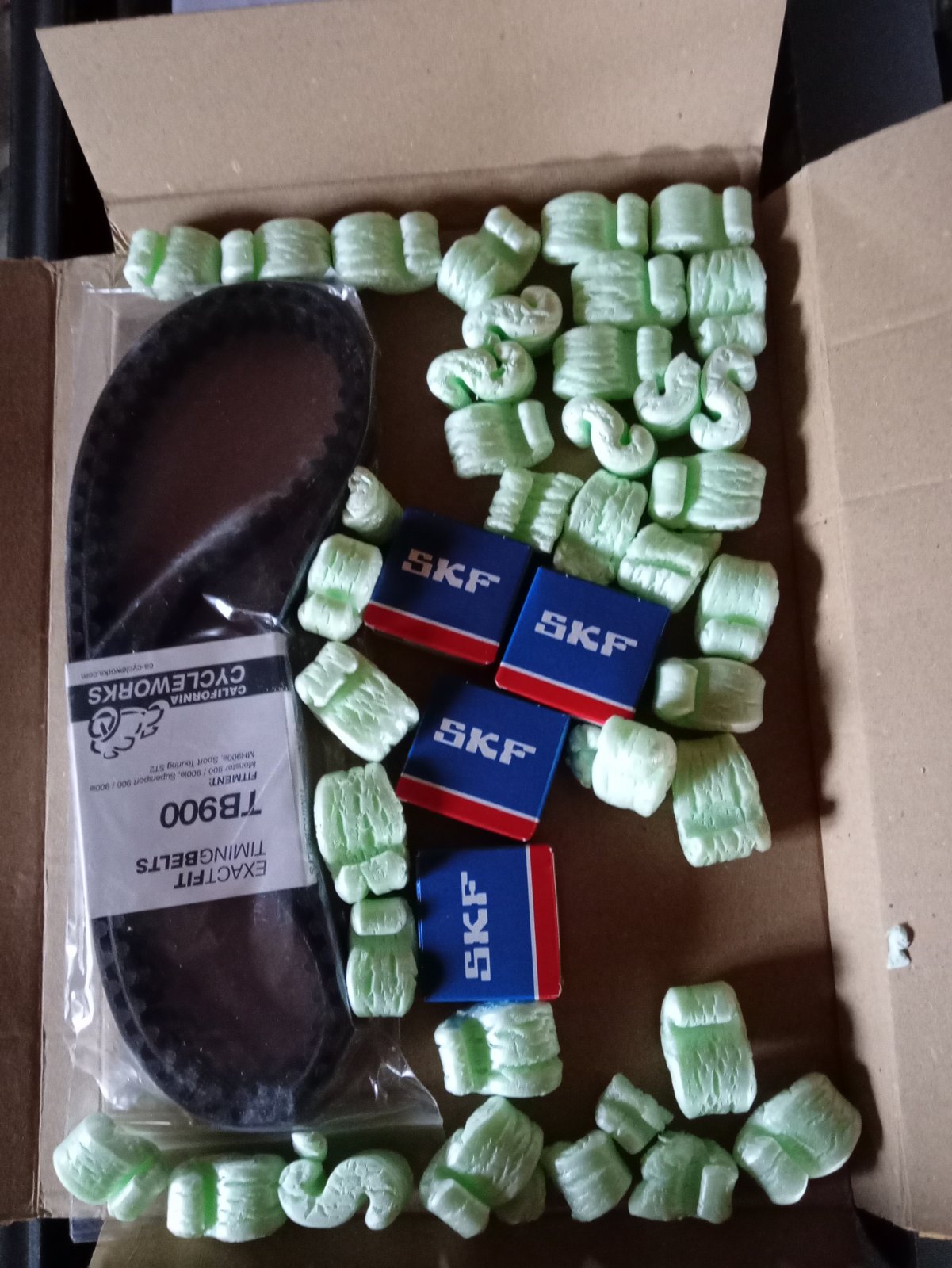

  6. Thanks, I've checked out Exact Fit and the kit comes with SKF bearings for about 1/2 the price I've seen elsewhere. So I'll go with those.
