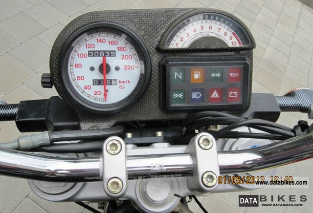

    Ducati did make an aftermarket rev counter that fits to the existing dash;
    Can't imagine they're still available new but they pop up on ebay etc. occasionally.
