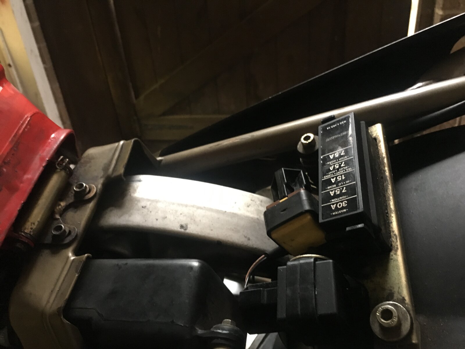

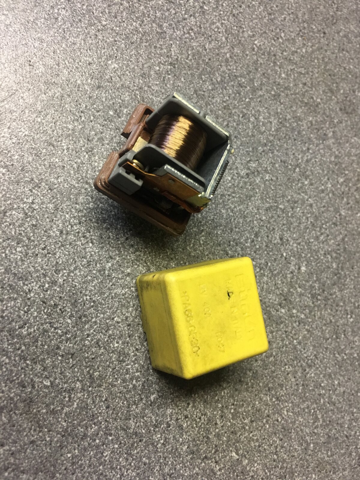

Found the problem, it’s the relay under the seat, just turned the ignition on and dash lights were dim, tapped the relay and they went bright, repeated a couple of times to be sure, just sprayed electrical cleaner inside and it’s working fine now, I’ll get a new one though just to be safe, nice easy fix.
