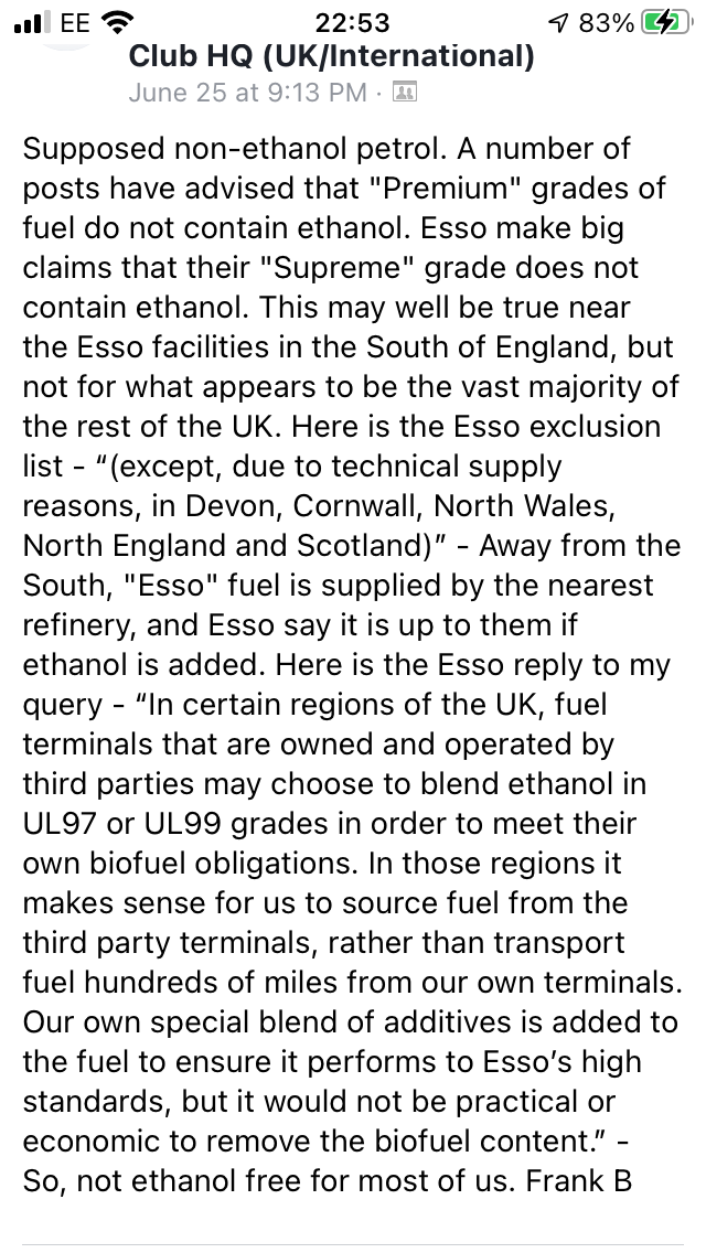

  10. This is on the VJMC site ref ethanol
  11. Hmmm...
    The guy doesn't say where he is? I think Esso would be unlikely to make the claim & charge more for the Synergy if it wasn't largely true. Hugely bad publicity and its easy to check. In fact I'm going to test some this weekend and find out!

  12. They do have an E5 symbol on all of their pumps though Jez :), I will do the test you’ve mentioned though next time I get a gallon of fuel in a can for one of my fathers bikes, I think the VJMC guy is correct tbh, he’s only quoting what Esso told him, as an aside I just taxed a Daewoo Matiz 796cc for my father, £210 !!!!!, as I did so I thought how unfair it is that people with older cars have to pay more for their car tax, ie people on low incomes or retired can’t afford a modern low emissions cheap tax car and can ill afford £200/300+ tax, I thought why have they never just abolished road tax and put it on fuel, then it dawned on me, they knew electric was coming didn’t they!, tossers.

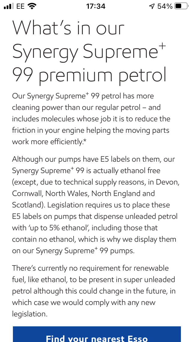

  16. The pumps all have a E5 symbol because E5 means up to 5% ethanol. Even zero Ethanol is labeled E5.
  17. Yeah, I recon they are missing a great marketing opportunity by doing that, I mean given the demand for zero ethanol fuel if I was selling it I’d put a huge great sign on the pump stating “ZERO ETHANOL!”, weird isn’t it that such a big company has missed such a great opportunity, of course if they can’t guarantee that the fuel you’ll be getting is in fact zero ethanol because as they have stated the fuel can be mixed with ethanol by their 2nd tier refinerys away from the south then they’d be stupid to put a zero ethanol sign on the pump.
  18. Provided Esso’s interpretation of what’s “the North” is correct I’m OK, I’m in the East Midlands :) 37FD2456-3139-4F2D-9A50-78A3FF16AF73.png 74C638F4-556B-4CBC-B24A-9C5096D23ACC.png
  19. Probably Kingsbury, AFAIK they must blend it as they fill the the tankers there as that fuel depot is shared with other fuel providers. Unless they use the dedicated Esso facility in Birmingham to supply your area, I would assume anything outside the Home Counties is ‘North’.
