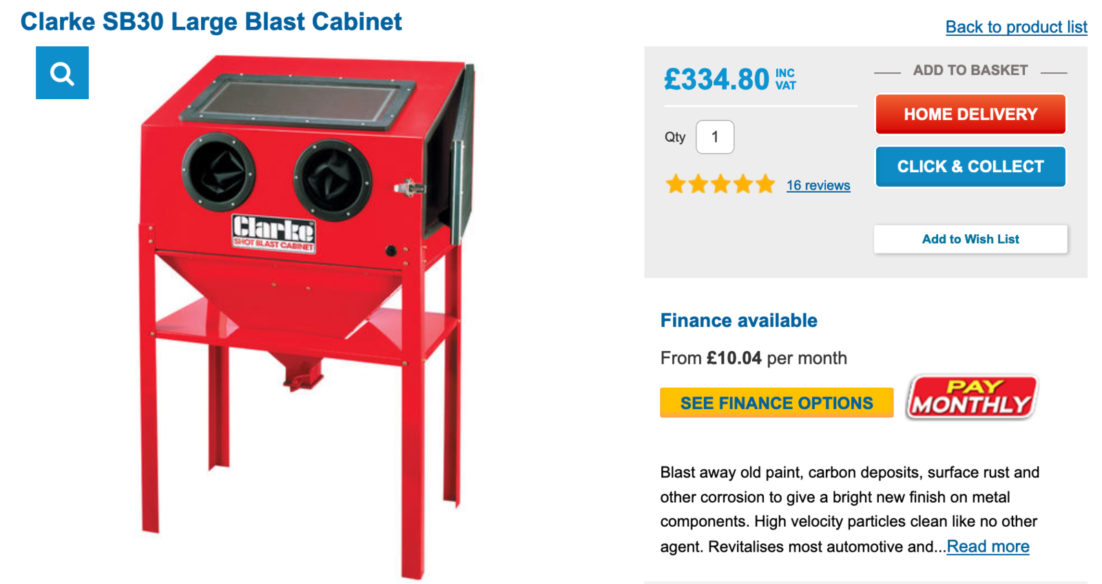

  1. One of these keeps catching my eye and as I have an old scooter to restore over winter, I wonder if they are any good. :thinkingface: Does anybody have one?

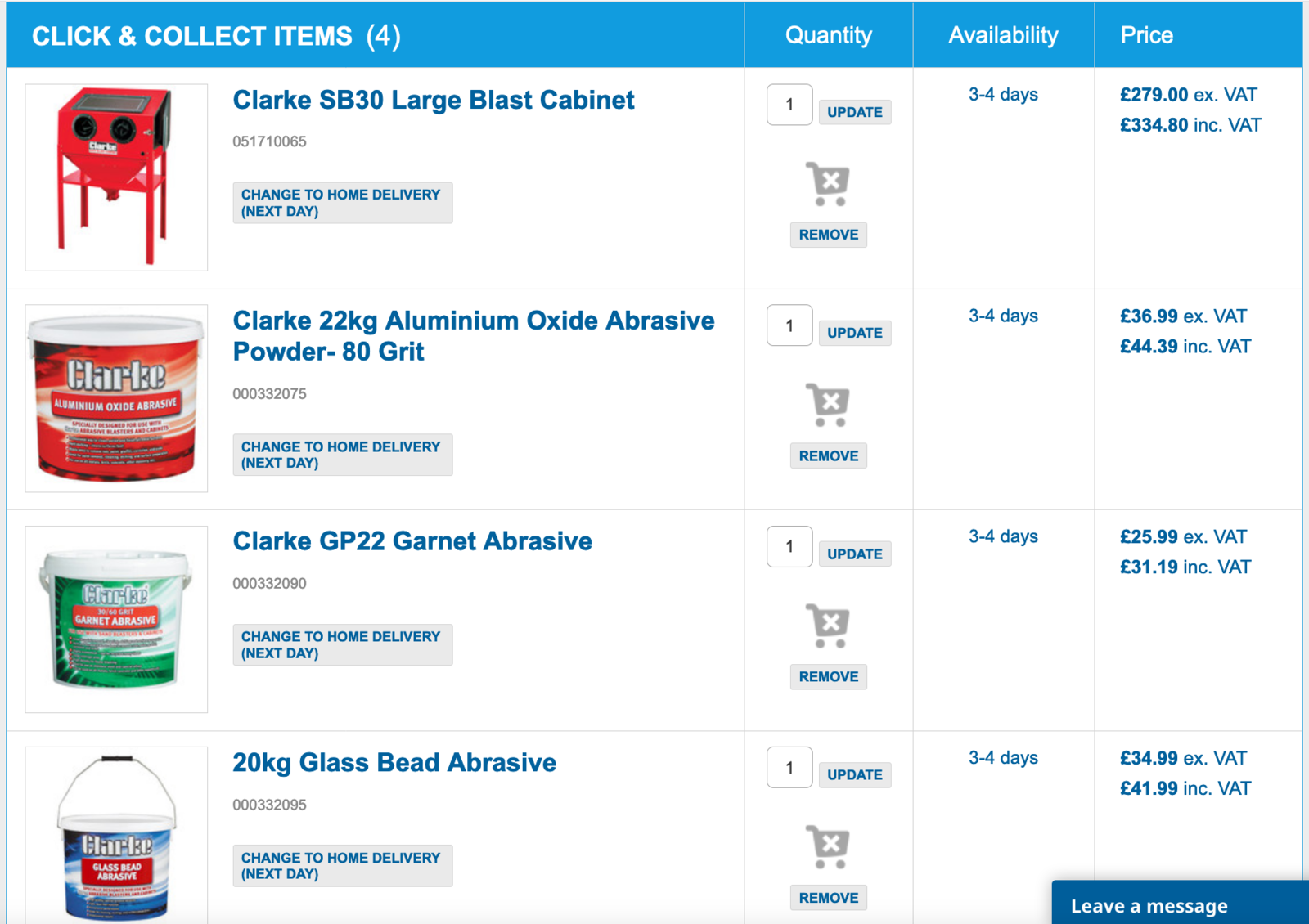

  9. I've got these in my basket. :thinkingface:
