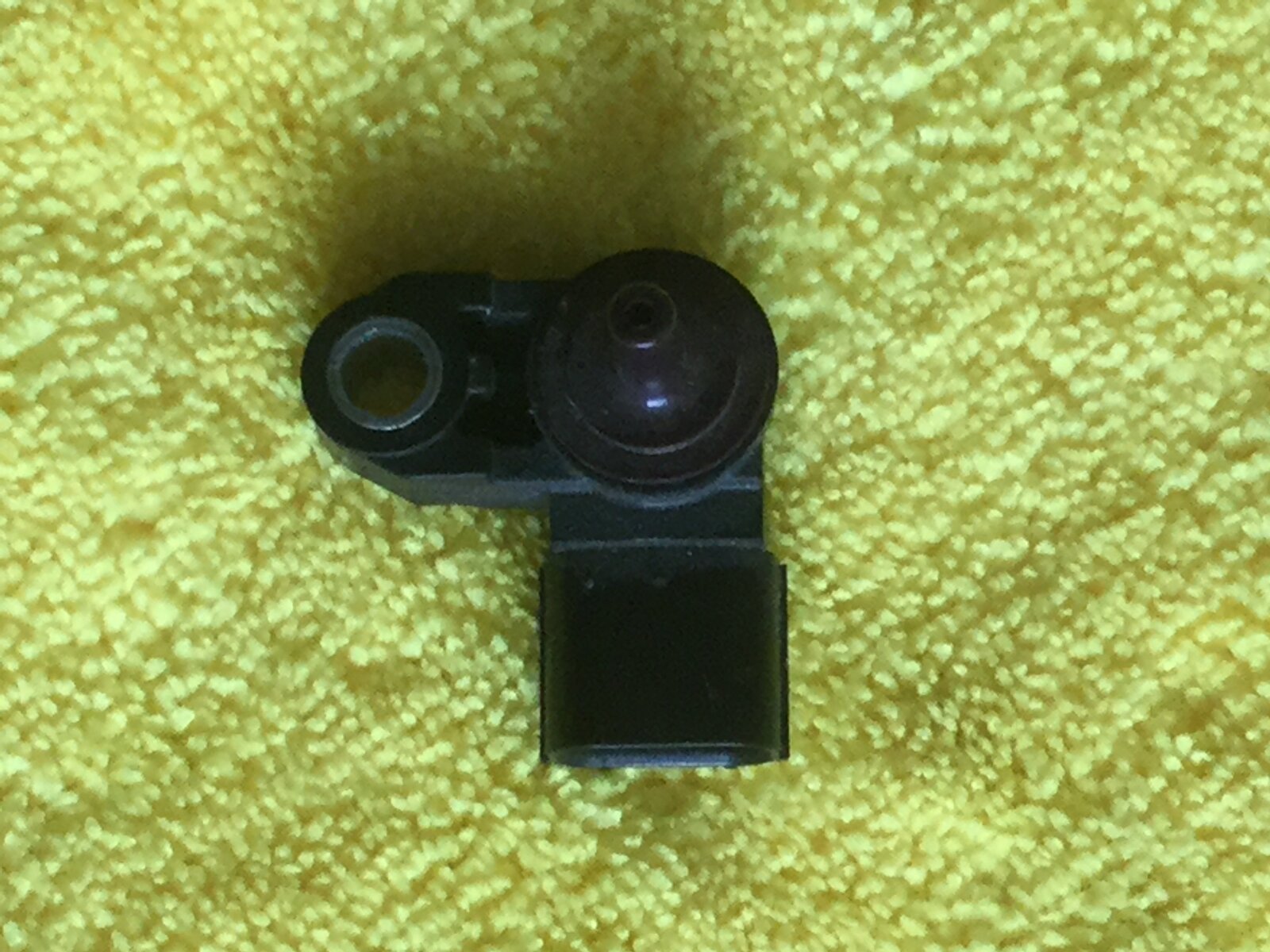

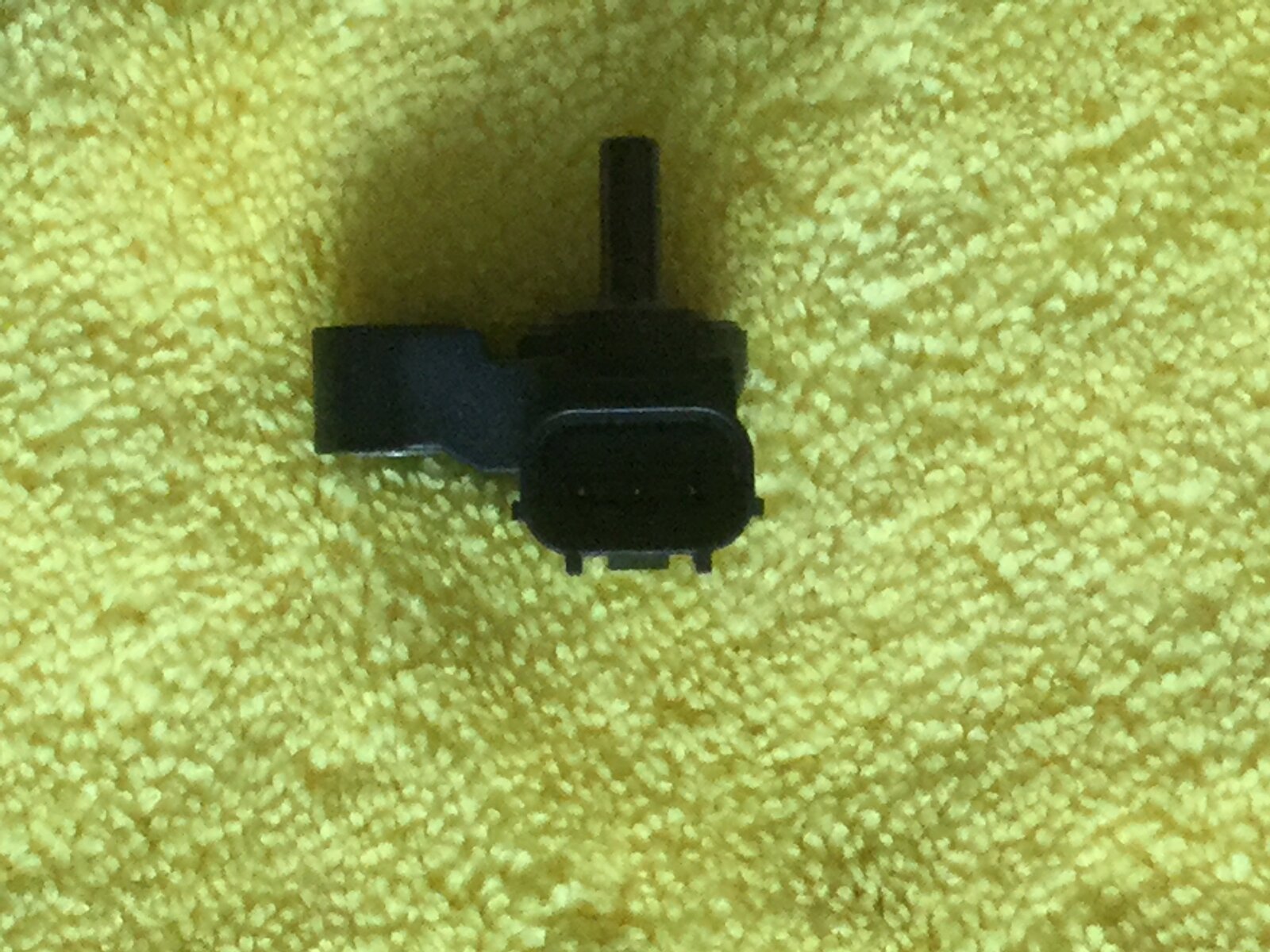

  3. This is a MAF, 0096FECE-3A9B-4910-8EFA-65EF8CC8DB13.jpeg 1EED190A-E2AA-4841-821E-61196459D891.jpeg the reason it costs so much to fit is you have to remove the petrol tank to get at it. A DIY job if you have the patience, no special tools required. Not sure how much Dealer input is required to clear the fault so the new MAF is seen by the ecu. Andy
