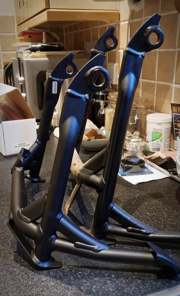

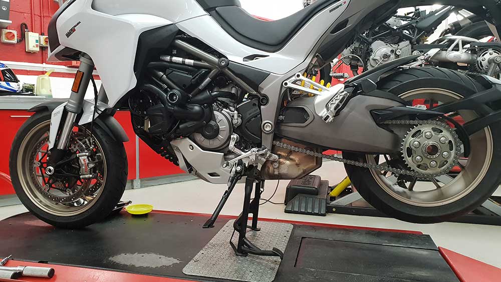

  12. I used this to replace the stand that the supplying dealer fitted to my 1260 Mutley. They had a regular 1260s and made up a touring pack from parts in their store. Unfortunately they fitted a stand off an Enduro and either didn't bother testing it at all or just didn't care... I had struggled to get it onto the stand a few times but as, at the time, I was parking on gravel it sort of worked OK. It was when I had the 600 mile service at JHP Coventry (not the supplying dealer BTW) the tech came out of the workshop and asked me to come and have a look...
    Supplying dealer did send me the correct stand and I fitted myself using the penny method. It was still quite difficult but I managed after some swearing and huffing and puffing.
    These are the two next to each other...
    You can see that the Enduro stand has been touching down and did so rather alarmingly and not that far heeled over the first time with my the GF on the back, Had it not been damp and I'd been a bit more enthusiastic it could have gone far worse than it did.
