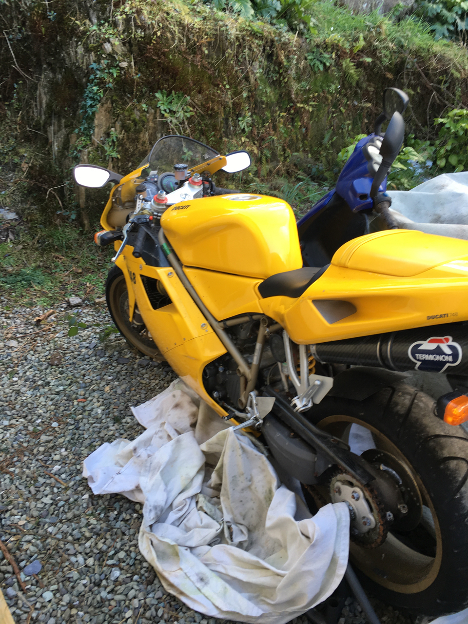

  1. So I have a 1999 748BP which I've had since new and I'm embarrassed to say she's only done 2500 miles! For the first 11 years of her life she was kept in a garage when I was living in London and was only used when the weather was fine and when domestic/family/work commitments permitted I could have a Sunday morning out on her - so few and far between, hence the low mileage. Then I moved to the s.west of Ireland. No garage. She came over with the furniture in a van and was put under a waterproof cover in the front yard. Not ideal. It was October. It rains a lot (well it used to but now we have a drought!). The roads are covered in cow shit and potholes. She didn't get used. Come the next summer (short as it was) I had a job which, for the next several years kept me so occupied I had no time to ride. The poor girl sat there and waited and waited and waited - and waited some more, shivering under her cover. Then last October, Storm (Hurricane) Ophelia came and we live on the Atlantic coast - full force. Ophelia very kindly picked up a half full 10ltr tub of emulsion paint from behind the back of the small shed and deposited it right next to the bike. She then blew the cover off the bike (even though it was strapped down) and then blew the bike off the axle stand and deposited it on top of the plastic tub of paint which duly split open and covered the left hand side of the bike in white emulsion as well as cracking the fairing and breaking the wing mirror and indicator. Thanks Ophelia, I love you too!.
    Long story cut short, my job finished a couple of months ago and I now have time to fix her up and, hey, it's permanently sunny & dry now, perfect riding weather. OMG. What a mess. So here's a thread about what I found and what needs to be done to restore a 748 after 7 years of not being used and kept under a cover outside.

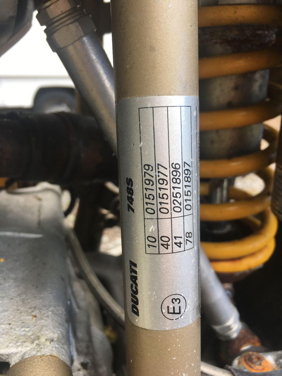

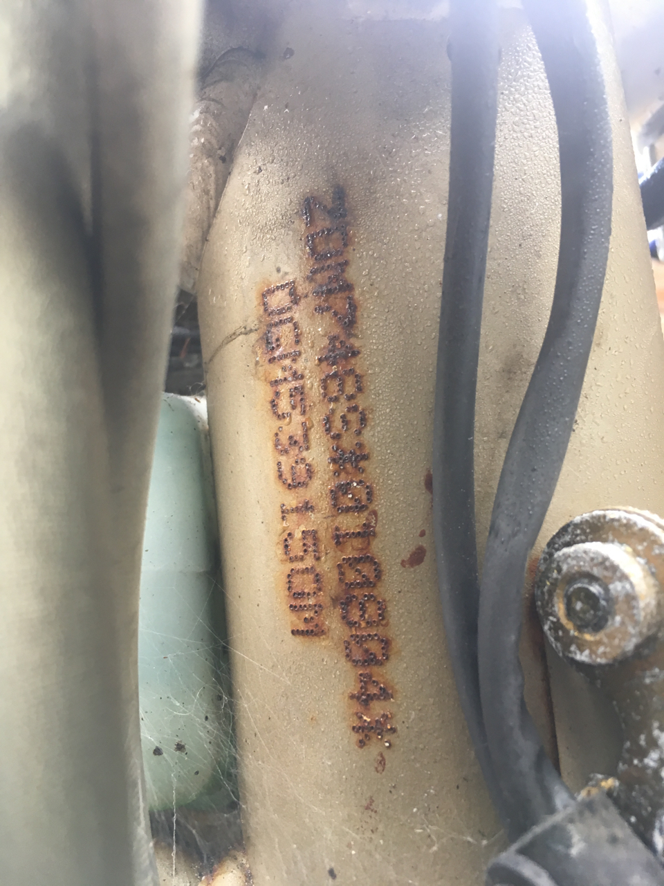

  3. So here's the first thing. I found the original receipt and I bought her in June 1999. However, the frame label says 748S, but she has a gold frame and 3 spoke wheels, Ohlins rear shock and no Showa forks, so why 748S on the frame label? IMG_3131.jpg can anyone shed any light on that please?

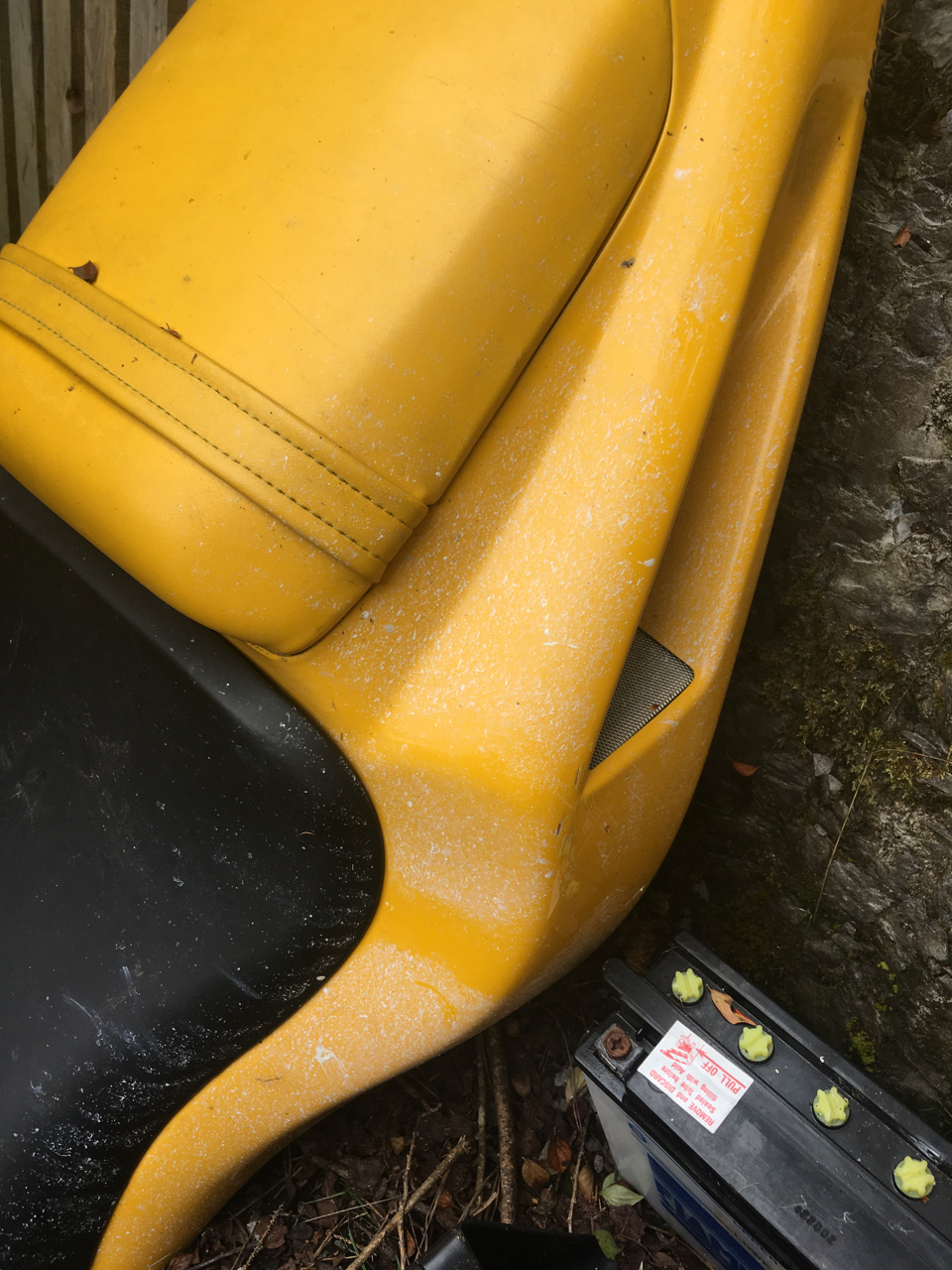

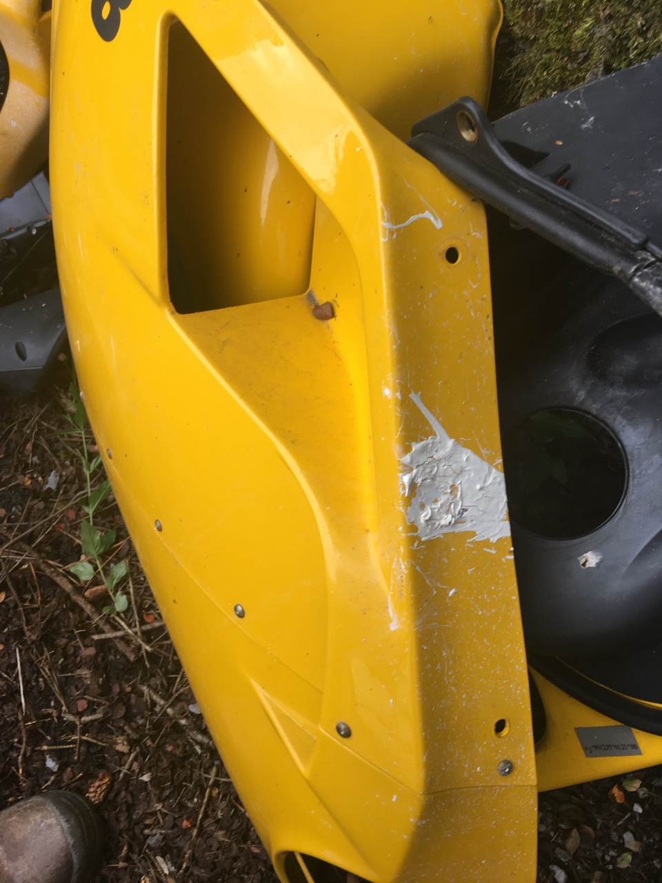

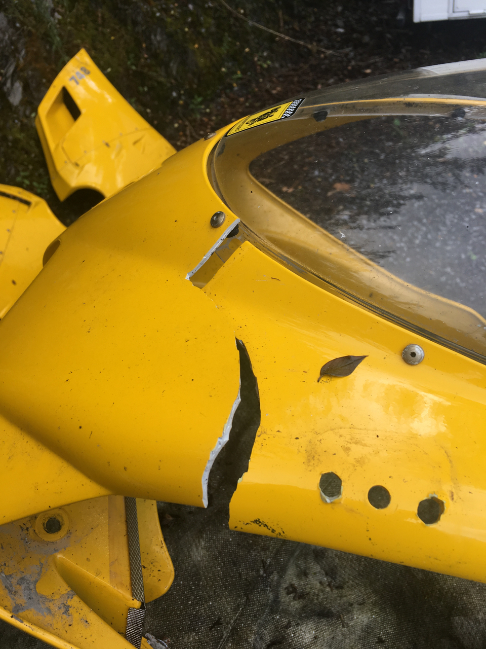

  4. Here's some pics of the paint spattered and damaged panels.

  6. Re the S on your frame sticker, my bike is a 1998 biposta it also has the S just like yours, it is believed to stand for Superbike, it also has a Ohlins rear shock but this may have been fitted by a previous owner.
    Steve

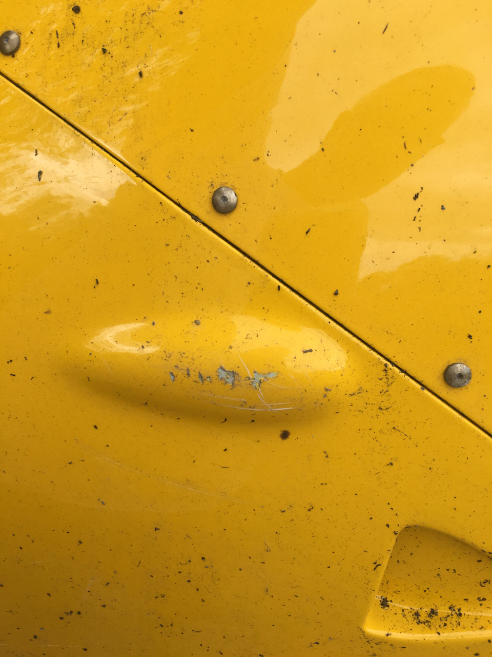

  18. So, I mentioned that my yellow 748 is really a red one in disguise. Here's the pics to prove it. As you can see where the yellow has rubbed and been cut away under the seat you can see it's red at heart.

  20. I'm also working away, slowly on getting the emulsion off the body panels. Hot water/fingernails/WD40. However, the nose fairing is probably beyond salvage (although it's been glued and gaffer taped for now so I can at least have a ride on her again very soon). I posted a thread in the wanted section but I'll post it here as well.
    I'm after a couple of bits and pieces to repair/replace some storm damage that happened to my 1999 748.
    1. I could do with a new yellow nose fairing because the current one doesn't look too pretty and they don't make yellow gaffer tape. Ideally one with the white strip up the middle.
    2. I also need a 'special screw'. No laughing at the back there! Seriously, that's what it's called. It's part no. 779.1.137.1A and it screws into the wing mirror and secures it to the fairing frame. 'Special' as it's designed to break off if the bike hits the ground.
    I'm thinking, if I have to get a new nose fairing I fancy an SPS type one with the white strip and I'll probably change the BP seat for a Mono, (I almost did that 16 years ago - probably should have specced a mono in the first place!), also with a white strip so if anyone has those bits knocking around please let me know.
