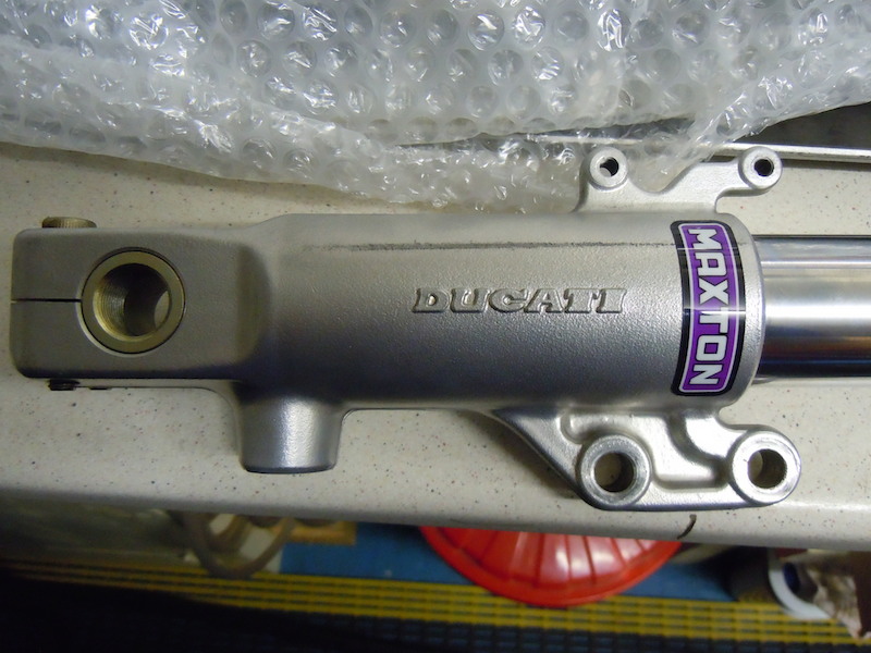

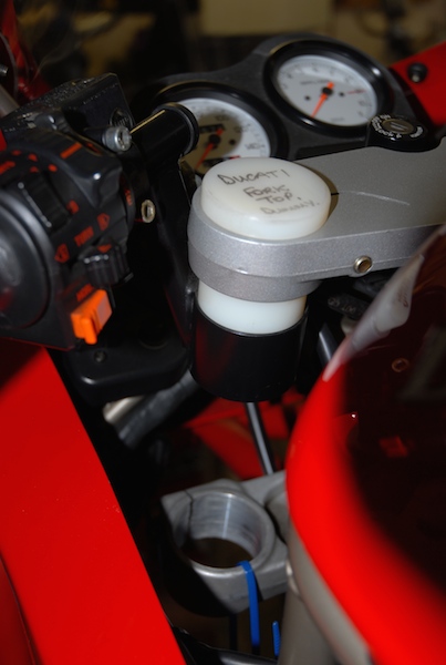

  9. Well, finally started the ball rolling & sent my forks into Maxton today for a bit of bling.

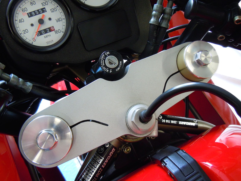

    Here's the "before",
    The "during",
    Just some dummies I machined out of a piece of delrin to hold the handlebars in place & keep the master cylinders upright.
    The "after" will follow in a few weeks, can't wait !:yum

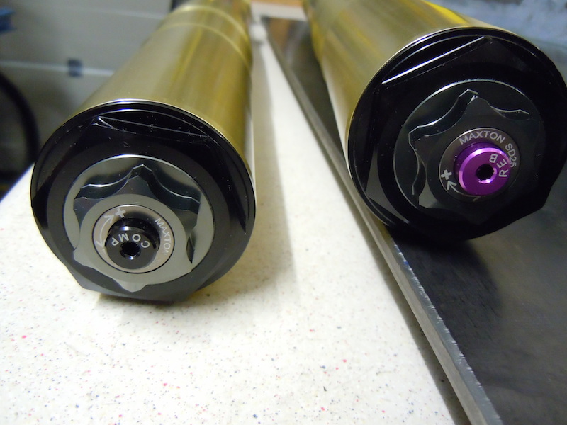

    The Maxtons will have adjustable pre-load on both legs, adjustable compression damping in one leg & adjustable re-bound damping in the other leg, plus the fork tops will look great in the standard anodised colours of Maxton, black & purple !:joy:

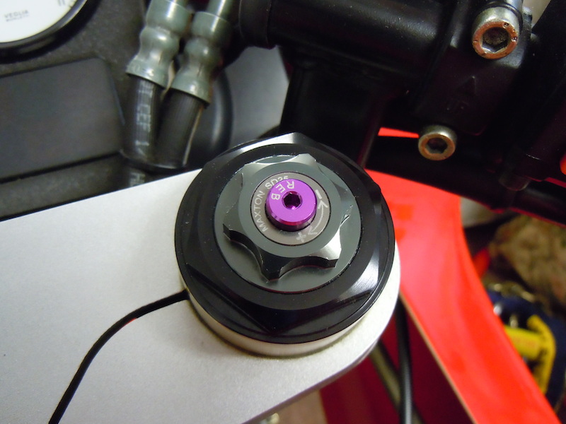

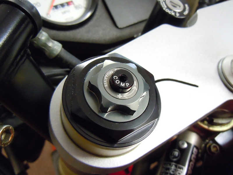

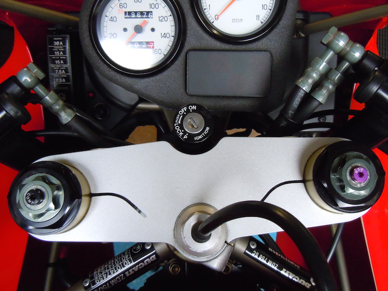

  15. Well, they're fitted now & the sag is set. Just need some warmer weather to go out & try them out & make any adjustments. Maxton also supply a special 3/8" drive socket to suit the spring pre-load adjusters on each leg.
    Interestingly each leg has a different oil in it. Maxton also supply all the base settings they have set my forks to, so when I go out to play I know where I'm starting from.
    Price was £1027 including the dreaded VAT.
