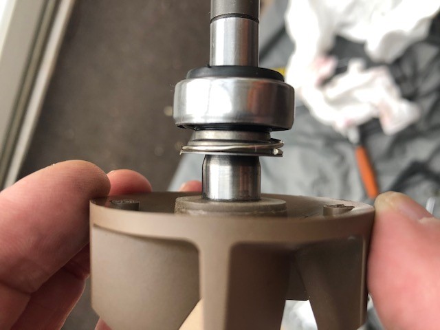

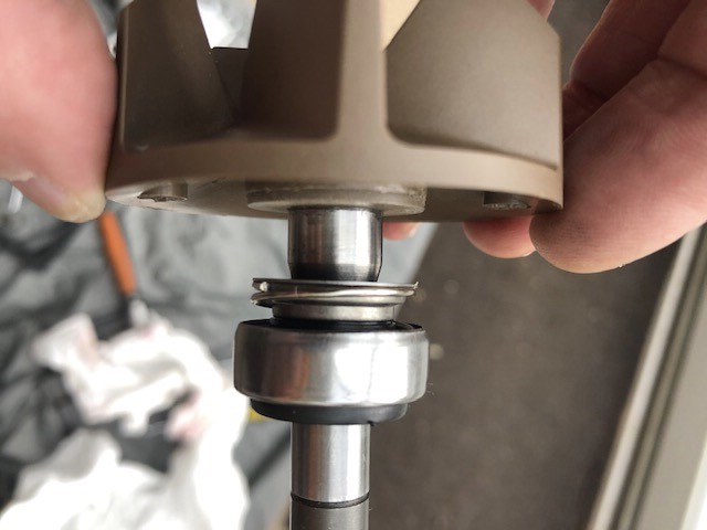

    Just in the process of re-building the water pump on a Ducati 748 mechanical seal.jpg and wanted to double check that i am inserting the mechanical seal in the correct direction before i fully push this home. Also i have read on afew other posts that you should put some sealant around the base, is this correct as it does not mention it in the manual.

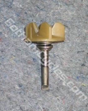

  2. This image is from the Gotham Cycles site
    compared to yours
  3. I did not want to press mine home against the impellor until i am 100% of the direction. The Gptham image is equally as confusing as it looks like the spring is against the impellor which is what i thought but the actual seal is different i.e. longer spring and shorter main body. The one i got was from Ducati not a paterned part.

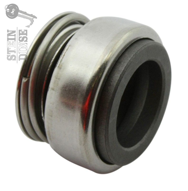

  4. Hopefully these pictures and numbers help:
    Mechanical seal 93050011A
    'Bush'/Seal (fits on the non impeller side)
    93050021A
    Spring faces the impeller.
    Not sure about the sealant. Not a fan myself. When you say 'manual' is that the factory manual or Haynes?
    Hope this helps and matches what you've got.
