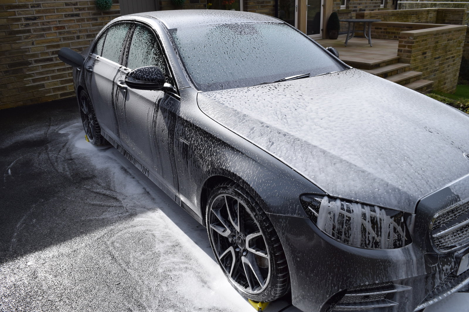

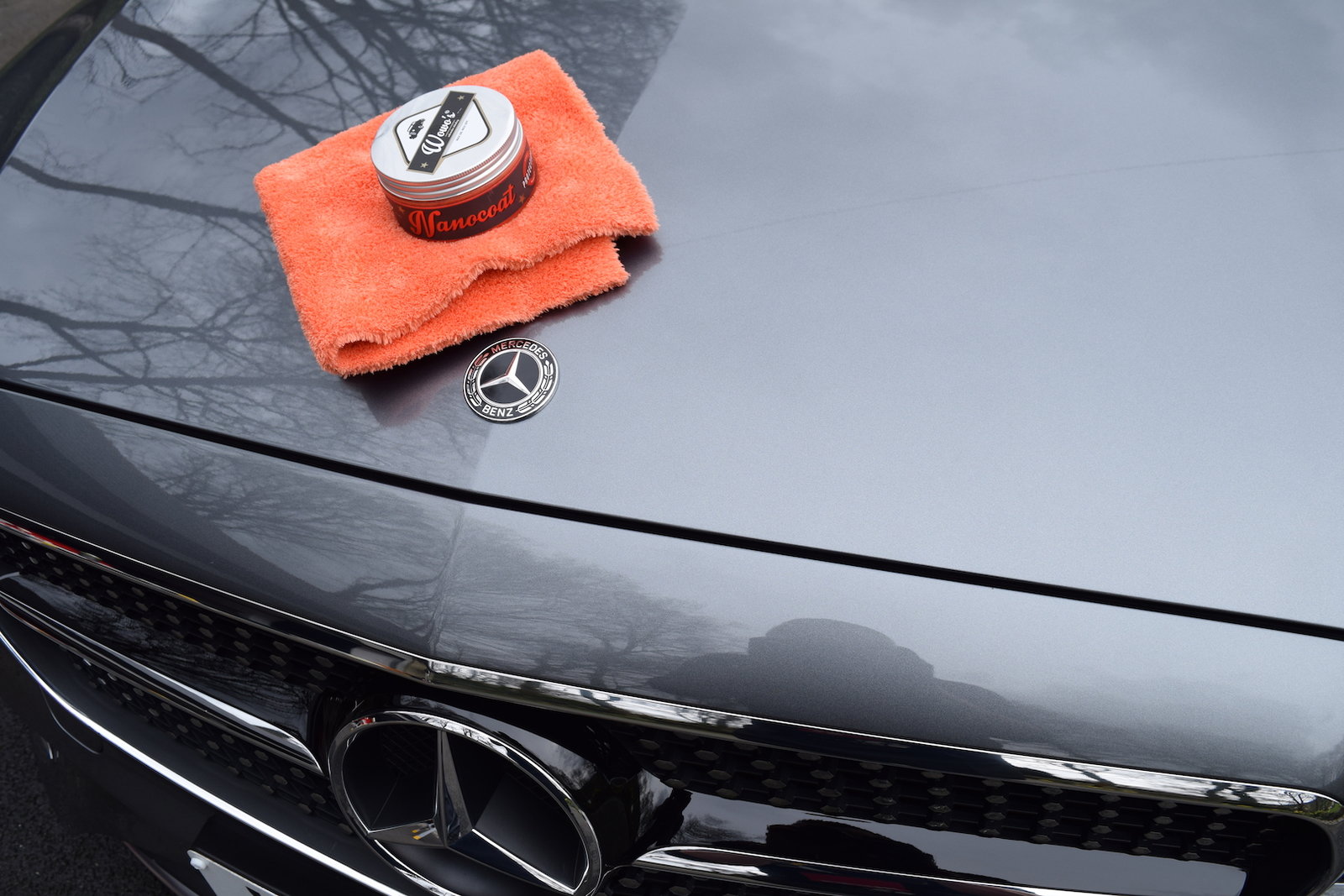

  1. I'm gonna keep this short just to keep certain people happy.....A mega vehicle to work upon....personally love the interior!!!....Interior received a full Gtechniq Tri-Clean cleanse prior to application of Gtechniq L1 Leather Guard and Gtechniq C6 Matt Dash - both with Biocoat Anti-bacterial...Carpets cleaned by hand using Britemax Interior Cleaner. Interior Glass cleaned with Angelwax Vision. And onto the outer.....Wheels attended to first as usual...arches and tyres degreased with Bilt hmaber Surfex HD diluted to 3:1....wheels pretreated to Angelwax Billberry wheel cleaner at 3:1...allowed to dwell for 5 mins then agitated with various Wheel Wollies & EZ brushes...faces cleaned with Pure Hogs hair brushes....all high pressure rinsed off. As usual the entire vehicle including the already clean wheels and arches covered in a blanket of AMAZING Bilt Hamber Auto foam and allowed to dwell for 10 mins to remove as much dirt and debris as posssible before contact washing. 3 bucket method - all dual grit guards and of course the finest Dooka wash pads and super super slick Gyeon Essence shampoo - only 15ml of this used in a 20 litre bucket and solution then thoroughly mixed with the aid of the pressure washer lance submerged in bucket.....once washed and pressure rinsed vehicle was subjected to a FULL chemical decontamination with Carpro TarX and Gtechniq W6 iron remover ( dissolving iron is indicated by the solution turning purple ). Vehicle then clayed including all exterior Glass with Superb TAC Systems clay cloth. Again Bilt Hamber Auto Foam bath to remove any traces of chemicals from the decontamination stage. force air dryed with Metro Vac Master Blaster - filtered warm air dryer. Gtechniq Panel wipe then applied to whole vehicle to get true indication of paint. As the paint was very good a single stage machine polish was used - once removed and panel wiped again then an application of truly superb Nanocoat....wheels received a spray sealant. Tyres further degreased with Gtechniq Panel wipe then an application of Gtechniq T1. Then home for a well deserved beer. Time taken 9 hours.....Customer once again ecstatic at the result.... not a short post I know but hey ho!!!
