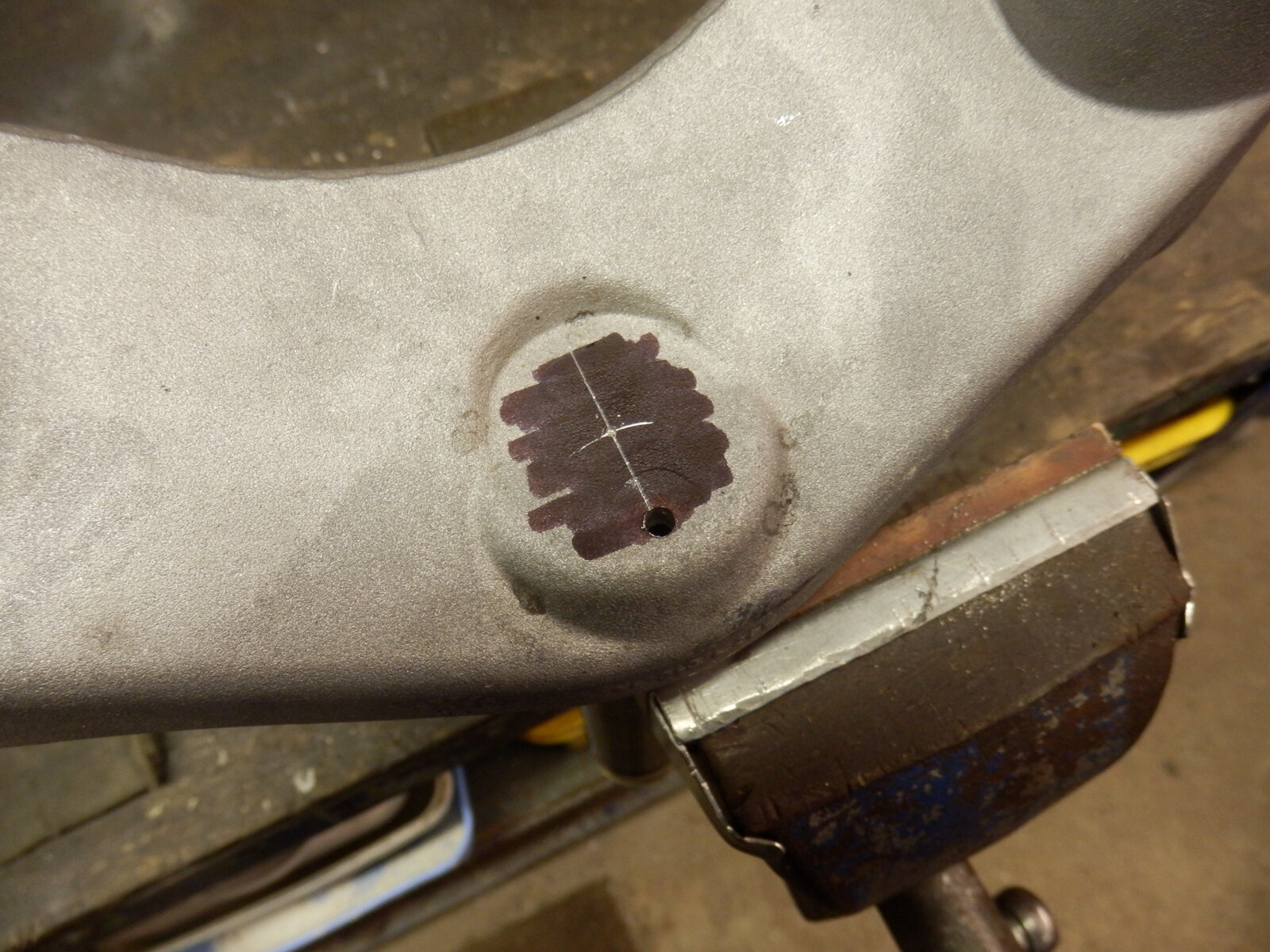

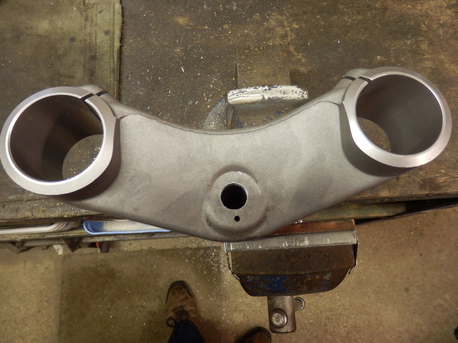

Chaps, Currently have the forks off the bike and about to be rebuilt by Steve Jordan. Whilst they're out of the way, wondering whether the lower clamps can be modified (drilled) to accept a front paddock stand, one that obviously lifts here rather than under the forks. Seeing as it's most of the way disassembled already... At present mine has just got a very small 'ole, about 4-5mm I'd say, certainly not large enough for an engagement pin on a paddock stand. Have decent machining facilities here in the workshop (i.e., I wouldn't be doing this with a handheld cordless drill!....proper 1970's vintage pillar drill straight from the brick privvy)...what I'm not sure about is whether the lower clamps that already have the right sized hole, are strengthened elsewhere to accommodate it? Were they thicker, or did they have strengthening webs? I've never seen them side by side. 2001 748R with the Ohlins FG850's....seems very random as to whether some bikes do have the bigger hole or not! Advice welcome, TIA. S

Did my 999 yoke only yesterday. I find an under-headstock paddock stand holds a bike far more stable than one that goes under the fork bottoms.
I drilled my 740 lower yoke too... Very handy when I was recommissioning the bike, including getting the forks out
