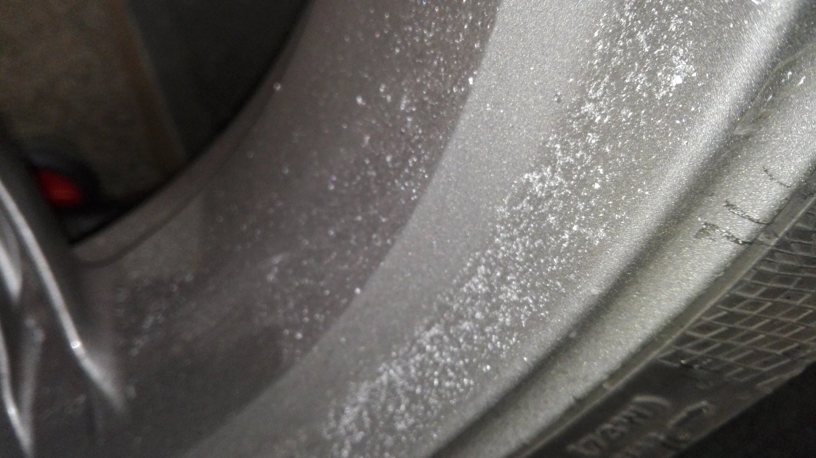

    Anyone seen this before?
    I noticed metal splitters on my rear wheel. After checking I saw that there are three metal rings from the rubbers attached to the rear chain wheel have come out and scrape the exentric tensioner :-/
    What's the problem here? Why do they come out? To old, time to change I suppose..?

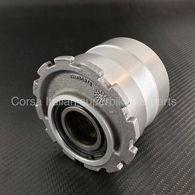

  2. Looks like your cush drive rubbers have perished and backed out catching on your eccentric hub adjuster. A Renthal sprocket carrier will stop this happening as it has a lip on the rear to prevent them from backing out.

  4. As above, a common problem and it can result in a new hub eccentric. A quick change sprocket carrier will prevent it happening again but in the mean time you will need to look at replacing the cush drive rubbers and also examining the damage to the hub. This may necessitate a new hub if it is really bad.

  6. Djeez I don't realy know if the damage isn't to bad.
    Don't think so...
    Here are some pics.
  7. I've seen worse. It hasn't gone all the way through and milled the swing arm. There looks to be sufficient thickness remaining to allow you to adjust the eccentric.
    • Agree Agree x 4

  14. Could have been a lot worse. I picked up an afam sprocket carrier for a decent price 2nd hand just to avoid this.
