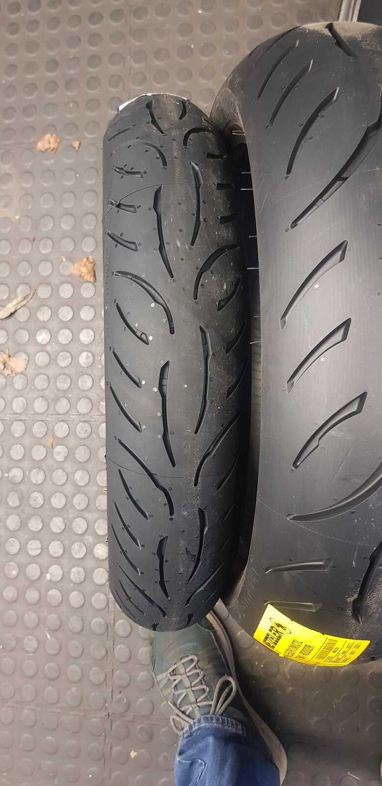

  4. I currently have a pair of M7RR’s on a 1200 Multistrada and comparing the pictures I took of the 02’s today with the bike in my dining room, the rear is very different, the front less so but different nevertheless. The profile of the 02 is very similar to the 01SE. Andy

    They do look closer to the M7 tread pattern than the 01’s. I’d be interested to know how the profiles of the fronts differ M7/9 compared to the 02’s.

  12. The profile of the Roadtec 02 rear looks (and rides) the same as the 01SE, it is definitely not an M7RR (which is my all time favourite scratching tyre). Andy

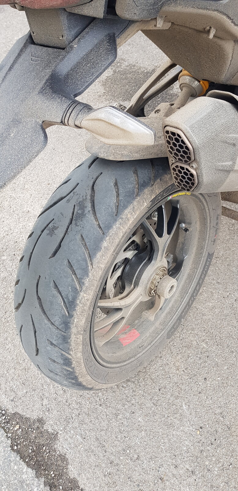

  16. Had a spirited run out with a bunch of late middle aged hooligans this morning. About 100 miles over some appalling single track roads covered in sh*t and pretty sketchy conditions. There is no doubt in my mind, the Roadtec 02 is a brilliant tyre for me and my riding style. Quick to warm up, predictable and linear. Andy
  17. Happy with this :D Andy
