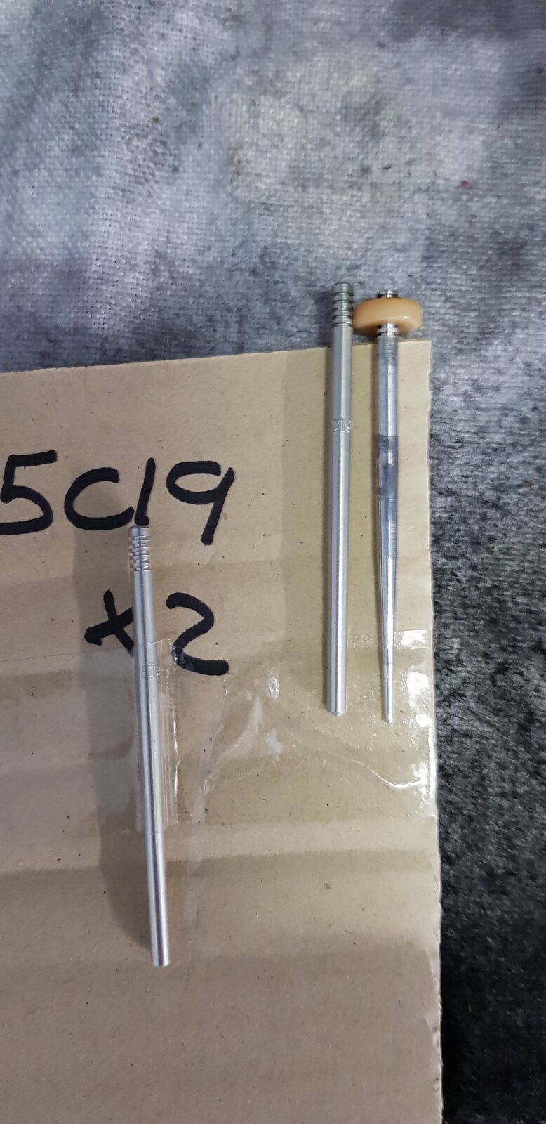

  1. Hi all. Calling out to carburettor experts! I'm rebuilding my BDSTs and ordered some new needles from Allens. According to Haynes I needed 5c19s. However they are quite different to what are currently in the bike. They have much less taper. They do fit snugly in the emulsion tubes whereas the current needles are a rattling fit. Does this mean current needles are worn or incorrect? The reason why I stripped the carbs is that the bike would not pull at high revs. Felt strangled at the top end. Many thanks for any help.
  2. Your old ones look like DynoJet needles?
  3. The 5C19 are the stock Mikuni needles.
    If there is no size marked on the thinner needle it is a Dynojet kit needle.
    It will help if you post a photo of the spring to confirm it is a Dynojet kit.
    Dynojet will replace their needles FOC if they are worn and if you send them to Dynojet but you will need to know which kit is fitted.....the main jet size will tell you that....or I will. ;)
    NB. You cannot mix and match needles etc from a Dynojet kit with the stock Mikuni items. They are calibrated using different methods.

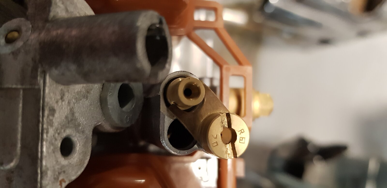

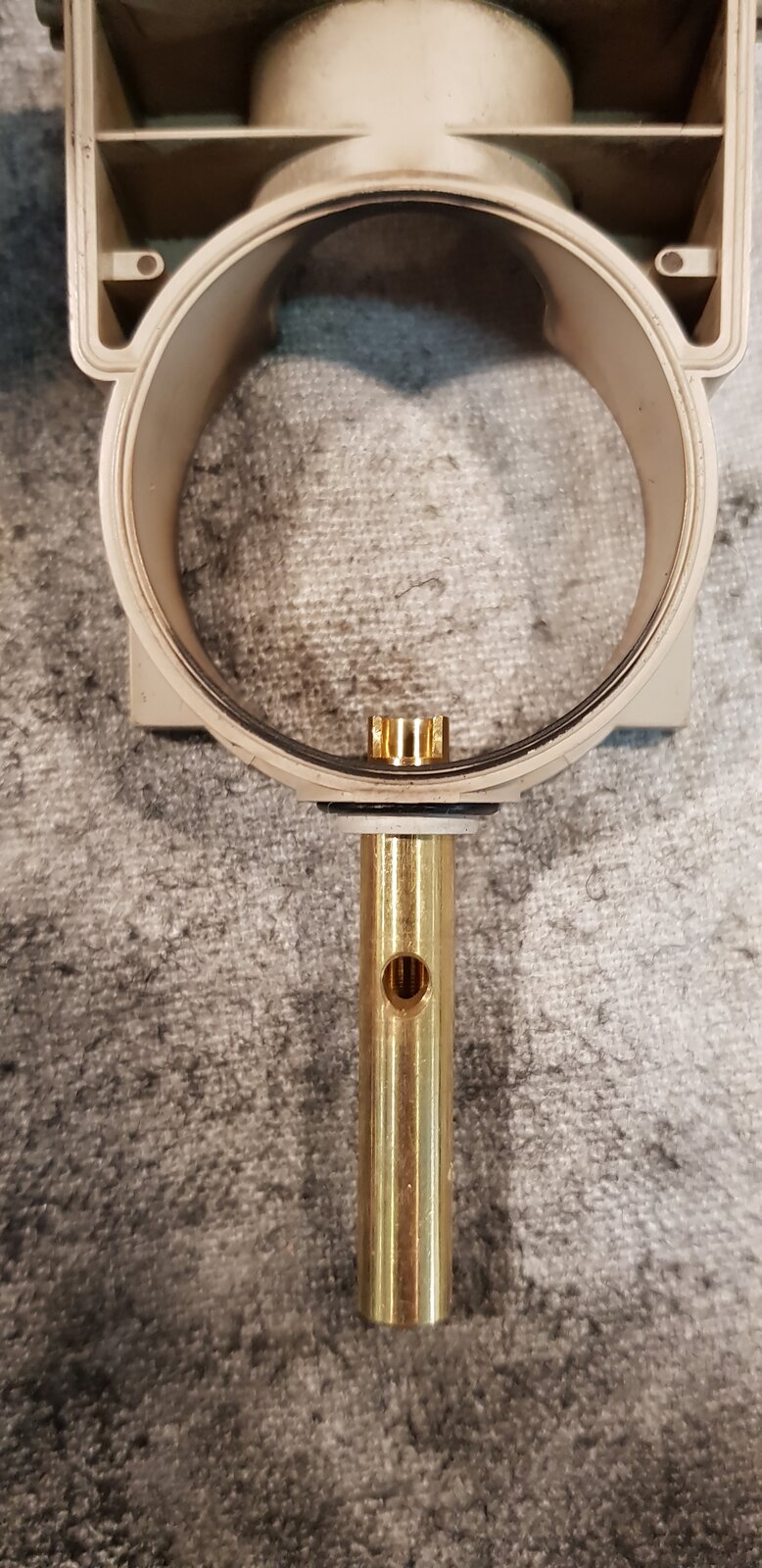

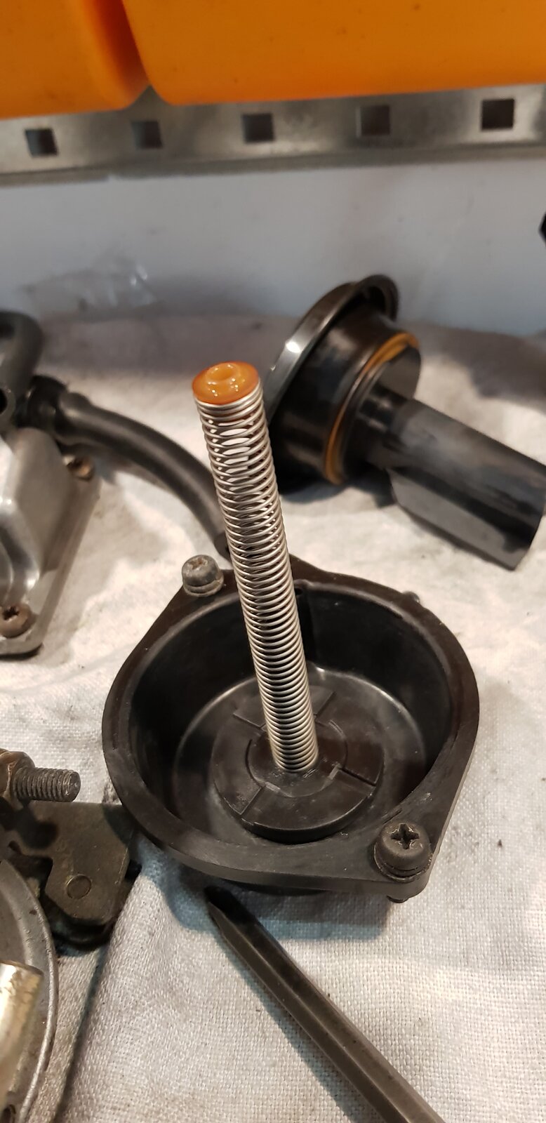

  4. Thanks Arquebus. Most helpful. Attached a picture of spring, main jet and emulsion tube. Looking at dynojet kits online they dont seem to include an emulsion tube so I presume the standard one is used? The needle profile looks the same as dynojet so I'm sure you're correct. The bike had got a k and n filter and a cut off airbox top.
    Is the staining on the needle an issue?
  5. The emulsion tubes used with Dynojet kits are normally the stock Mikuni ones....if the hole (not the one in the side) is round they are probably OK, if it is oval, near the top in particular, change them.
    However, the big jet you show in your photo isn't the main jet....that is the starter jet which is a Mikuni one (note the square logo).
    The main jet is the one held under the forks of that small plate.

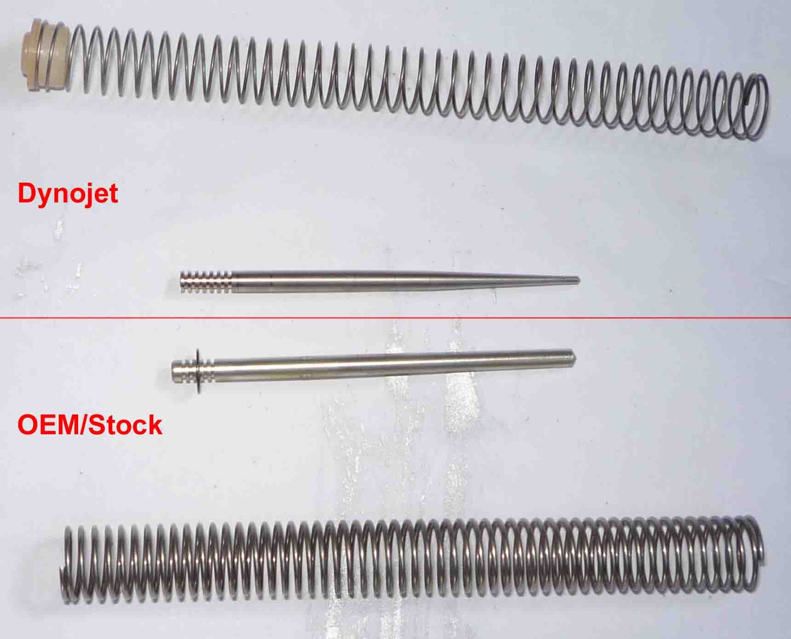

    It would be helpful if you could lay the spring down by the needles so I can get a proper look at the coils because the angle you have it in your photo certainly makes it look like a stock Mikuni one.
    Here is a comparison photo which you can use to judge for yourself....
    The fact that your airbox lid is cut about or missing suggests you may have an Stage 2 Dynojet kit fitted.....depends if your exhaust cans are straight through.
    But I am beginning to think you have a part Dynojet kit fitted, which is why the main jet will be useful to see.....no logo on it, only a size.

  6. Blummin' heck...sterling service mate!
    My spring is definitely stock. Tight coils.

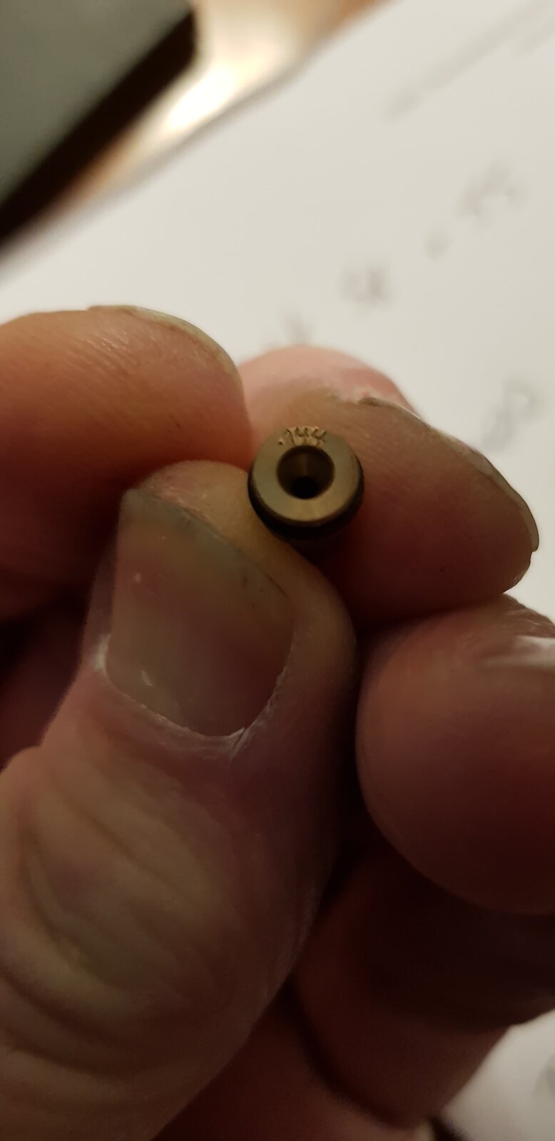

    Main jet is 144.
  7. No logo, so given you have Dynojet needles it is most likely a Dynojet one...which at that size it would be from a Stage 2 kit.

  12. Ziff....don't make the mistake thinking that the Dynojet 144 is only a bit bigger than the Mikuni stock 140.
    Dynojets are measured/calibrated in a completely different way to Mikuni.
    Apparently one is measured by the hole diameter; the other by flow rate; however it seems that the chamfer around the hole also affects things.
    In fact, the 144 might be smaller than the 140 or a lot bigger.
