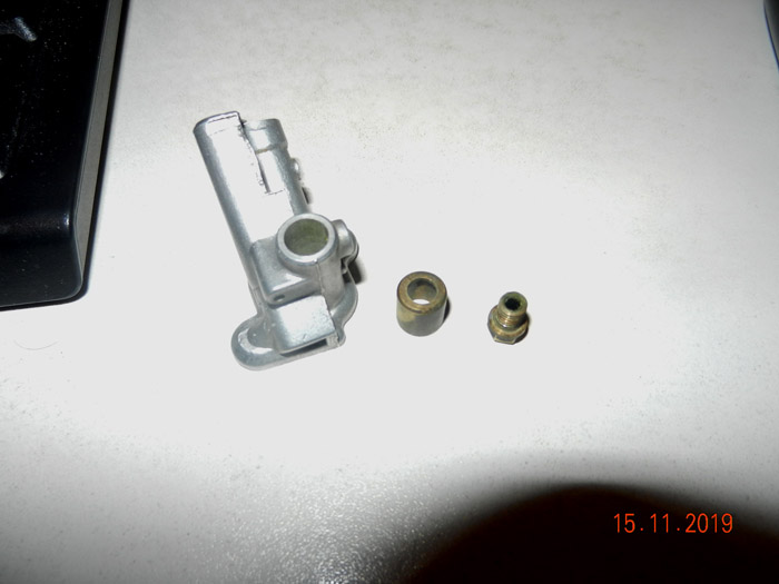

  1. I'm doing a full stripdown and clean of my standard 900SS Mikuni carbs, (BDST 38 - B67). All is now cleanish but O rings etc were knackered or perished so will be replaced, also I'll replace the main and pilot jets and their o-rings.
    However, the brass bolt holding down one jet block was broken (snapped inside the emulsion tube, but I got it out ok) meaning one jet block wasn't held down tightly (!!). Bit odd but there you go.
    First question: to hold down the jet block is there any reason why I cant use some other screw or bolt with the same thread rather than the original Mikuni part which was hollow?

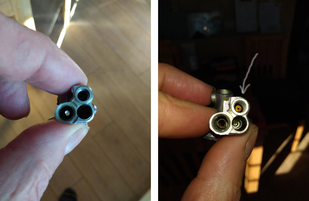

    Next question: what is the thing inside the jet block under the 'pilot' jet? in the attached picture? Can it be removed to be cleaned because I think it might be clogged up (not absolutely sure).
    Thanks for any help, carbs are not really my thing and the terminology appears designed to confuse - one time it's a pilot jet, then it's called an idler jet, then something else is a 'jet needle' as opposed to a 'needle jet'. Ridiculous, pass the nurofen Jet block.jpg
  2. Pilot/Idle jet.......probably marked 42.5. Should have a screwdriver slot....is that an O-ring in there? Shouldn't be.
    Needle jet would be 'emulsion tube' .....the brass bit the main needle (jet needle) slides into.

  8. Thanks for the repiles, and apologies because I made a mistake right from the off, in my first photo it's the thing beneath the 'choke jet' (Mikuni R70) in the jet block which I wondered about, not under the pilot or main jets. By the way all my jets are standard according to the spec sheets I've seen, no mods.

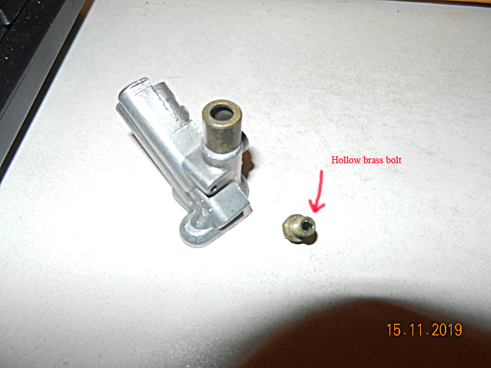

    The brass bolt which holds down the jet block and screws into the emulsion tube is hollow - is it hollow so the tip of the needle can go into it, which means I cant use any old small bolt with the same thread?
    Thanks again

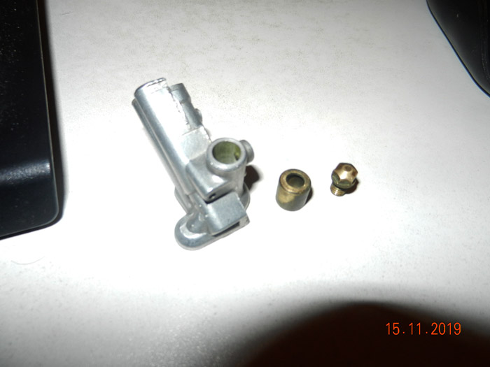

  9. Here are a couple more pics of the hollow brass 'bolt' in question, (one of mine snapped which is why I'm interested in it).

  16. Thanks for the feedback guys, I now know I need the correct brass 'screw' to hold down the jet block and not just any old thing with the same thread. I found one online (see pic) - the Yamaha TDM850 uses the same Mikunis so that made it easier to find. The 'mystery' thing located below the choke jet in the jet block which I asked about when starting this thread doesn't seem to be removable but I've managed to unblock the passage with a bristle from a plastic brush so good news there. All jets and mixture screws, even the air ones, came out no bother thankfully. Cheers Pete

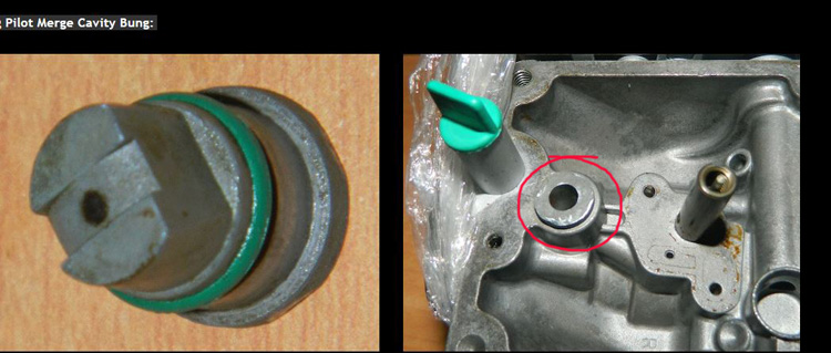

    AL, when you said "........there is a gallery in the carb body with very tiny fuel ways, which you can't really get into.......some people are brave enough to lever out the gallery plug to get in there, but they usually end up getting another carb body", did you mean this thing in the attached photo (referred to as a "pilot merge cavity bung")?
    I have a new o-ring for this on order along with the gasket and o-ring service kit but I haven't tried to remove it yet and it seems very tight.
    Cheers Pete
  20. That is the plug I mean.....a lot of damage can be caused trying to get that out....
