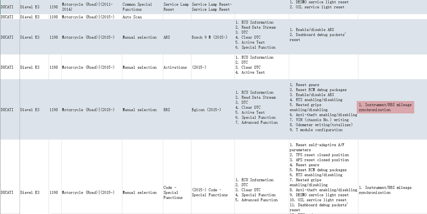

  2. Gen1 being the 1198 E3 model, correct? Somebody with a OBDStar unit local to you should be able to help. According to the capability spreadsheet it can do milage sync between the BBS and the instrument cluster.
  3. That is correct. Yes. Thanks for the information

  6. When you say the mileage is way out is it higher or lower than that which is actually incurred ?
    Just be aware that when the mileage count is synced by a diagnostic device (it’s stored in both the dash and the BBS) it will always sync to the higher value.
    Also, it really shouldn’t be too expensive for a dealer to do it as it is a quick job but they may charge for a minimum of 30 mins labour, best to phone around.

  8. The mileage in the BBS will be updated to 24,000 too if you go through the procedure. You may be better off leaving the BBS as a reflection of the true mileage and just live with the displayed mileage, plus, course, some documentary evidence of the dash change come resale time.
