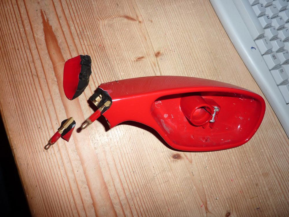

  4. Here's a pic of a broken one - you can see how the screw tightens the mirror into the socket;
  5. The screw is a Philips head unless it is a much newer mirror as per 998's as some of these used a torx screw of the same size as the fairing screen screws.
  6. be careful not to overtighten the clamp screw on replacement as they can strip - sometimes more so if someone has been there before.
