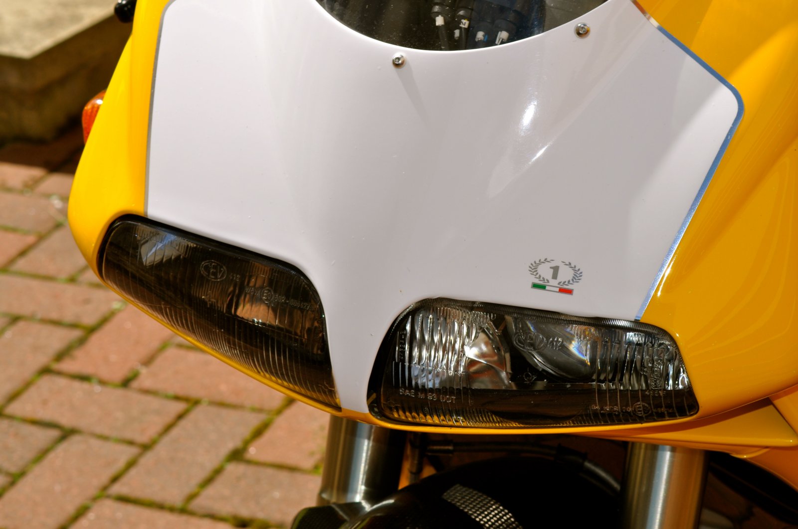

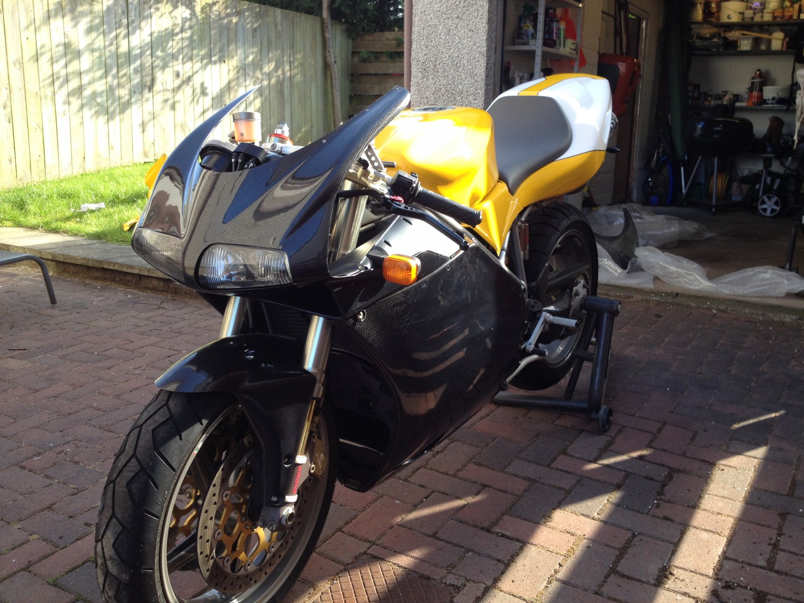

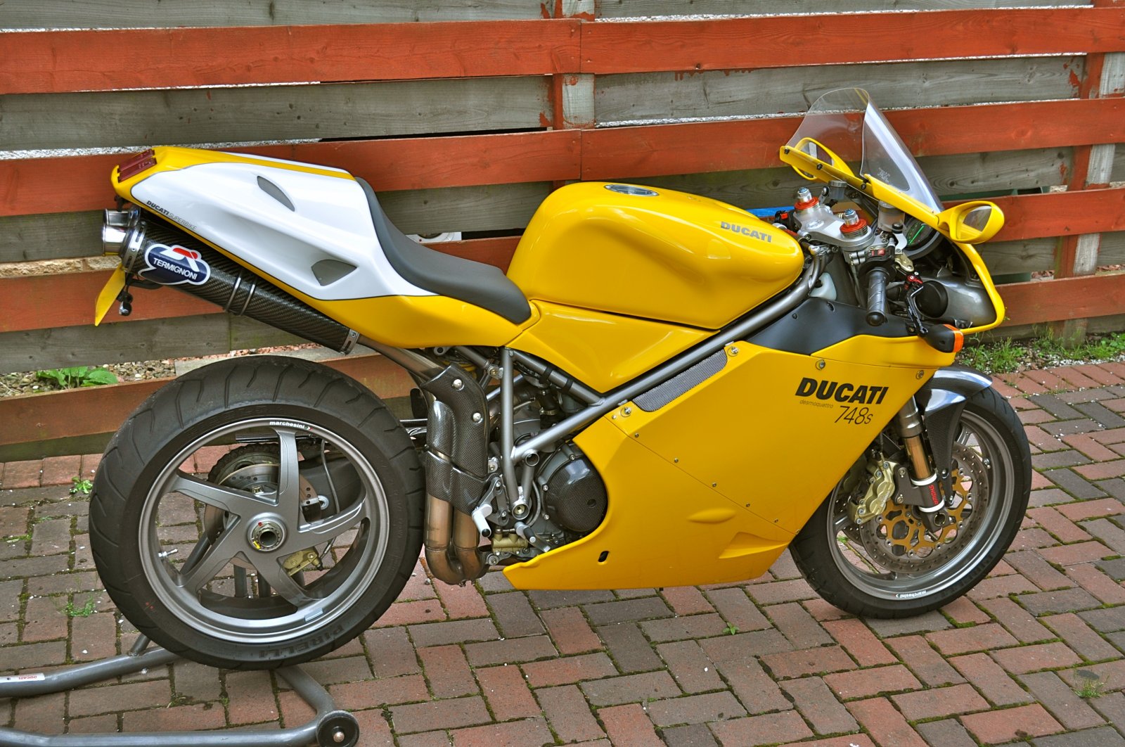

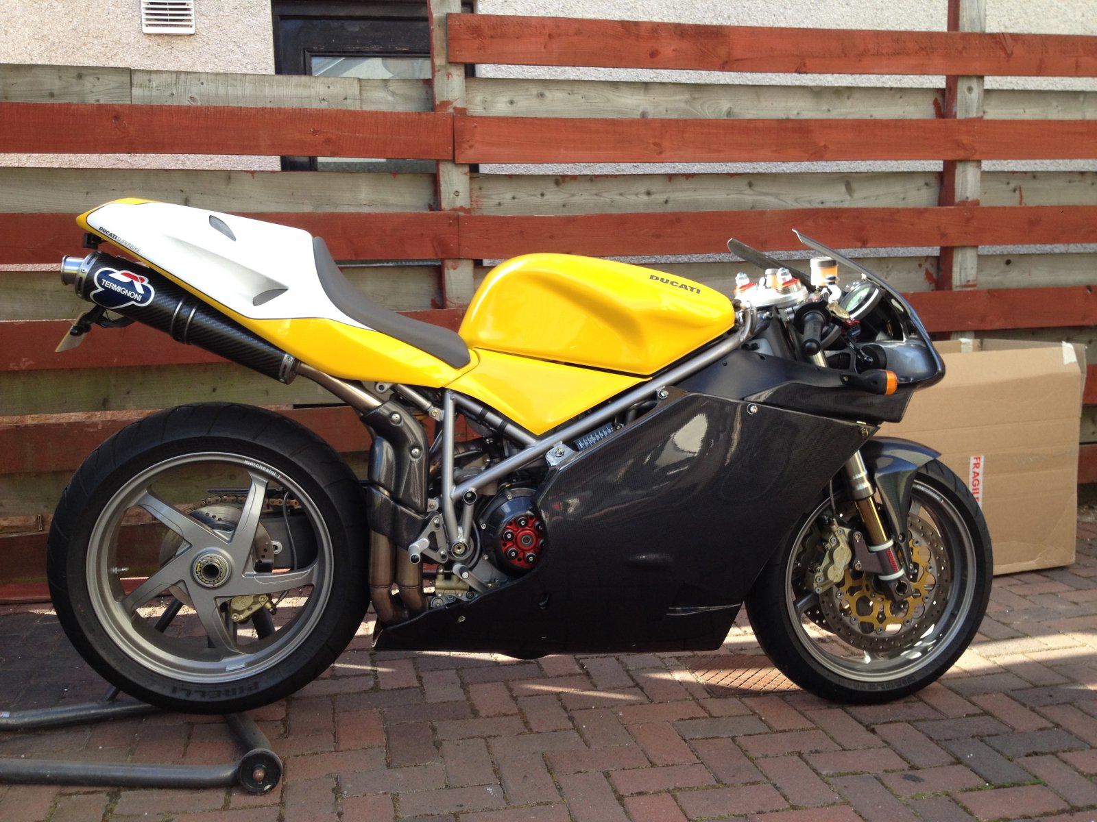

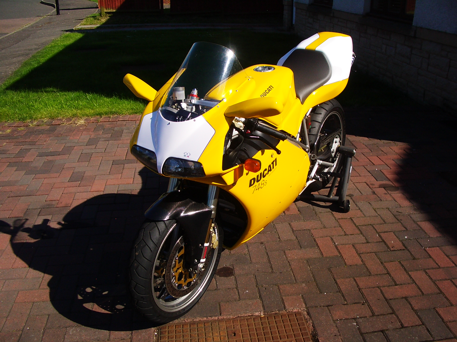

  10. could've just been my bad luck. First time I cleaned the inside of the lenses, it fogged up again within weeks. I'd just used some washing up liquid and a bendy bristled brush... I wasn't best pleased. A friend with a 998 suggested I use meths, but to be careful and it's worked a treat:
    First pic is from 2004, the second from 2011 and last from 2014.
    Last time I saw the S, they were just the same! Spotless.
    I'm sure there are many ways to clean them. This just worked really well for me, so figured I share the info.
    Cheers

  12. ahh, @Bullitt , you failed to notice that the meths has turned your fairings black! Still, got to be better than the yellow ;-)
  13. haha, I know - best not tell all those that their yellow bike can be turned black with liquid!!! :tearsofjoy:
  14. It's worse than that Jim, his screens completely evaporated :Wideyed: :D
  15. I think it looks fantastic in yellow!
  16. Frankly, I love the yellow. One day the carbon will be yellow too ;-)
