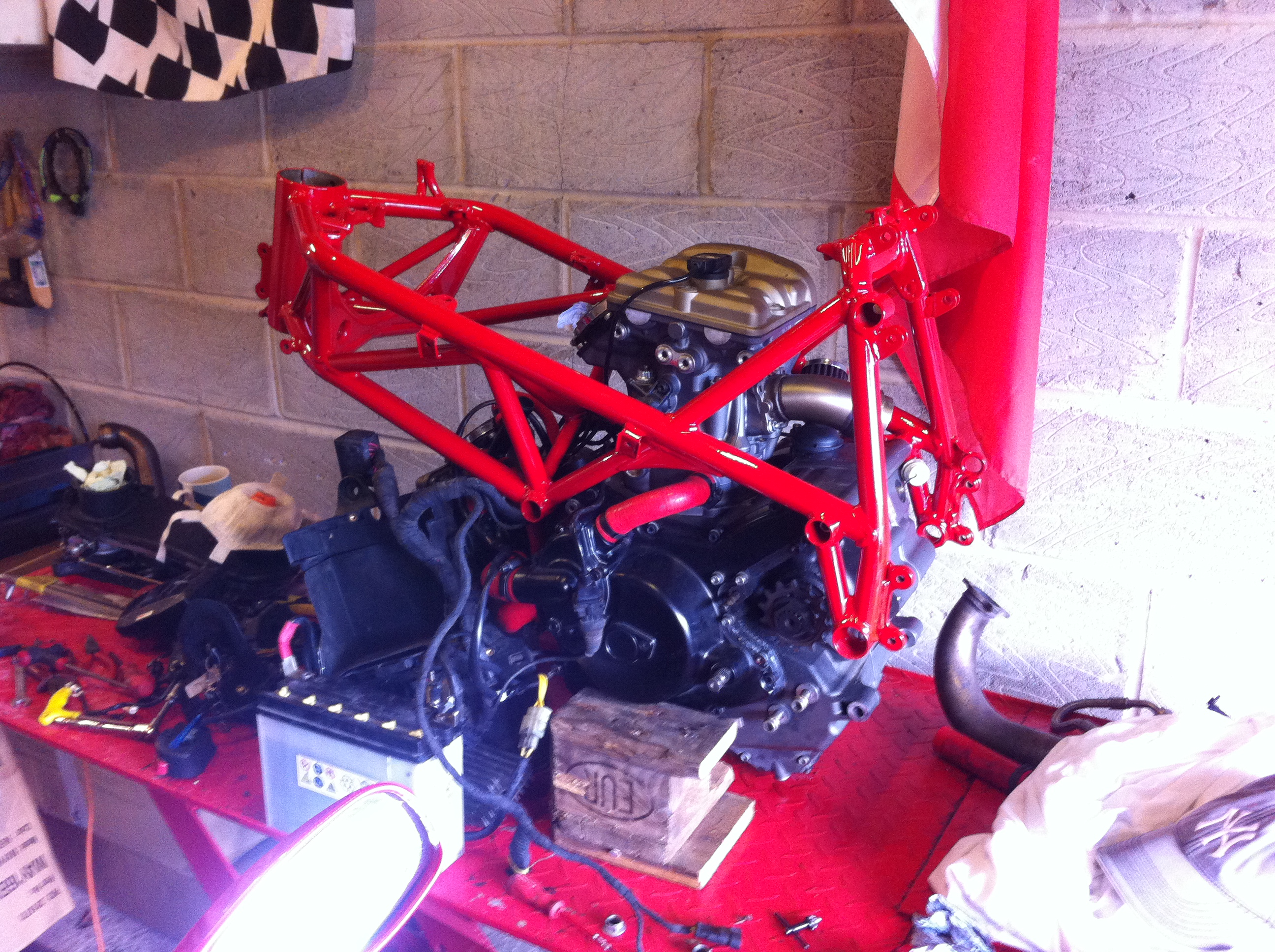

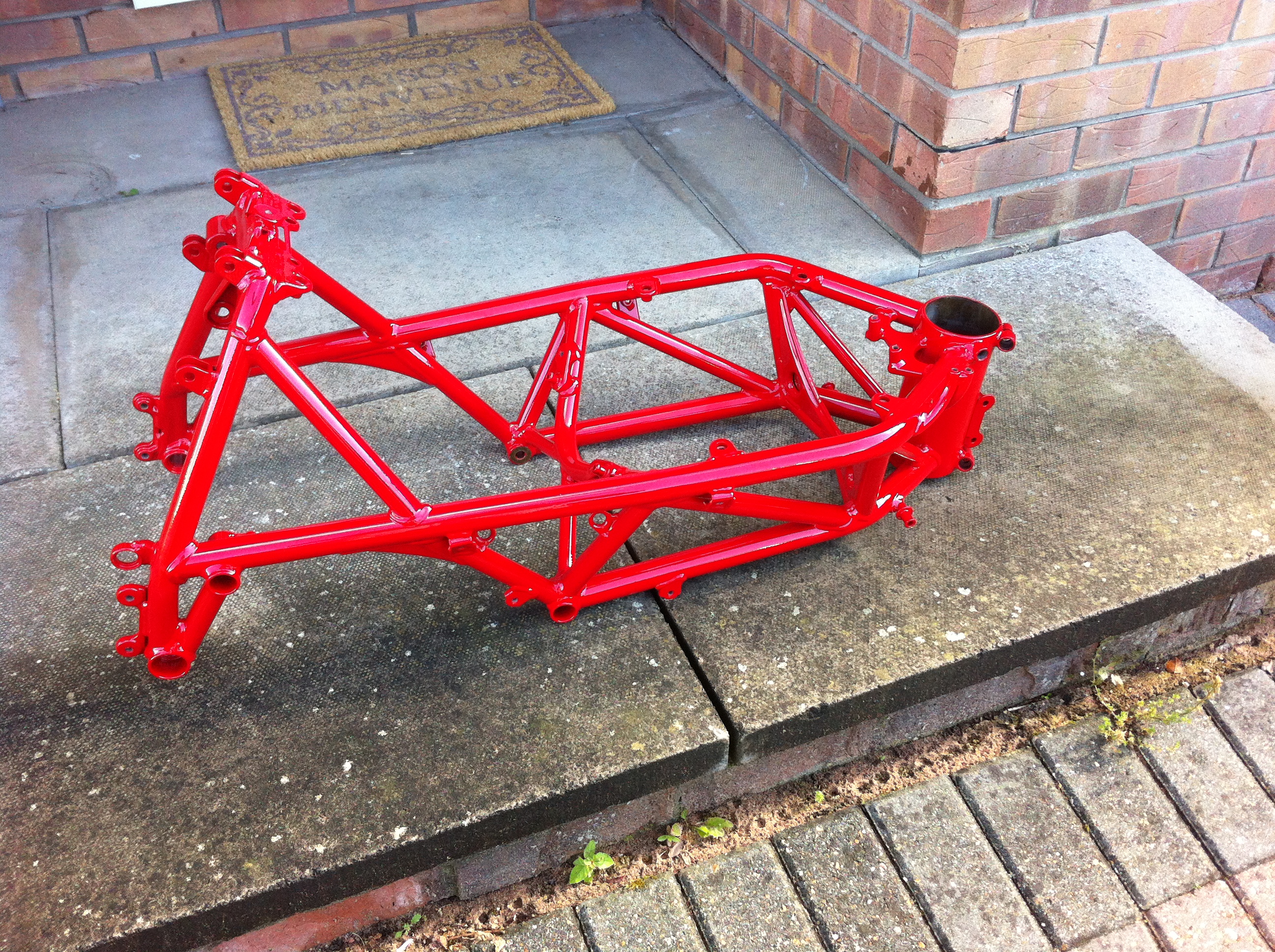

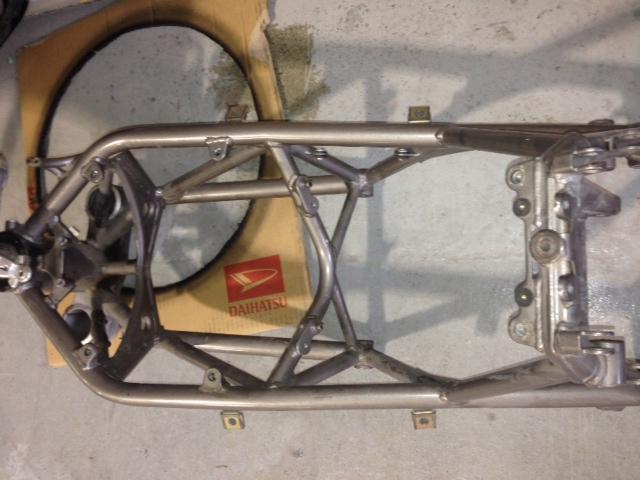

    Earlier this year I was lucky enough to pick up a nice 748R frame and V5.
    Which is presently at the powder coaters being painted red (hopefully not too orange!)
    Last week I took delivery of this very nice 1098SF engine with a rather saucy STM slipper attached as well as some very gay hoses! I shan't tell Mr Chizel what I paid for it ;)

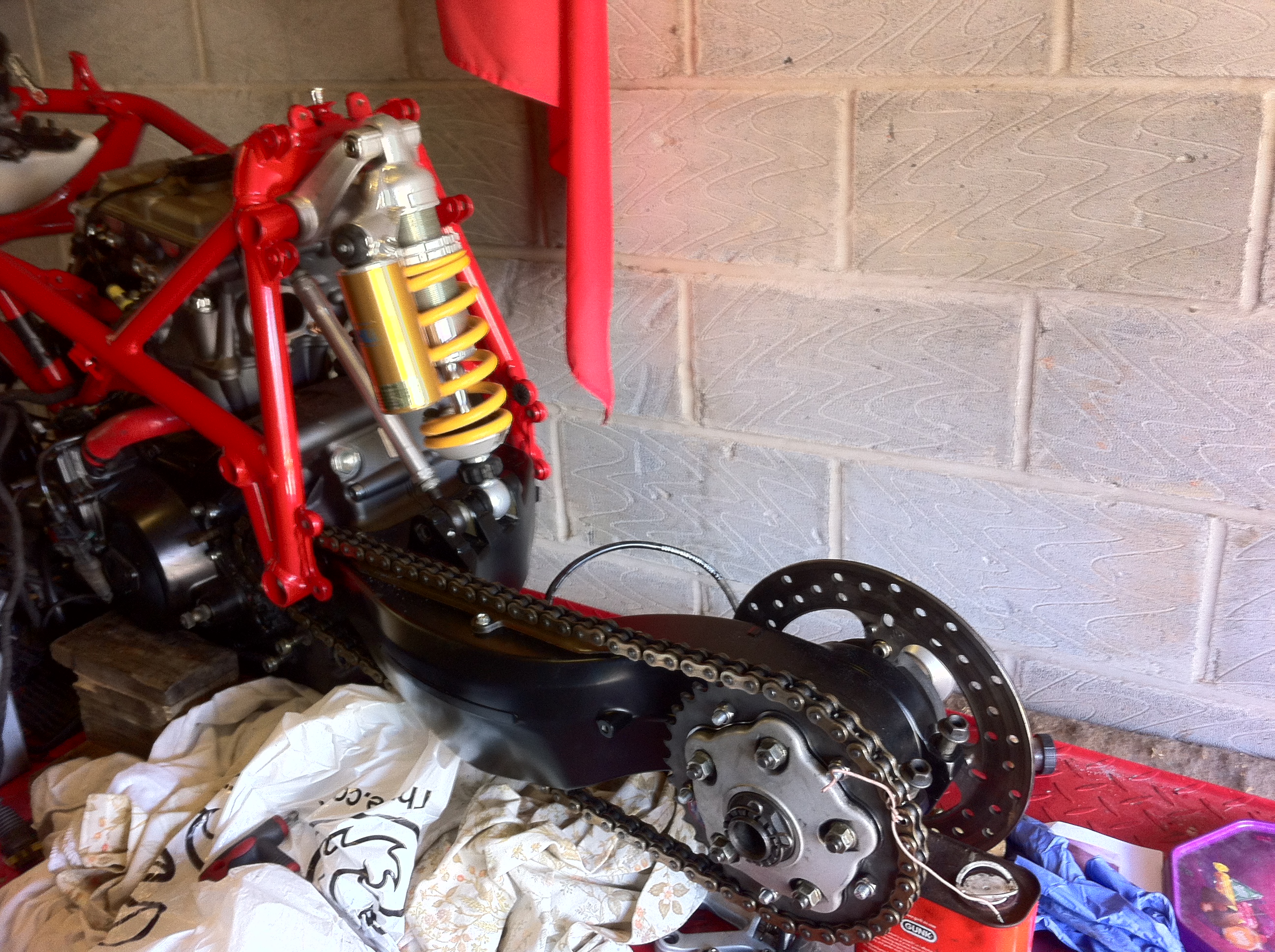

    I'm keeping the 916 swinger, but adding a 1098 disc bracket with speedo sensor 'ole, disc and caliper.
    Trial fitted the loom, dash and ecu at the weekend and she fired right up on the bench...BOOM...!!!
    ChrisW is sorting out a better ecu for me...Top Dude...:upyeah:

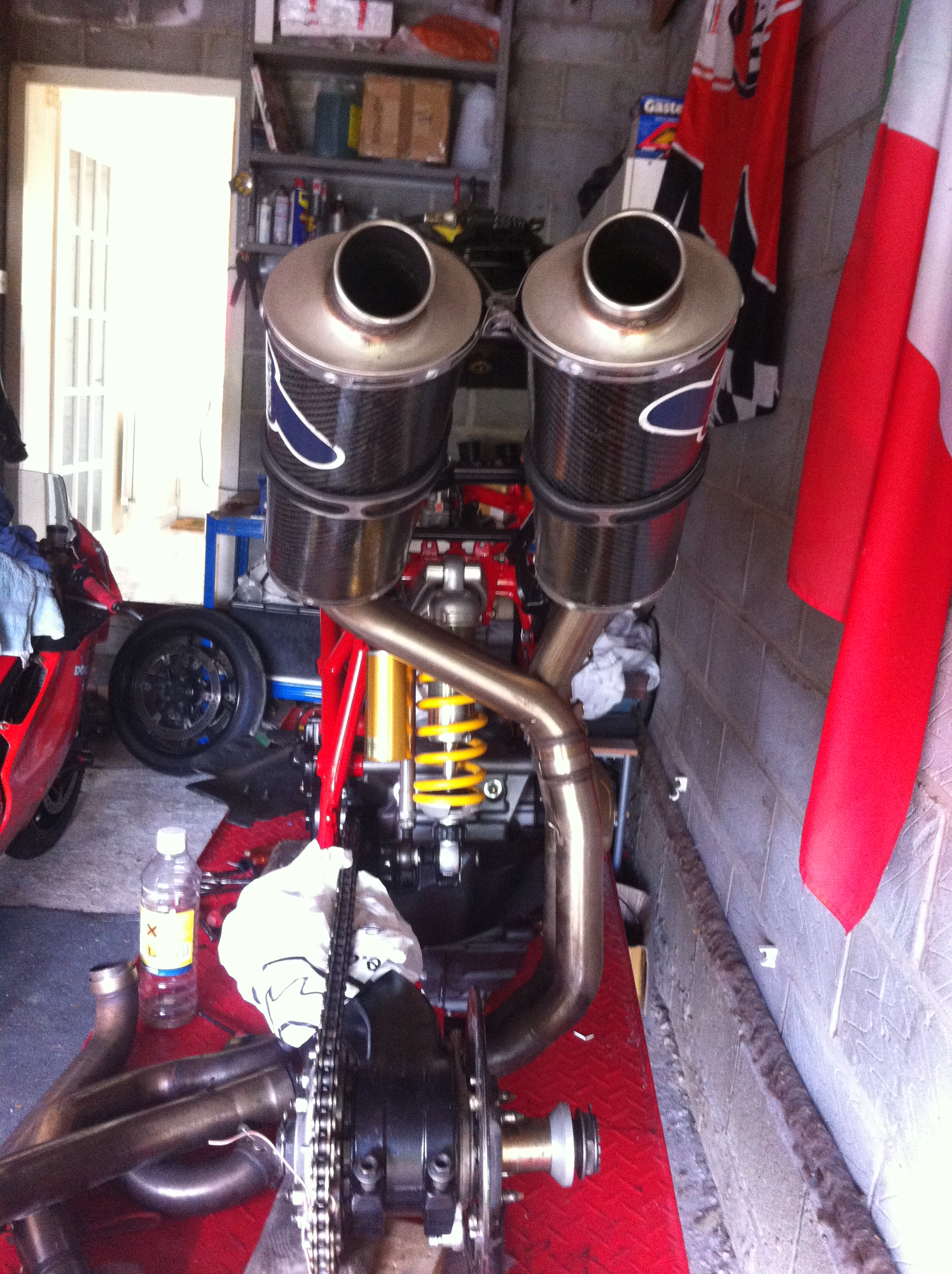

    I have a full 50mm system to go on, but it will need work!
    This one when finished will be 916 lookie like and be my road bike.

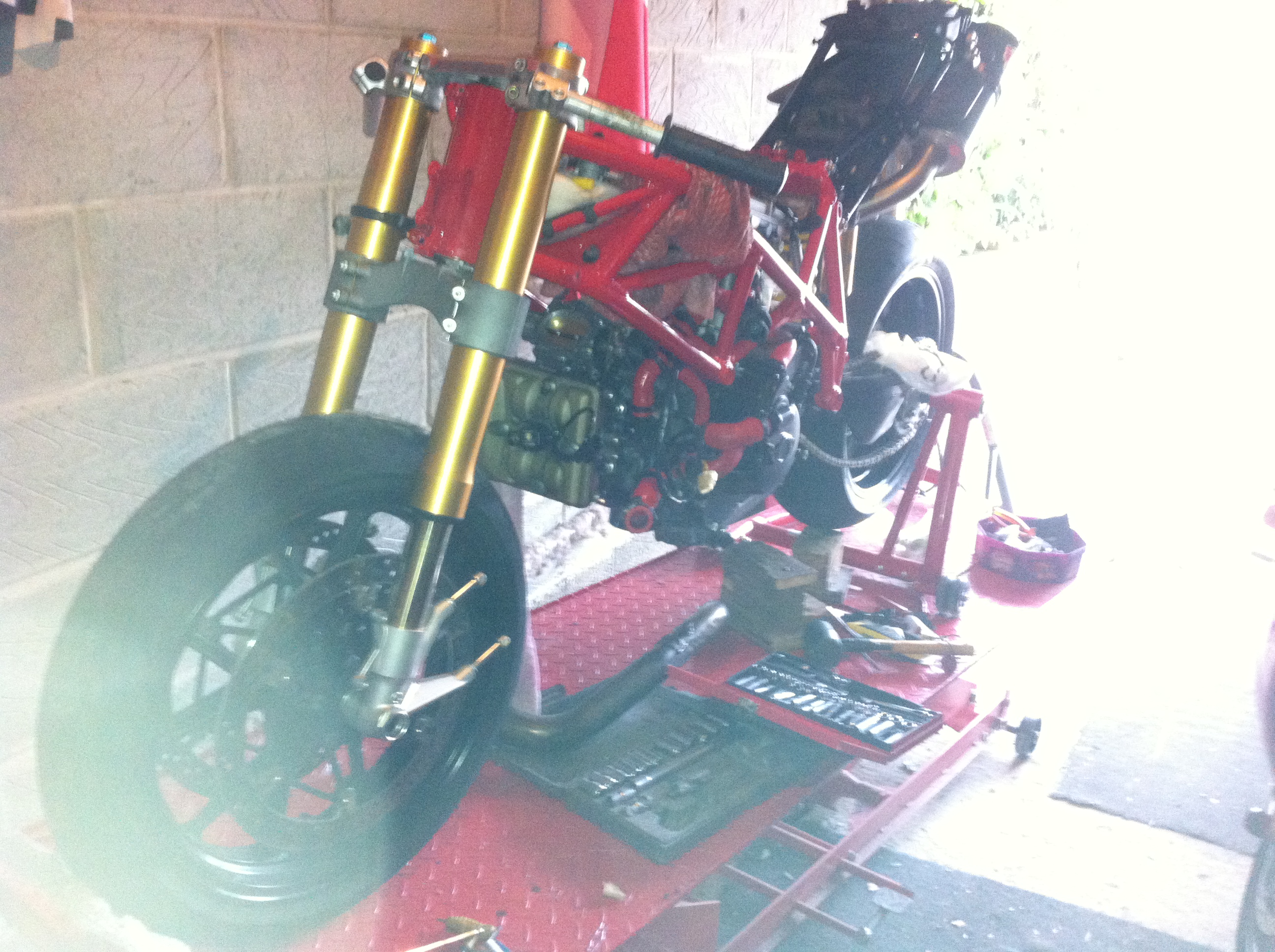

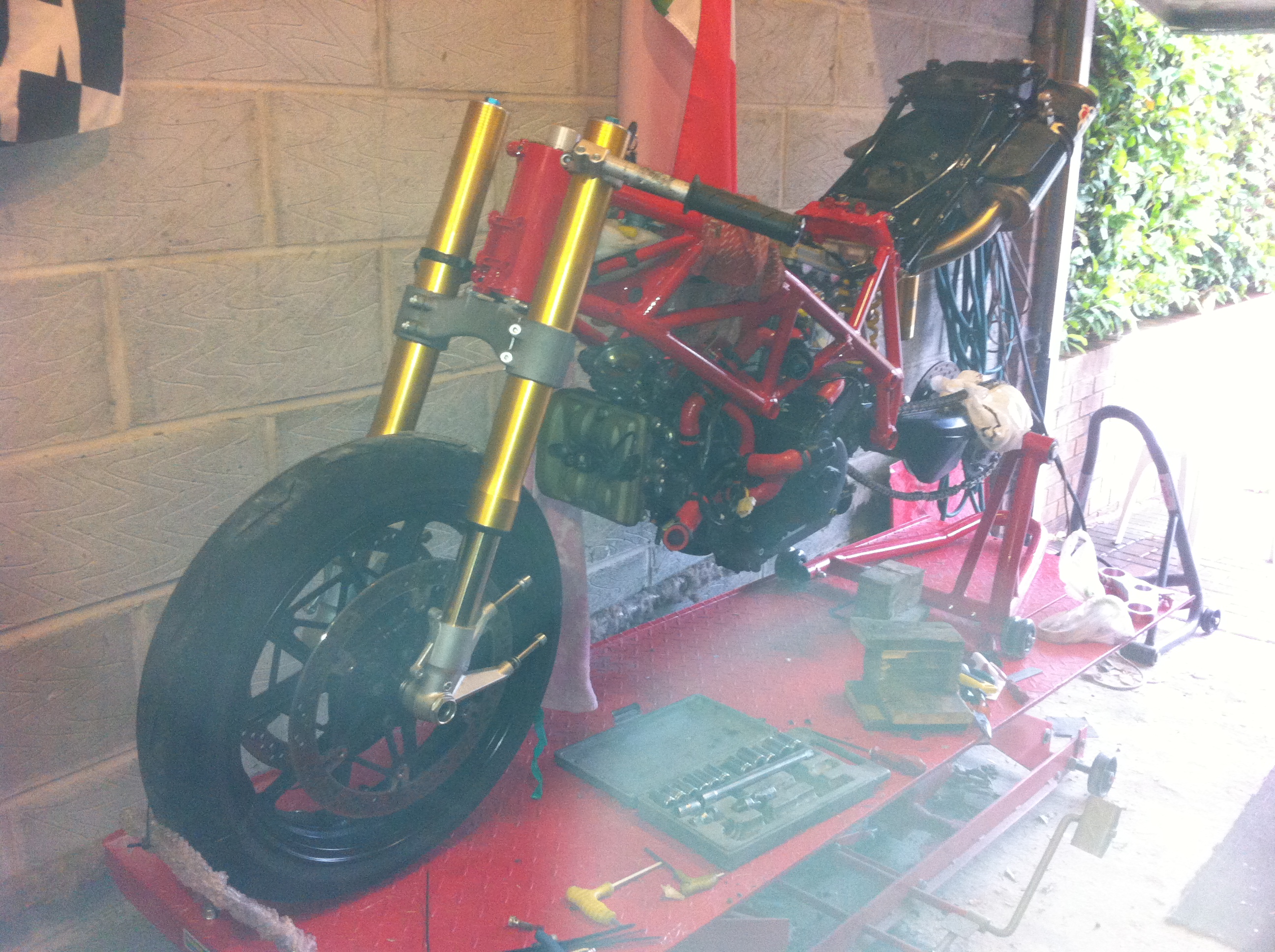

  8. Bit more prog' today...Added swinger and 848 brake bits and bobbins....:D
  9. Dunno, table came that colour...;)

  14. Fookin luv this part!
    Pile of parts gets small as bike gets big!
  15. You're getting pretty good at this Nelson. :upyeah:

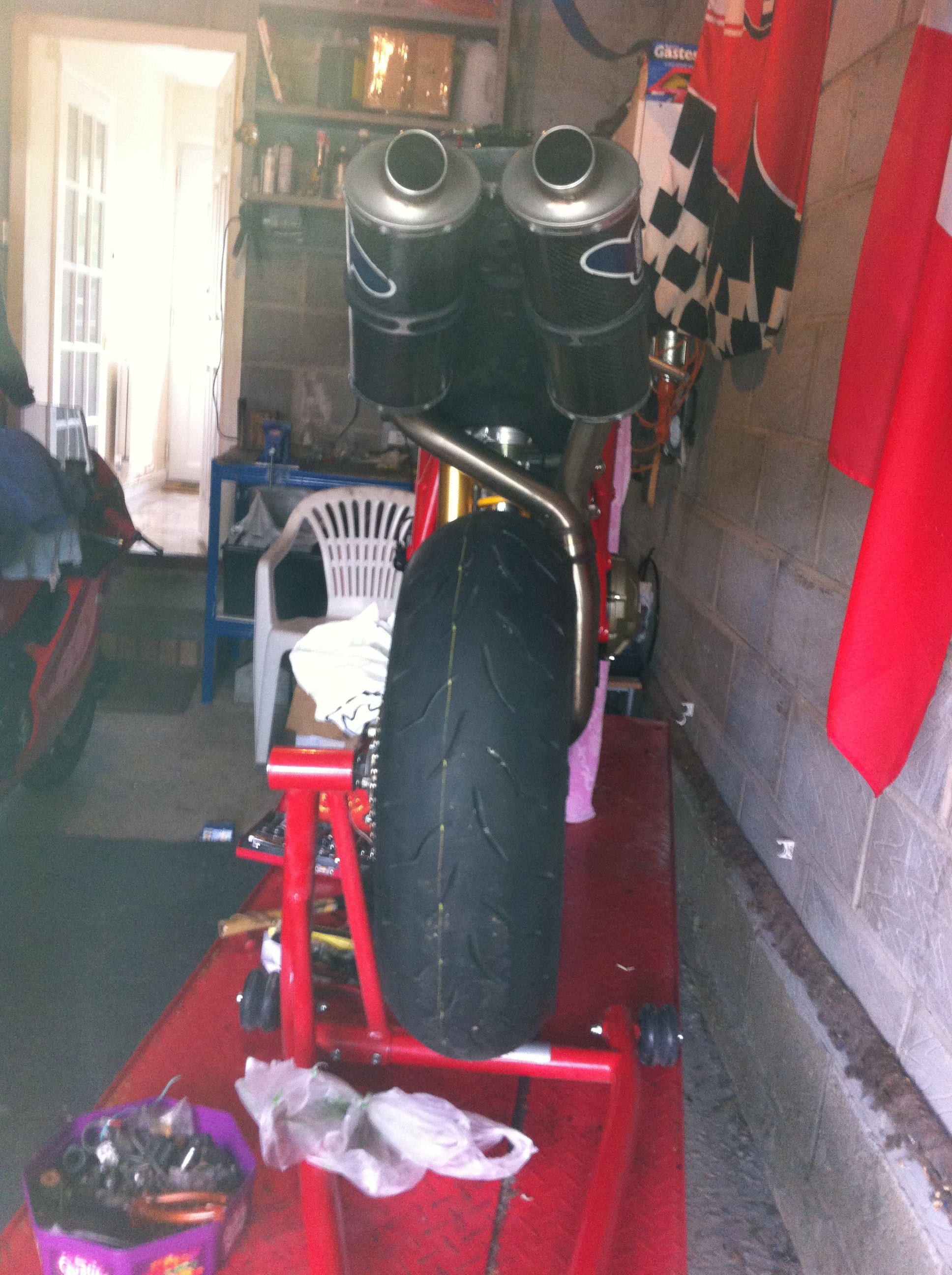

    Out of interest, why the 50mm instead of the 1198's fat ones?
  16. i
    I wanted to retain the original sweepy uppy look of the 916 rather than the wibbly wobbly look of the 1098.
    The down side is the system needs quite a lot of work to fit!
    I have welder chap coming around on Friday, hopefully he'll be able to do the bizo for me.
