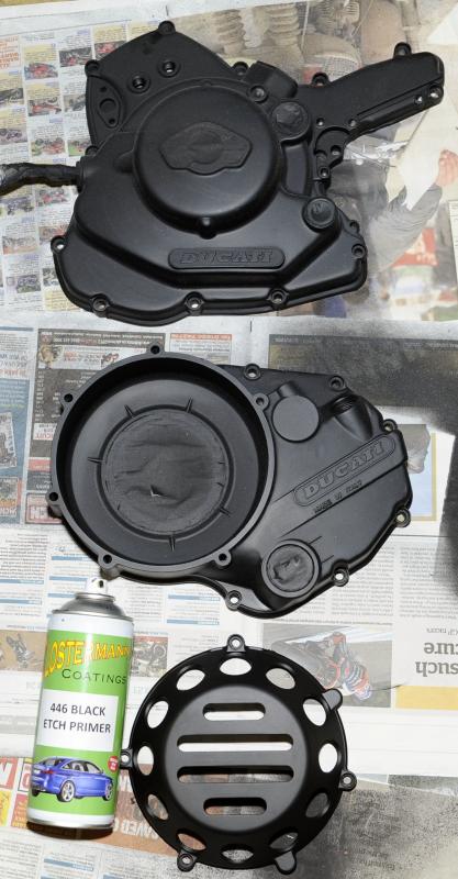

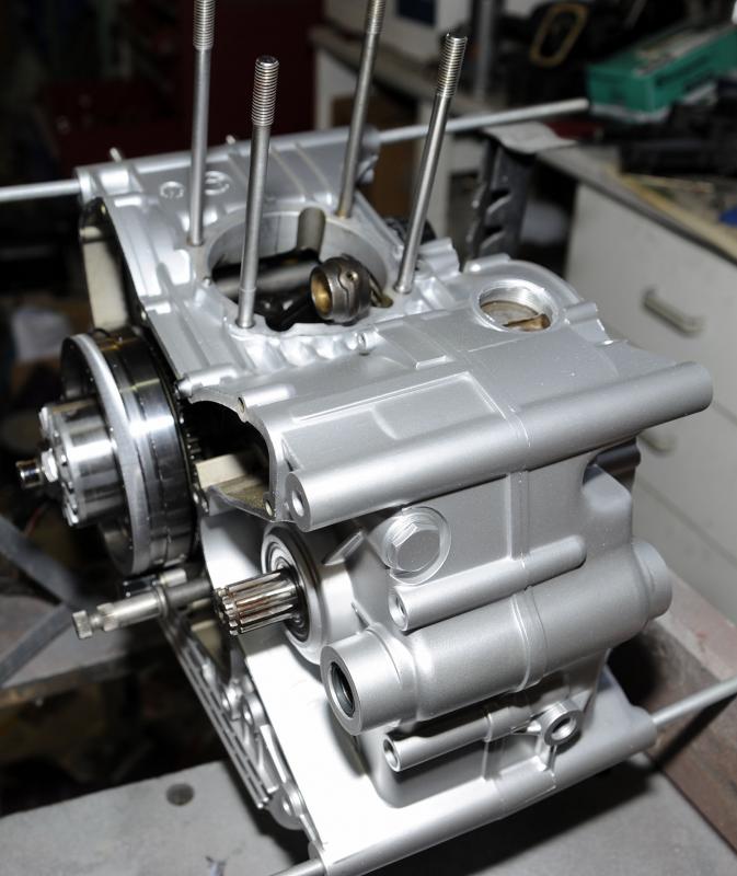

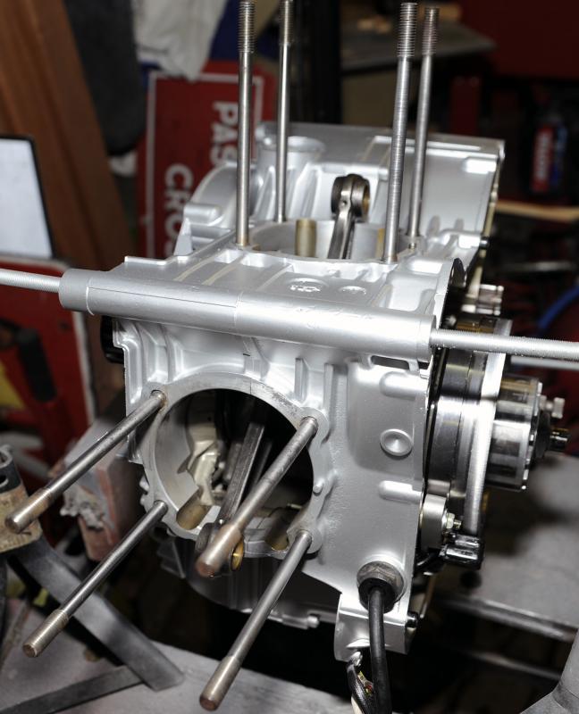

    So far I have been stripping the bike down and buying parts etc that need replacing, thought I'd sort out the engine first , oil leaks , bad paint day etc.
    Spent ages stripping the paint off using some old Nitromors I happen to have. Fiddly and messy job, make sure you wear gloves and safety glasses !
    Burnished the side cases with a 3m sateen mop and the crankcases with 3m pads and a brass rotary brush
    Then applied black etch primer to the side casings and Grey to the Engine cases .
    Finished the crankcases with Heat resistant Alluminium paint and then against my better judgement bought some Halfrauds Petrol resistant laquer , followed the instructions and patches of the casing turned yellow :mad: and some didnt bizzare , waited 48 hours then blew over the whole lot again with the ally paint.

  3. Techcote Satin Black Hight Temp arrived today :smile: painted clutch covers and alternator cover, can developed a fault pissing paint all over my hand :mad:, but not thankfully over the cases, luckily I had ordered two so carried on and got a refund on the faulty one which was nice.

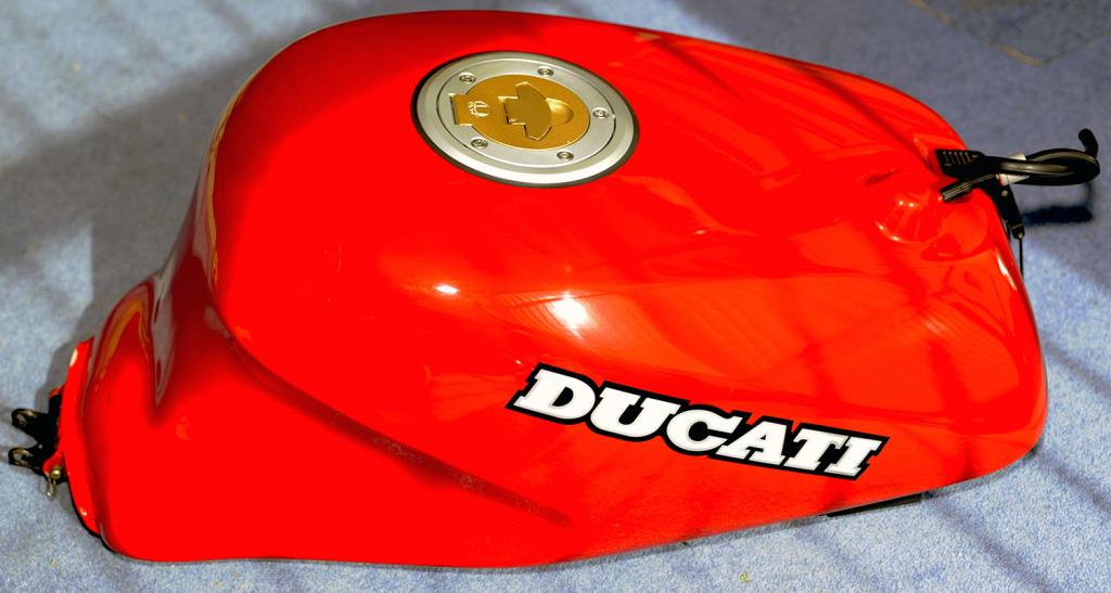

  12. Tank finished today, new fuel filter and outside sealing ring, tank filler cap and surround painted and laquered, tank polished and put in big box with plenty of Bubble wrap around it, another bit bites the dust !
    I must be honest replacing the filter was easy and putting the cap back on was easy as well using a spot of rubber grease, the outside black sealing ring was put on after inserting the main filler housing before inserting the small grub screws altogether a little fiddly but not the drama some have made it out to be, maybe i'm lucky having small hands ?

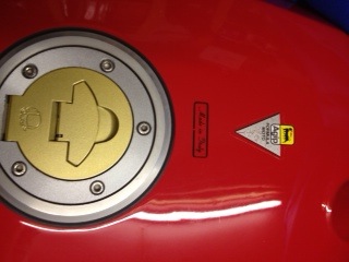

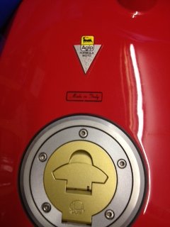

  13. looking lovely, dont know how original you want to go but mine has a "made in italy" & triangular agip decal on top of the tank
  14. Any chance of a photo of the Made In Italy and Agip stickers on top of the Tank, does anyone know where I can get them from ?
    being a total pedant :rolleyes:.. made in Italy is lacquered in Agip decal is not :tongue:
