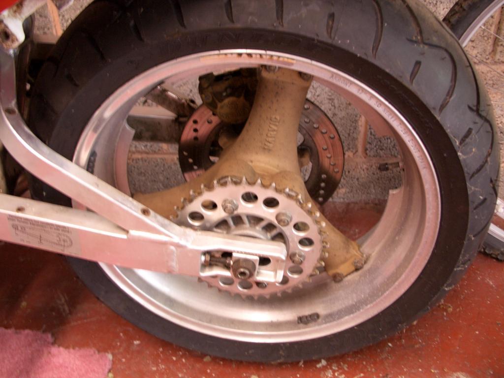

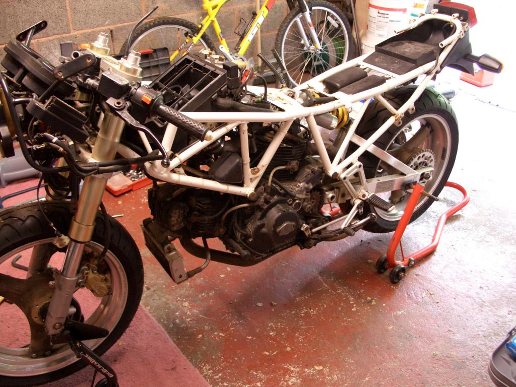

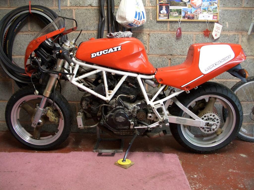

  1. I Got hold of this MK1 Superlight last year which had been sat in someones shed for most of it's life, it's pretty low mileage but in a bit of a state cosmetically. It didn't have any front discs or it's carbon front mudguard but it did have it's Marvic split rims :D. Bodywork was ok but it will need the seat unit and one of the fairing panels repainting, which I will be able to sort out myself. Under the fairing is a different matter ! The motor is in a right state as are the carbs, wiring, front and rear suspension and the frame.
    The plan is to restore it to standard and limit the modifications to simple upgrades. So no H/C pistons, gas flowing of heads, FCR's and spagetti headers here, oh no ! I'll be getting the headstock strengthened (don't want to have to go through that process again after I've rebuilt it), replacing most of the fasteners for either stainless or titanium, fitting new bearings, hoses and upgrade some of the wiring.
    I've had the wheels crack tested and refurbed by Steve Turner at TPCS, he did a top job :cool:. I replaced all the rim bolts with new titanium ones and even had some new sprocket carrier pins made up in titanium at the same time (so much for simple upgrades ! it's all your fault Pete :eek:). New bearings and valves to both and they're ready to go.
    The engines out and the top ends off, it's going to be a labour of love now getting this motor looking something like... ;)

  2. If it's not a cheeky question, what dis the wheel refurb cost you? I've got a pair of Mk1 wheels on my Imola and I must get them checked sometime. PM me if that's easier?
    Cheers ;-)
  3. PM sent
  4. Got it, cheers! I guess I'll be giving him a call as soon as I can be without them for a bit ;-)

  18. Keep the pictures coming... ;)
  19. It makes you wonder how a bike like this can get into such a state..??? I mean they weren't cheap when new and were limited edition.....
