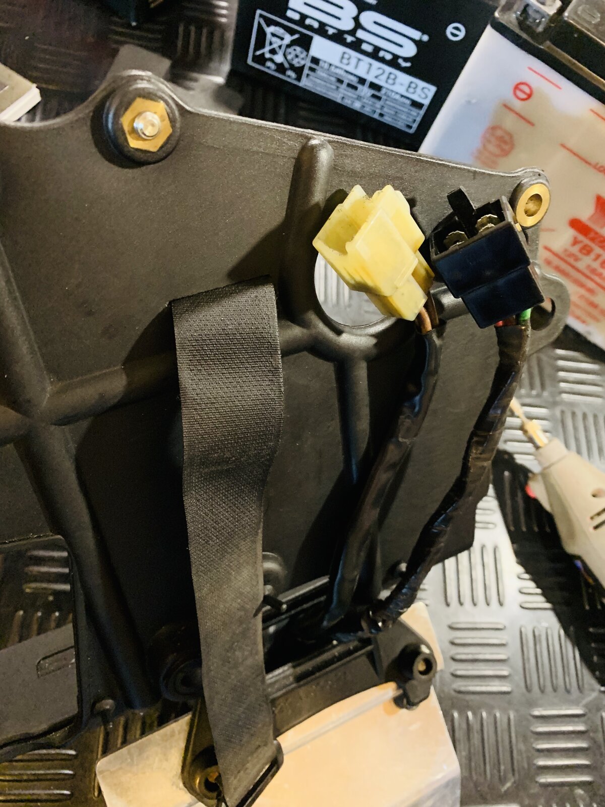

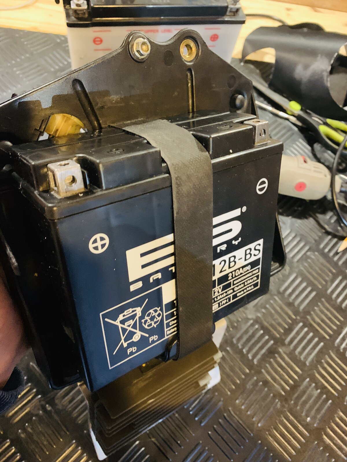

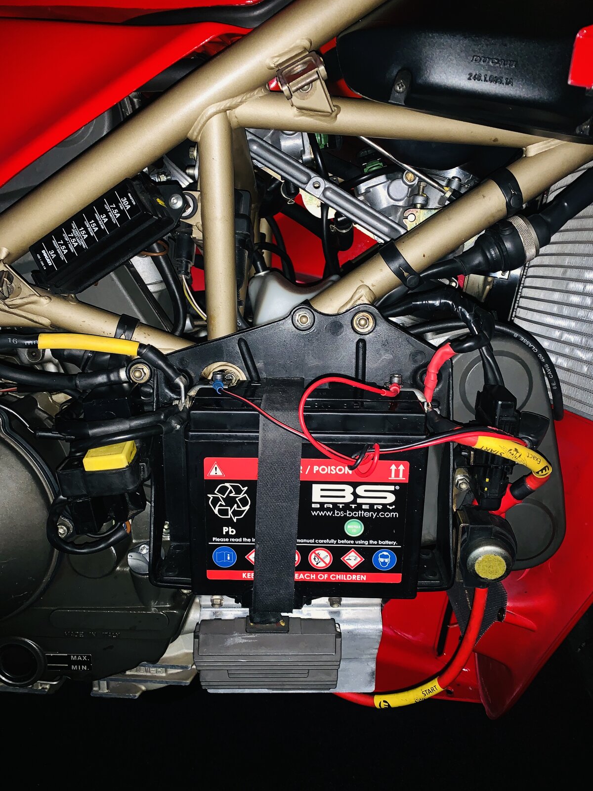

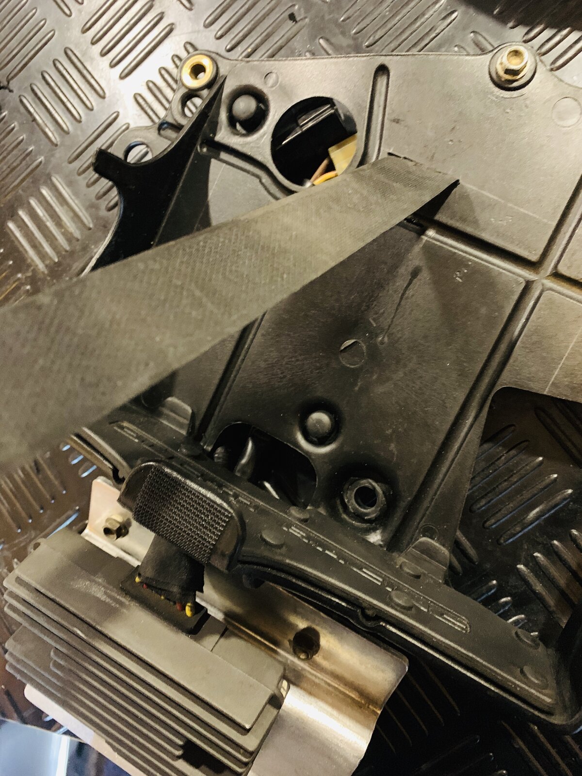

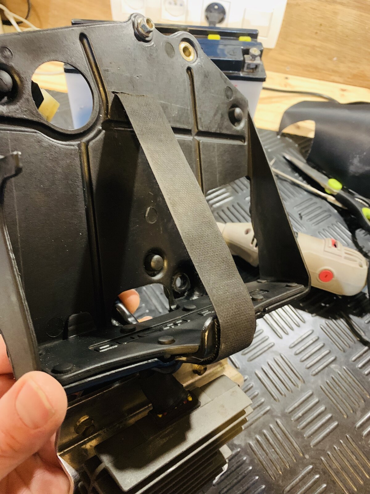

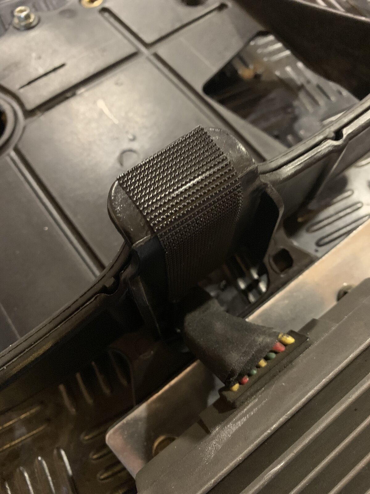

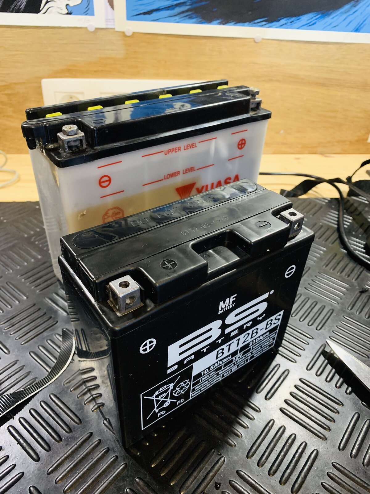

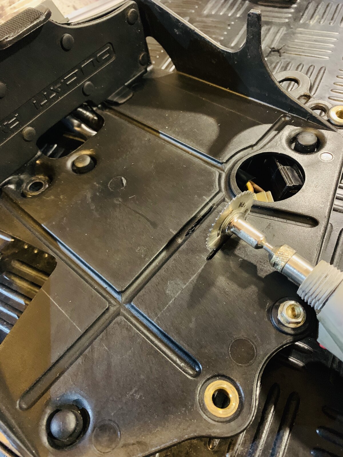

  1. Just wanted to share an easy way to modify your battery tray, designed for a Yuasa YB16AL-A2, to fit the smaller and lighter BT12B-BS. Maybe this can help.
    Materials :
    Velcro loops on textile belt
    Velcro hooks on tape
    Cheers
    112ADAAD-4A63-40C3-877B-087FE7FB6FB0.jpeg 28371616-CFC4-4DB2-966A-5BE1463EADED.jpeg C0F777AB-5B92-4344-8A97-40E1790053EF.jpeg 98B5EC0C-FB7A-4671-84F0-D26CFB89D65E.jpeg 02450647-EB03-4950-9660-F9DC50756CE8.jpeg 1073B15C-F016-4A63-B095-94AD7E5D92F4.jpeg EDCD98C7-3E11-4929-9965-BA3879895910.jpeg
  2. Sam did you now there is a different battery box base tray available which makes it suitable for the later YT12B-BS (smaller) agm battery? Part number is 829.1.270.1A and they cost around a tenner. It just clips in and replaces the support tray of the battery box but uses a different battery retaining clip part number 827.1.195.1A (also less than a tenner) Can be removed should you want to revert to the bigger battery for any reason
  3. Top tip !
  4. I like the Velcro strap bit. I could use that for mine. Better then the cable tie jobby. :upyeah:
  5. The +\~ are the other way so I had to turn the battery 180* but it worked out well.
