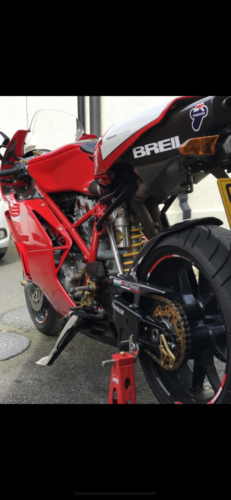

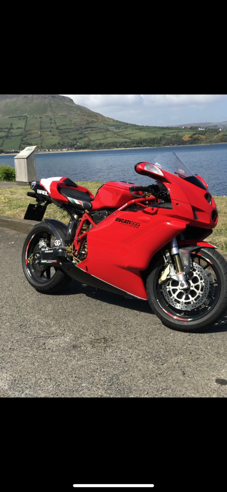

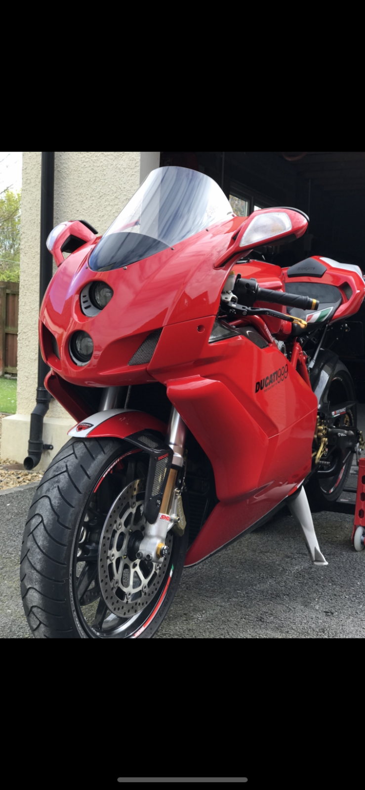

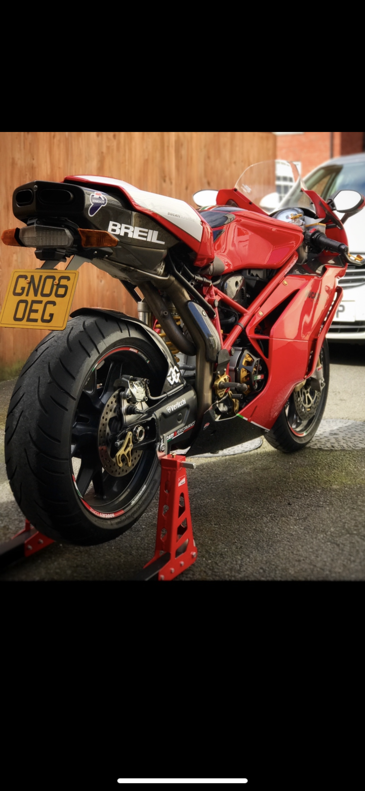

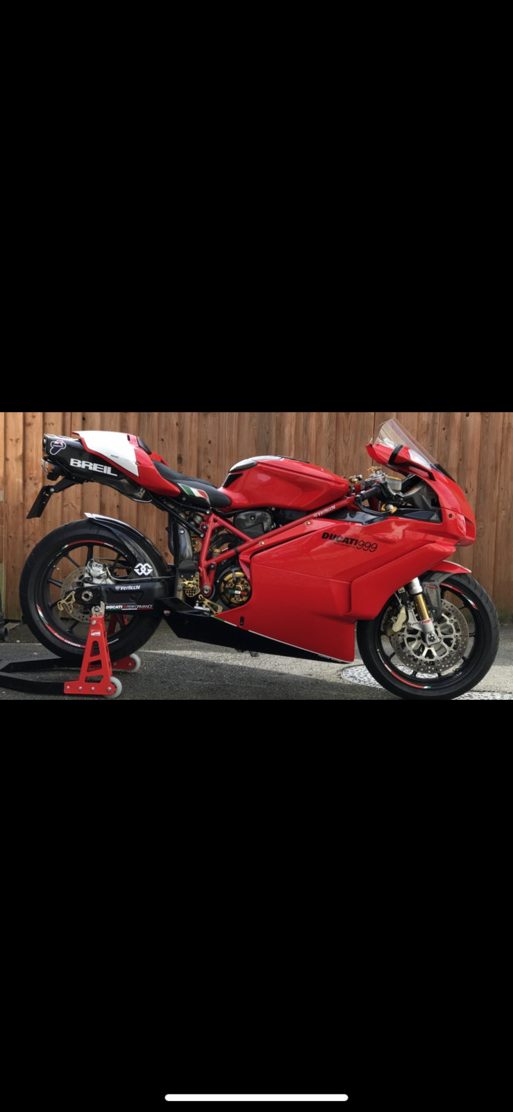

  5. Well what does the bike look like? Show us some pics.
    A small detail differentiating the biposto and monoposto are the Dzus fasteners on the side fairings. Originally a monoposto has D ring ones and biposto has Allen head ones.
    The rear spring rates are different as well but I don't know what they are exactly.
  6. 5E9BBF58-CD62-4E81-8BD7-96D457534279.png 9C05FB46-776B-4CBF-BB17-F52B62EB47EC.png 51E24591-076A-4EE7-B429-CD2F27138AC4.png D29CFCE3-FA33-4F08-B6BA-3CDDF94B6E49.png
  7. It has the 3 position adjuster for the tank/seat. The biposto does not have that.
  8. If it’s same as 749 mono it will have adjustable head angle too
