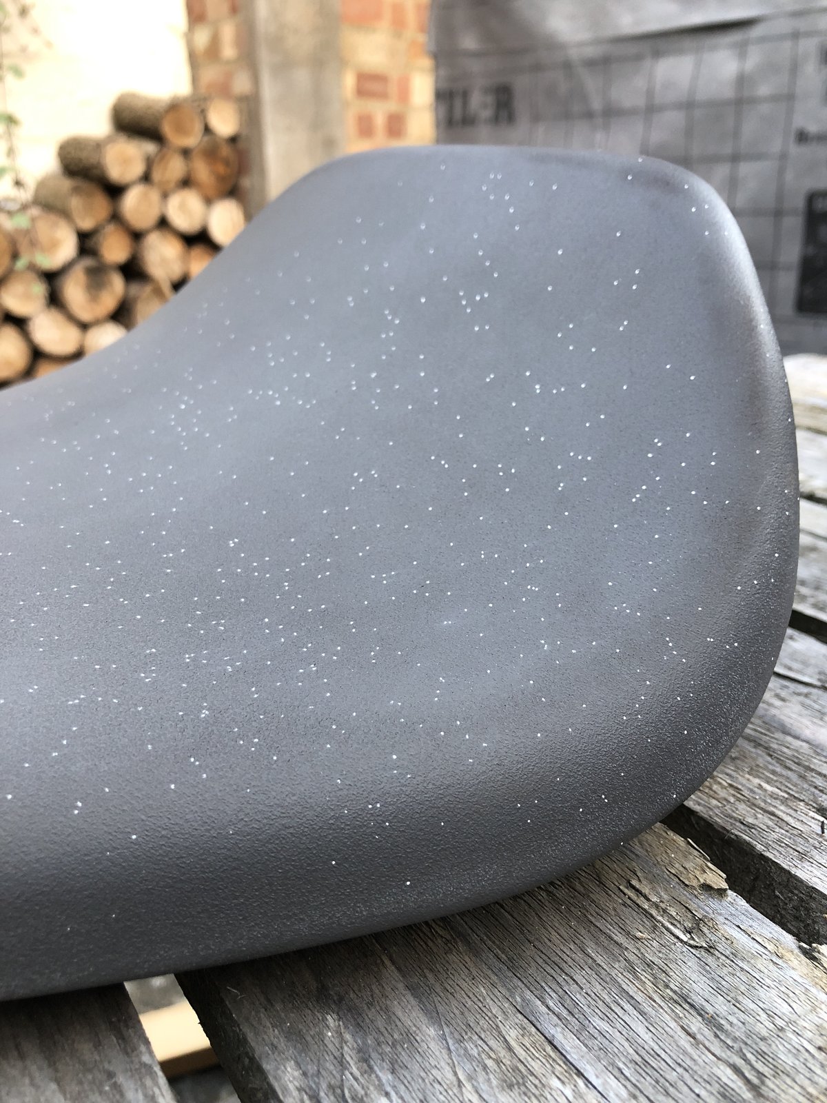

  8. So after a little help from a friend the seat has been recovered, many thanks to the advice recieved after the intial post, after stripping the original vinal we stapled the alcantara at the rear of the seat then sprayed the contact adhesive onto both parts before swearing and trying to pull and staple the new fabric onto the seat. Very happy with the results although am yet to actually test the seat thanks the to the weather today. Once fitted to the new seat unit it was sprayed with a water resistant liquid in the vauge help of trying to keep my arse dry on those inevitable wet day’s. Not the biggest project going but appreciate the help in trying to sorce a monoposto tail unit/seat for the bip. Cheers boys 6B16A153-9A62-4A8A-AEF4-73F57AC82394.jpeg 8AC139F6-04DB-4E39-A9A6-37AB5ECE364F.jpeg 63DD45EC-B45A-4AD7-B8D2-A7278F05D179.jpeg

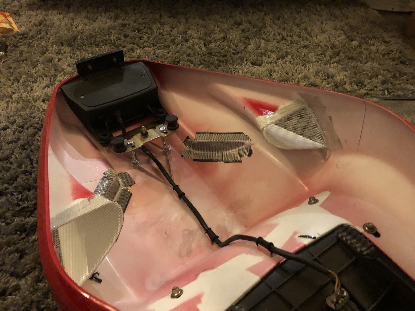

  10. Looking good. On a related matter, did you change the subframe to convert to mono or did you manage to get the mono tail unit to attach to the BIP subframe? Thanks.
  11. Paul, I actually cheated and used the existing subframe. It took some trial and error to mount the original bracket to the the new seat, i had to flatten out the kinked bracket every so slightly then find a way of attaching the raised part to the seat. It looks quite crude but gives some some adjustment on the seat height. Twas a case of adding/taking away washers plus taking the seat off numerous time which became very tedious very quickly. We’re about there with it now so will be making something a little more robust. B1449B7E-000B-4898-AACC-A19600DDB1E5.jpeg 7F1893F6-53F0-4305-920F-ED4EE36C7907.jpeg
  12. That's a brilliant help, thanks Lee.:upyeah:
