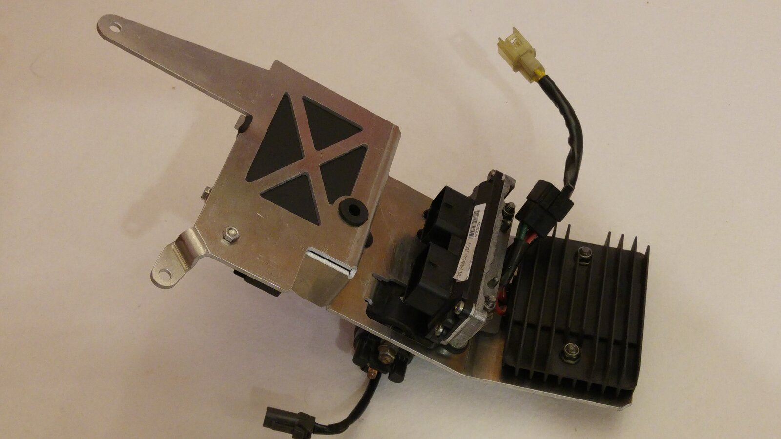

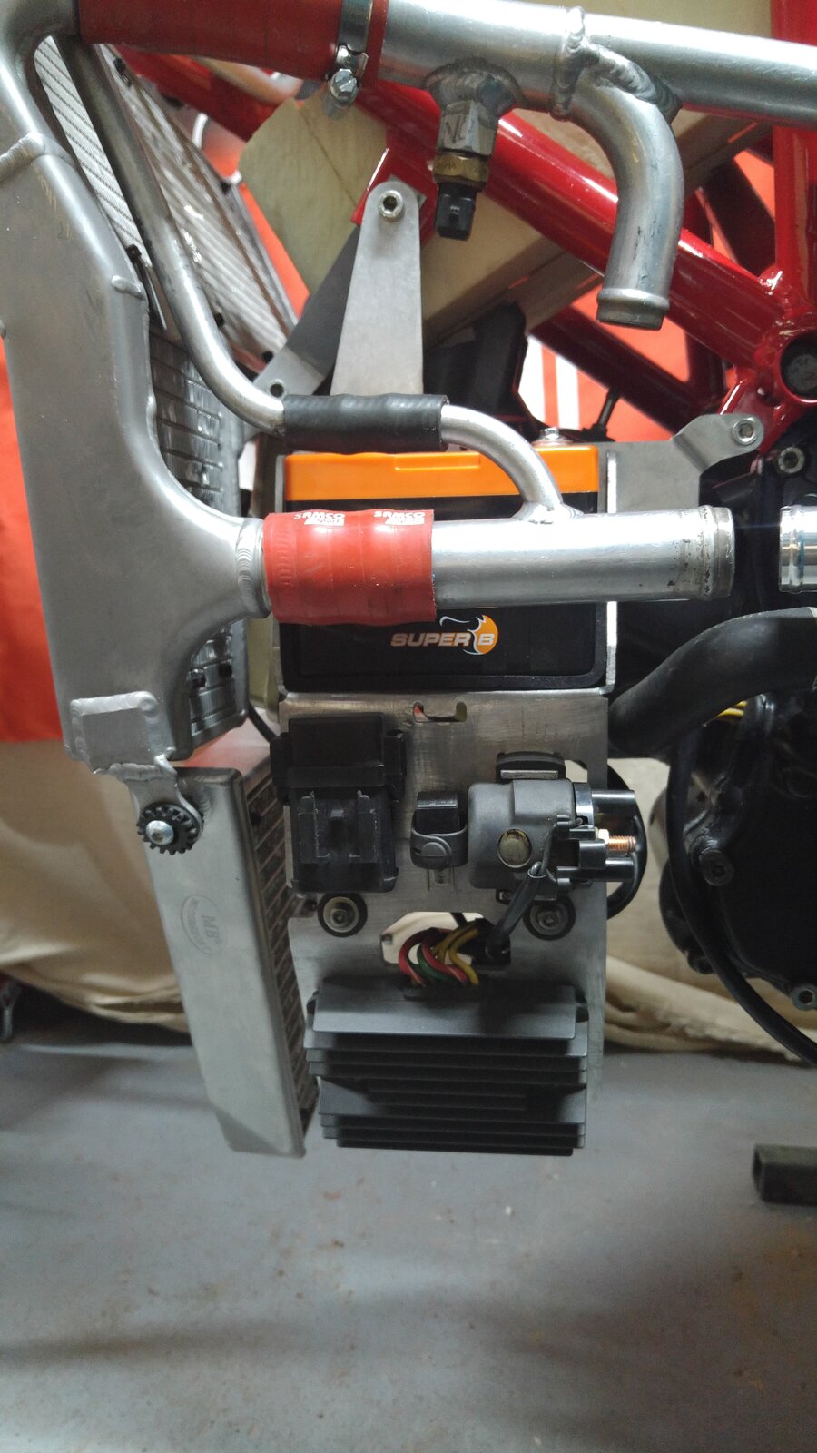

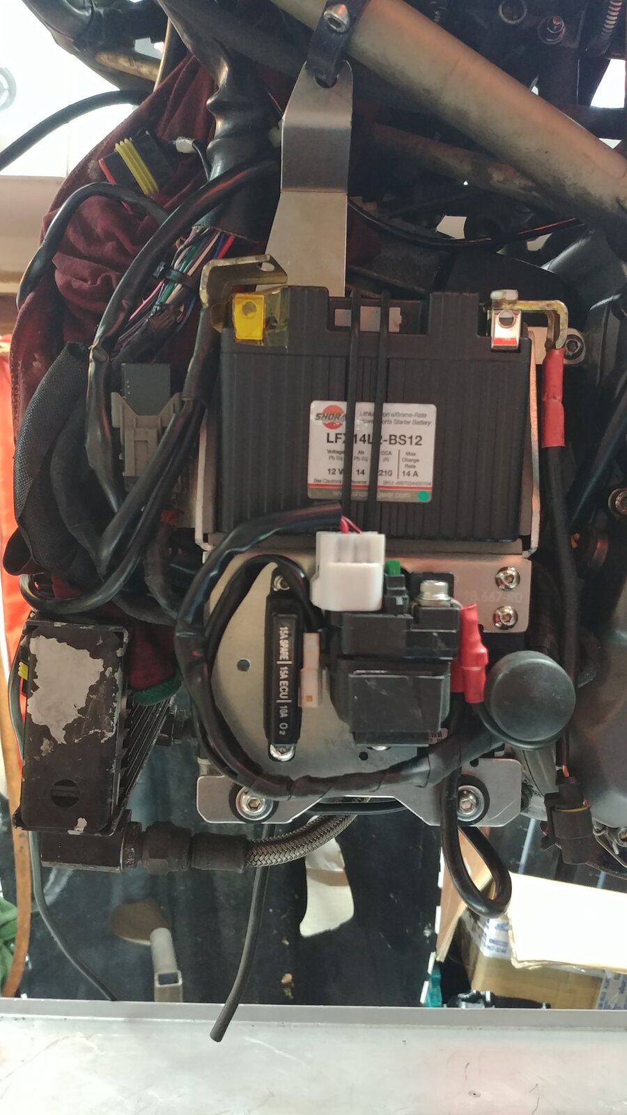

  4. I'm really liking the battery tray. Did you make that your self or is it something after market? ... I want one :)
  5. Yes, it's a product we make for the 749/999 series. We used one to adapt to 900ss as we had to relocate the battery due to larger airbox. Here is a better picture:
  6. Please tell us more about your 749/999 battery tray. Maybe put it on the 999 page so as not to hijack this thread but every 749/999 owner hates the oem battery box with a passion - easily the worst thing about the bike...
  7. @final_edition beat me to it. Here is a picture of the race version installed. The road version is identical save for the fuses relocated to make for road cooling hoses. 20170418_205747.jpg

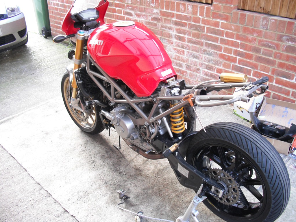

  9. So, back on topic. Before getting into where the project is now, it might be interesting to look back to before I started this project. Warning: lengthy post ahead!

  14. Even better...
    I got my race bike down to about 160kg, and with 150hp and 95lb torque for tracks... :upyeah:
    I know an SS can be down to 150kg, although lots a bit shit ;) but that with 105hp and 80lb ft would be a hoot
