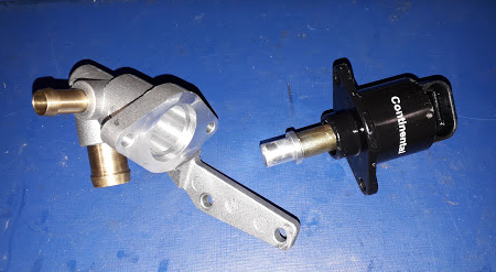

  16. Evo stepper type as piccie below.
    Sourced a used stepper, fitted it & tested briefly with bike up on Skylift & seemed ok, in other words started straight away & revs around 1800 (cold engine), blipped throttle the revs seemed to settle to a normal cold idle speed, at this point I thought sorted...
    Refitted front wheel, mudguard, oil cooler, horn, reg/rect , oil cooler shroud.
    Started the bike, revs hung around 2000 then dropped to 1250 after a minute, as soon as throttle is touched then revs hag at 2000. GRRRRRRRRRRRRRR
    I have allreadty tried a different TPS, next I will swap stepper from my hyper evo, then I'll swap the pressure sensor.
    Failing that I'll have to go to a dealer to get plugged in.
