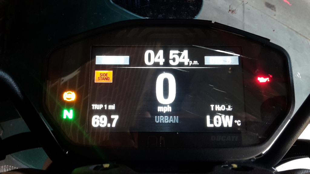

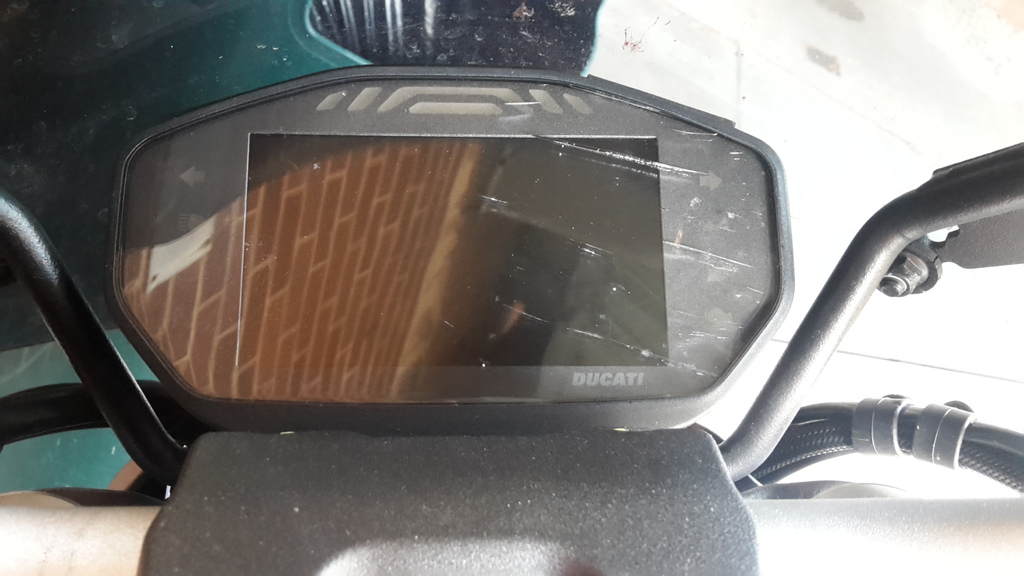

Went to work at 07.00 and all was fine with the bike. Came back when i finished at 23.00 and there was cracks on the dash of the bike. Anyone seen this before on a monster? In the time i've had it nothing has hit the screen. The bike is parked out the way at work where nobody would bugger about with it. I couldn't see anything laying around the bike that could have fell and hit the screen!
Not specifically monster related but seems to another model to suffer the same type of failure... See thread linked below http://ducatiforum.co.uk/threads/another-cracked-speedo-display.51157/page-5#post-915103
Update on this. Had the bike down for a service at Ducati Preston. They noticed the screen when servicing the bike. Its meant to be a sealed for life unit and if moisture gets into it the screen goes iridescent and cracks. They are going to change it as a good will gesture!
When I went to pick the bike up it caught me of guard when Russ said they would sort it. The bikes out of warranty so didn't expect it.
That's a good result and also interesting. I just had a replacement screen on my 2016 model, due to condensation in it, dealt with under warranty. I guess that's potentially what would have happened to mine given time.
