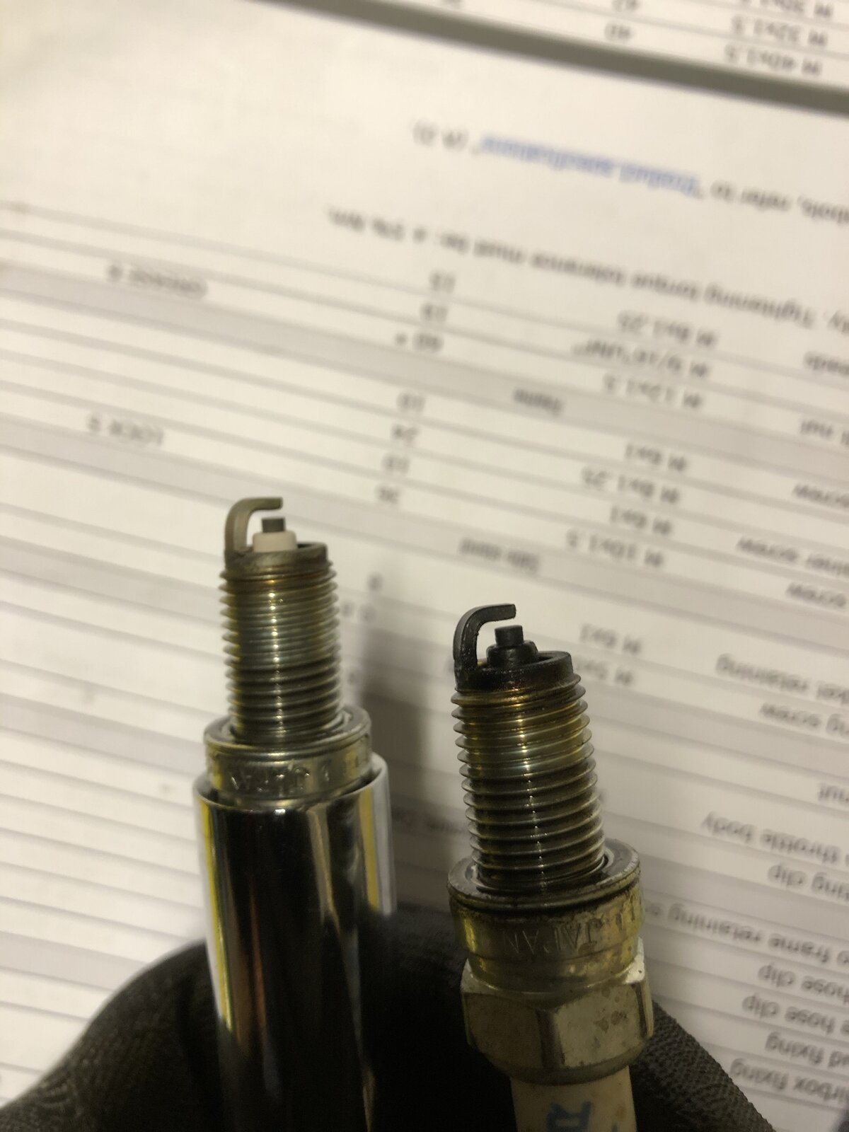

    Secondly a few days before all this, I pulled the plugs for inspection and noted that the vert looked good and the horiz looked a bit black. After last nights ride I pulled them again and it looks somewhat blacker. Not noticeably wet, more of a satin finish and doesn’t wipe off. Pic attached for context. Does the other one look lean?

  7. Thanks, appreciate your help. My hope is that won’t be the case (obviously) and that’s based on my belief that the plug is black due to fuel fouling and not oil. It’s hard to tell but everywhere I look describes oil fouling as leaving wet deposits and these are dry, slightly glossy black. I.e. it doesn’t wipe off. Ive swapped three plugs and will see if the other one turns black as a confirmation that it’s that cylinder. I suspect that the vertical cylinder is running quite lean because it feels noticeably hotter and the plug is whiting a bit. As the o2 sensor is downstream from the horizontal, if it’s excess fuel it would make sense that the ECU was trying to combat it by leaning things right? So maybe the vertical cylinder is responding to its instructions and the horizontal one isn’t. I did notice that after my brief ride today that the plug hadn’t darkened since last night so who knows. Sorry for the info dump but I figure if someone can help the more info the better.

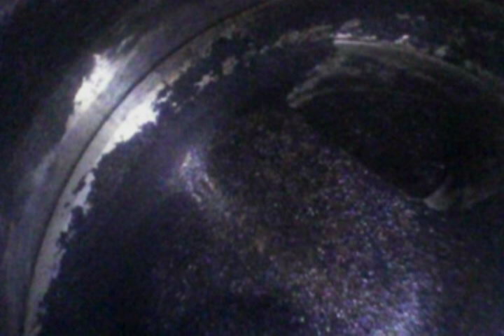

  12. Thanks for the reply, could I get an opinion on this too? This is the horizontal piston face with the intake valve recess at the top. I’m a complete novice but this looks to me like the valve has ‘cleaned’ the piston face during contact?? (Top right) B2491BD2-A1DD-4F0E-9600-B92CF854A426.jpeg
  13. If I were you I’d throw the inspection camera away, it’ll worry you to death! :), i see what you mean in the photo but can’t imagine your getting contact, ditch the camera :)

    oil tends to make the plug wet.... unburnt fuel is black...does look a little wet..
