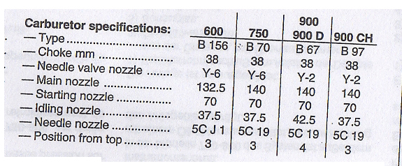

  6. Carbs basically the same; jetting is different. Here are 1997 SS jets etc.
  7. Had a look over lunch.
    Some subtle differences according to the part numbers:
    900SS 94-97 M900 93 M900 94 M900 98
    Main 140/145 Main 140/145 Main 140/145 Main 142.5
    Starting 70 Starting 70 Starting 70 Starting 70
    Idle 37.5/42.5 Idle 40 Idle 40 Idle 37.5/35
    Needle 5C19 Needle 5C19 Needle 5C19 Needle Monster 900
    Interestingly the early Monster and SS share a needle at first, but the later Monster has a different Ducati part number that is no longer Mikuni branded and doesn't give a clue to the spec, but does even have monster 900 in it's description.
    I'd suggest the jet changes are more of a development thing, and maybe to cure a lumpy idle with the smaller valve heads, but the needle change could be significant if the shape changed.
    The changes to the valve sizes were slightly different to what I thought.
    The later Monster had a smaller intake but larger Exhaust, probably to move the torque/power curve and restrict peak power.
    900SS 94-97 M900 93/94 M900 98
    E 38 E 38 E 41
    I 43 I 43 I 35
    I do know the valve size took place before 1997, so the part numbers are a bit out of time.
    Nasher.
