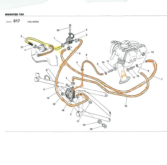

  14. Just for info here's the diagram I used for fault finding the fuel system. MONSTER - Fuel System Layout.jpg
