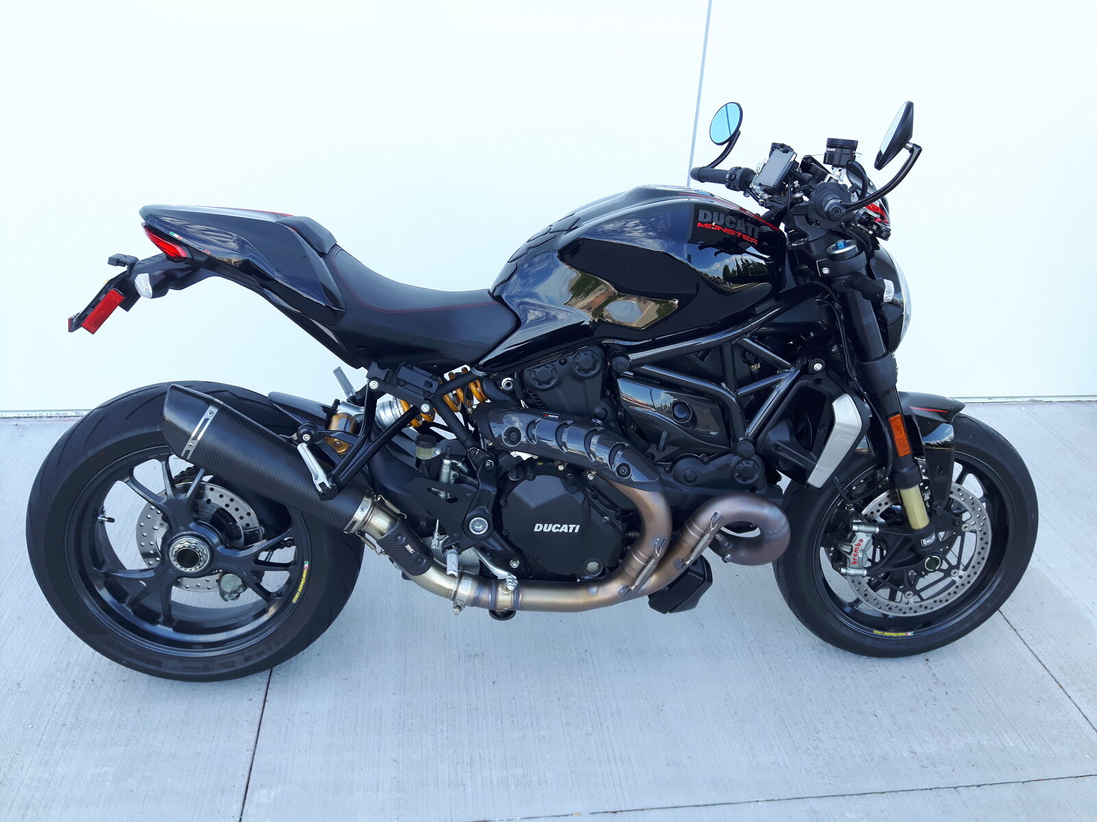

  1. Just had a "for charity" Dyno Run on both bikes. Half the proceeds went to the Diabetes Foundation. Great Idea. Lots of fun.
    Awesome turnout. Guys were betting on closest dyno estimates vs results. Totally hilarious.
    Here's my result for the Monster 1200R: 140.11 HP.
    SC-Project Carbon Exhaust, Rexxer ECU Flash, Stock Air Filter.
    No torque figures and the chart lacks details, but it's for charity!

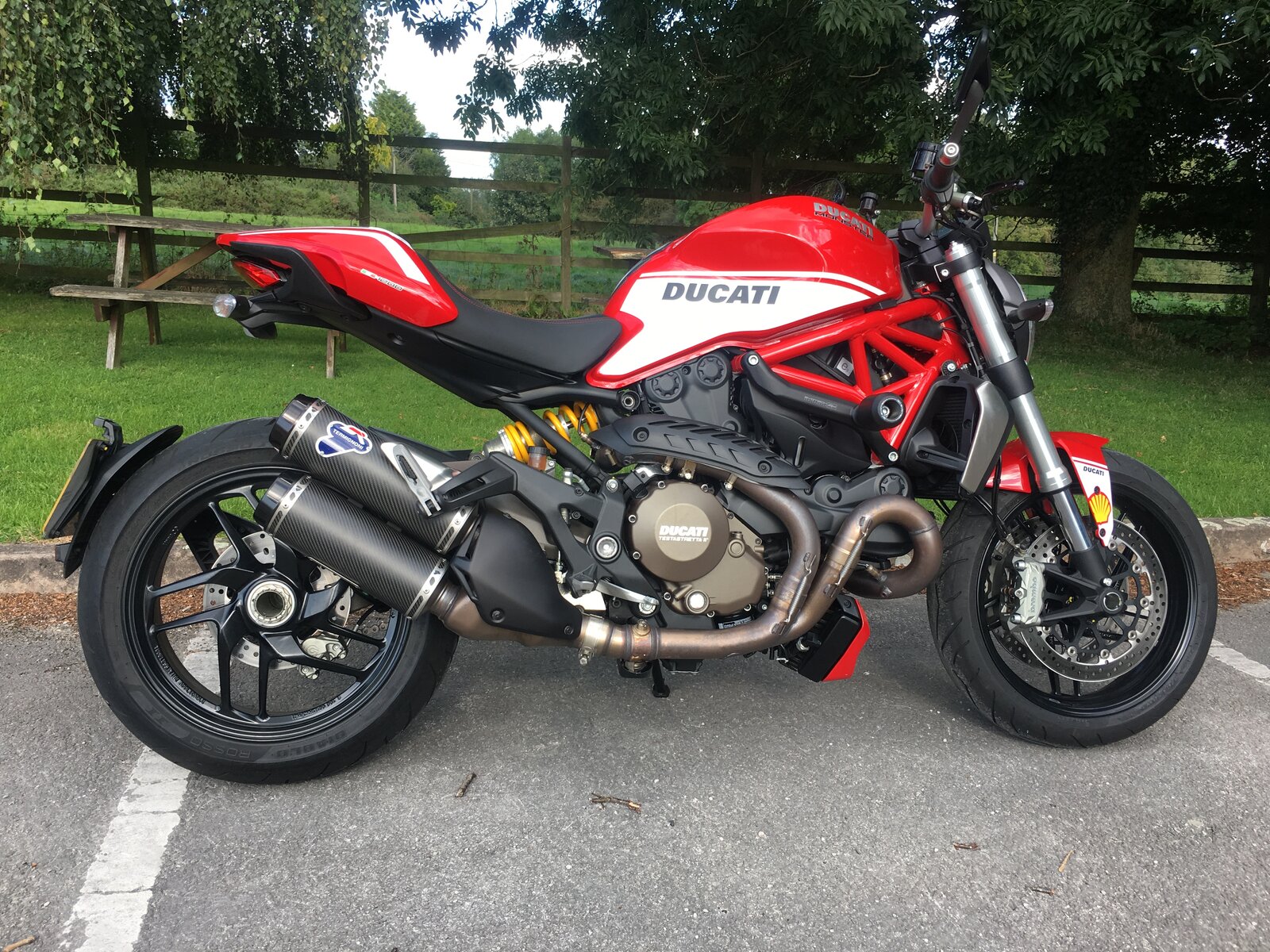

  7. 9A0FC4A5-DE38-4AAB-B13A-9EEB6DDCC946.jpeg This is mine 2016 with Termigonis, the bhp is kind of irrelevant to me personally, all I know is it’s too bloody powerful for my meagre skills, damn good fun though:)

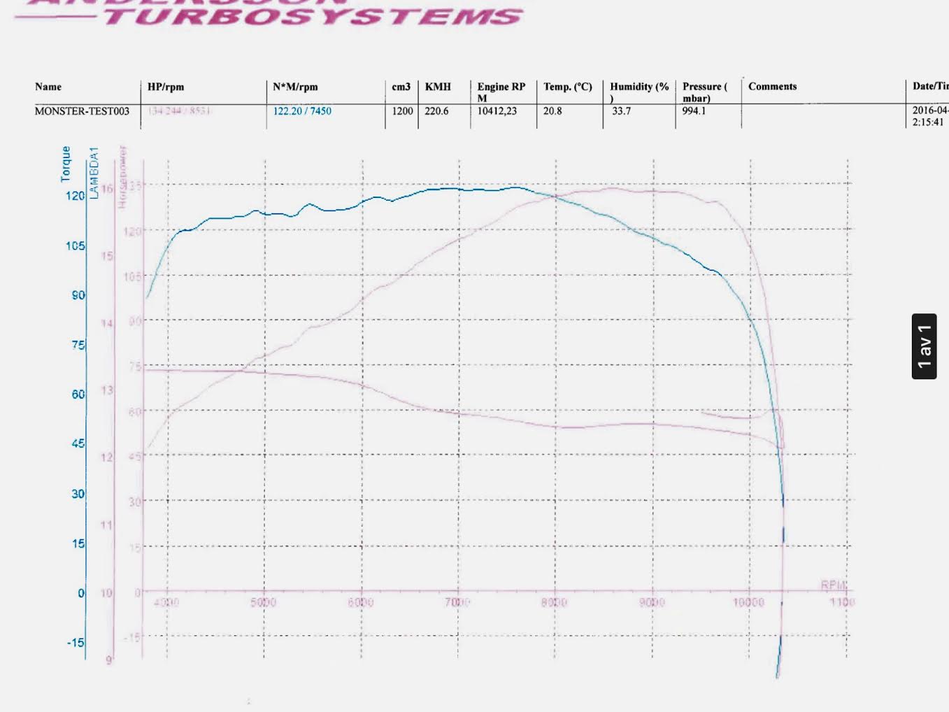

  8. Monster 1200s-15 with Termignoni and upmap. Dyno chart courtesy of Halvdampis.
    134.24 RWHP
    122.20 NM Torque (90.13 ft-lb) :astonished:
    #8 DarR, Oct 4, 2019
  9. Normally AF is below the chart. Took a few mins to understand it
